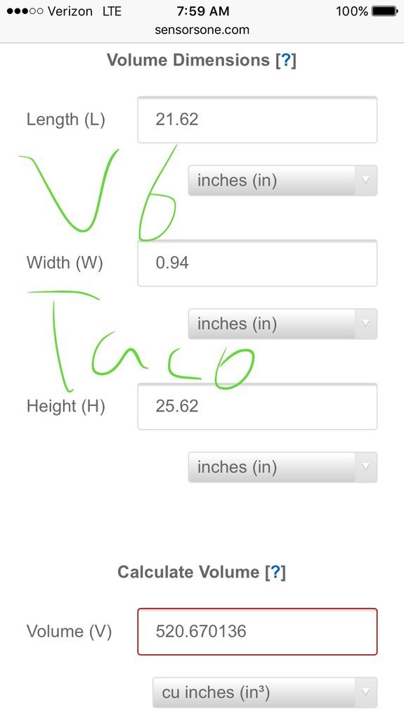

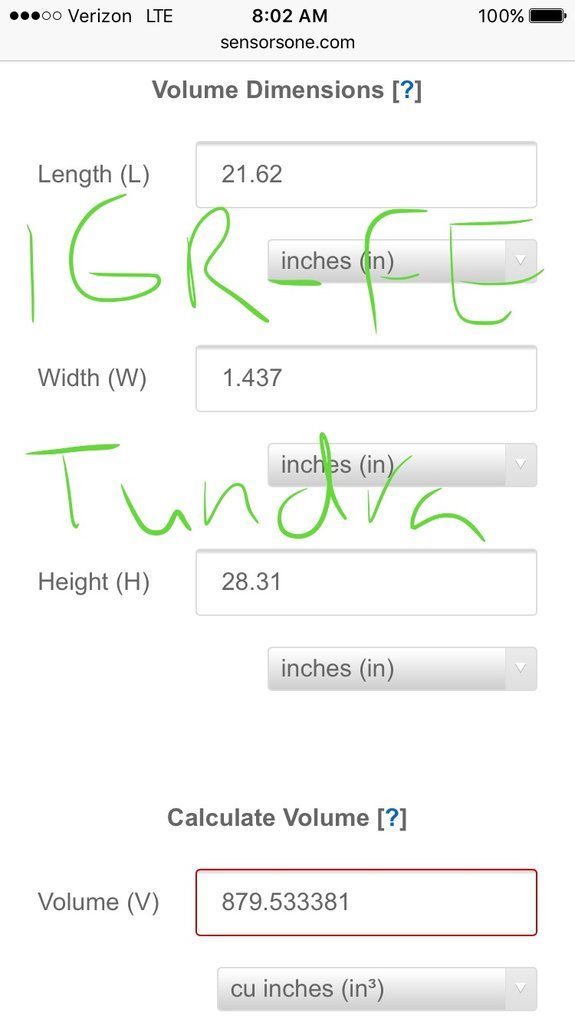

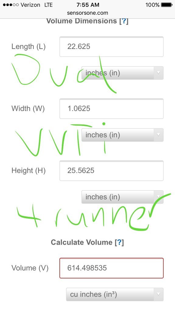

    So I was doing some searching online trying to find the specs of the stock radiator. This is mostly just out of curiousity but I might have to try one of these out. So anyway, searching for oe replacements on ebay for our trucks, the dual vvti 4runner, and the 1gr tundra, these are my findings. Not sure if the math is correct or not the numbers could be complete bullshiz, but it's all I got so far. Anyway I will attach the pics here:
    So roughly the numbers are:
    Tacoma 521
    4runner 615
    Tundra 880
    Now I know they probably would not fit but does any one think there might be a chance? Not sure if it would really make a difference, maybe an eletric fan setup would be better off. From what ai have read about eletric fans it seems people either love theirs or have nothing but problems with them.

    Electric fans can cause problems if not properly setup, but work wonders when setup correctly. Many people believe what came with the truck stock is the best way to go, personally I think you can get an electric fan setup that's better than the stock fan. If running an electric fan, it should be easy to make the tundra radiator work for you. I would just look at your buddies and compare how it mounts with the way your current one mounts, that should give you an idea of the work needed to make it fit.
    I was having an issue with my 97' 4runner that was kind of the opposite of what you're going through that ended up being the radiator. When driving at speed for a while in hot ambient temps it would heat up, even climb into the 240 range. When idled it would come back down to normal temps. This ended up being a bad radiator, it couldn't cool as needed with the additional load. As soon as I swapped a new radiator from rock auto in the temp stays below 195 daily. It's been about 2 months and I haven't seen it get over 195 once.

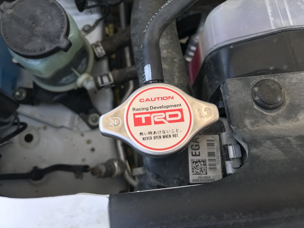

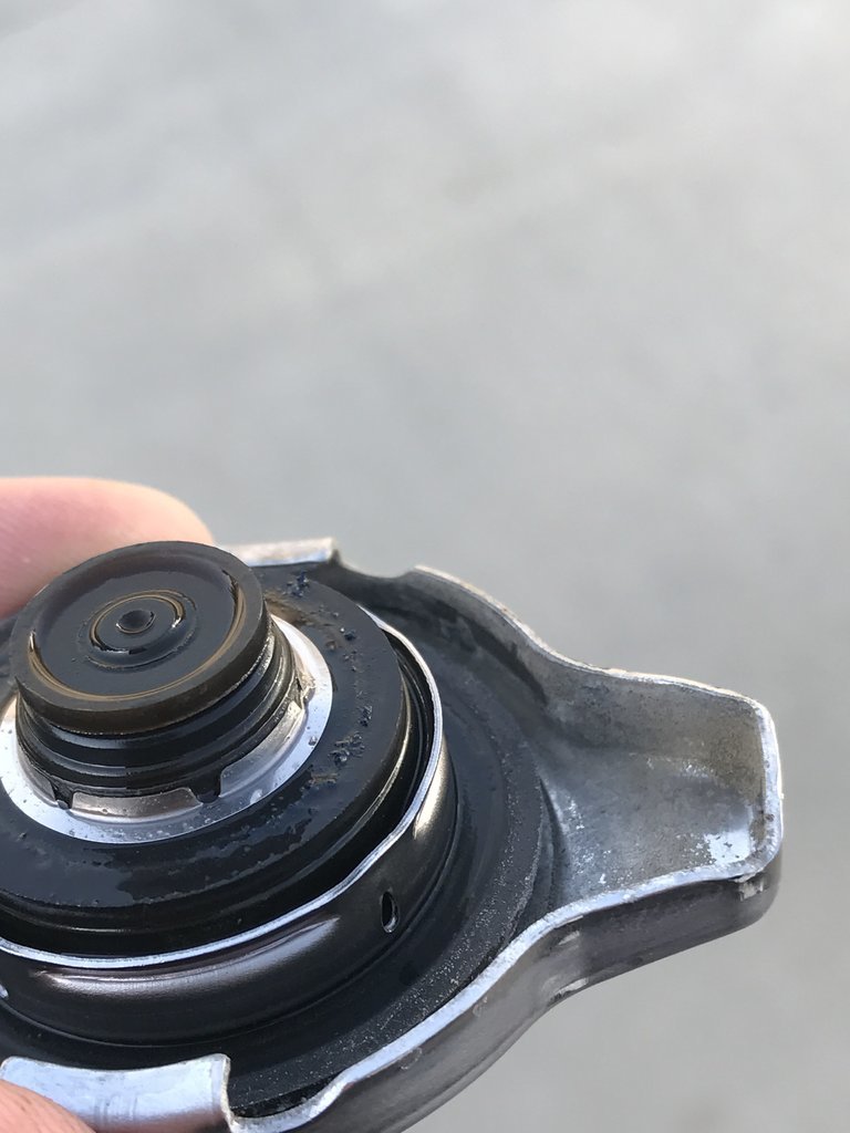

    He didn't go into details, and I had to go because I was at work but I might call him back and ask. He recommended me finding a heavy duty/towing fan clutch instead. I've done some searching and can only find oem replacements. I am really considering doing the tundra rad with an electric fan. Tundra rad holds just a tiny bit more coolant than ours even though it seems to be much larger.
    As far as the cap situation, I finally got mine. Also I was comparing my truck to my dad's truck. He has no dried up coolant near his cap like my truck does, really makes me wonder if this stupid cap is going to make a difference.
    I know everyone's seen them but why not post some pictures of it while I wait for my truck to cool off.

    New cap installed. The old cap had this weird blue build up on it. Anyone have a clue what it might be from?

    Correct. Think of it more like it isn't hold the pressure it was designed to. Or like swapping on a cap that hold a lot less pressure than your current one. The coolant will reach a boiling point at a much lower temp, and escape out through the cap.
    That was actually a major problem on a recent Ford diesel engine. Recall after recall for engine problems. All related to needing a cap with a higher pressure.

    if it's a cap prob. you'll see a full recovery bottle when it's getting hot.
    plugged rad. for sure sign is getting hot on hwy. then cooling at idle.
    it's never a bad idea to make sure you have no gases in radiator before buying parts.
