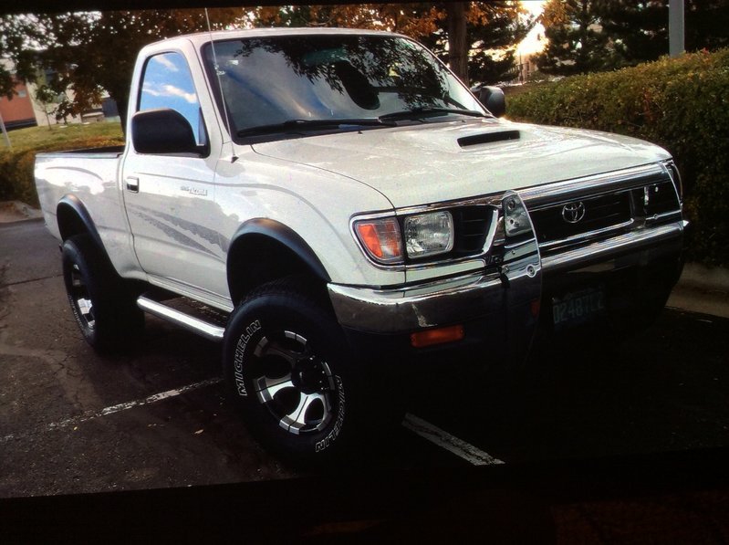

    1997tacomav6
    1997tacomav6 V6 5sp,RegCab,TVS1320 Supercharger,Haltech, 800k
    Oct 5, 2013
    #113940
    10,398
    John
    Denver
    97 reg cab, v6 5sp 300hp supercharged, Methonal Injection, 800,001 plus miles, Original Owner
    V6 5sp,RegCab,TVS1320 Supercharger, 56mm pulley, methanol injected Haltech ECU, AC Tvs1320 supercharger,(MUST DO) every 125,000- 150,000 needs rebuild Projector headlights HID 5 speed manual Amsoil for all drive train Smaller 56mm custom pulley, (MUST DO) 2004 DESNO fuel injectors, zero ping ping, 2004 side door mirrors Dick Cepek Rims, Michelin tires LTX, ATM Pathfinders Dynopro ATM ( that last 100,000 miles) Now running Dynopro ATM mud and snow tires KN cold air intake Cat back dual exhaust with ss exhaust tip, Raised exhaust tail pipe to 2" below body line Optima*dry cell battery,red top Alpine sirius radio, 200 watt amp, focal is165 split door pod speakers Focal door speakers Subwoffer behind seat Viper alarm, Electric Locks Dark tinted windows, bucket seats corbeau lg1 Tacoma Rubber floor mats TRD fender extenders, Bilstien shocks, King shocks JBA UCA trailer iv hitch, electric brake control, Drilled slotted brakes, High carbon steel (MUST DO) EBS green stuff 7000 series pads(MUST DO) TRD engine oil cap TRD stick shift, Marlin crawl shift kit. Rear sliding window 2002 4Runner functional hood scoop cut into Tacoma hood, 4Runner dual overhead map light Gentex Auto dim + Compass + Temp, garage,rearview mirror Snow Methonal kit stage 2 Custom 3 core aluminum radiator Linex bed liner Haltech stand alone ECU, Intake supercharger gauge. Stainless steel brake lines, Custom leather wrapped steering wheel, Haltech stand-alone ECU,
    Definitely a fun truck to have, very nibble and easy to get down those small trails and even more fun after passing up a 2017, 35,000.00 dollar pro tacoma truck at 11,000 feet over vail pass with easy over the weekend as it struggled to try and keep pace. (I know he was saying to himself, WTF).
    The 3.4 when supercharged and 2.1 pulley matched with a 5speed is a tough compo to beat even with today's standards even though its a 20 year old setup. The sc 3.4 puts out more hp (300hp) than the new pro Tacoma trucks (265hp)and the 1st gen Tacoma weight Is a lot less.(1000 pounds less)
    It's too bad TRD dropped the supercharger and has no plans for making a supercharger for the new Tacoma trucks,
    If you need any advice or help I've been there and done it with this swap and rebuild process
    Supercharging is the the way to go with these 3.4 motors and. 5 speed if possible,
    will feel like a completely different truck
    Bought her new in 97,not too many if these left out there so I take extra good care
    of her let alone 508,000 miles on the odometer.
