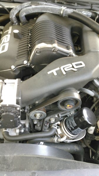

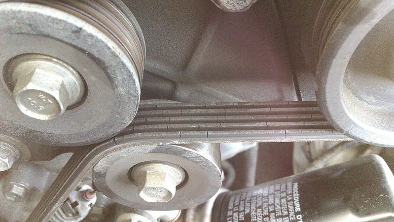

    It shouldn't be a difficult job. When swapping my pulley I had a second person pull the belt off the top pulley when I relieved the tension on the belt using the same wrench method on the tensioner. From there it is going to be more about routing the belt in confined space, might be a little bit of a pain but not technically hard. If the dealer is quoting you $120 (pre-coupon) that means it will done by a tech in an hour or less.

    How bad does the belt look, in your opinion? 1-10?

    From the looks of that belt I'd change it if it was me. It's got a number of cracks in it already. Definitely drying out.
    If it breaks while you're driving you'll run into problems right quick.
