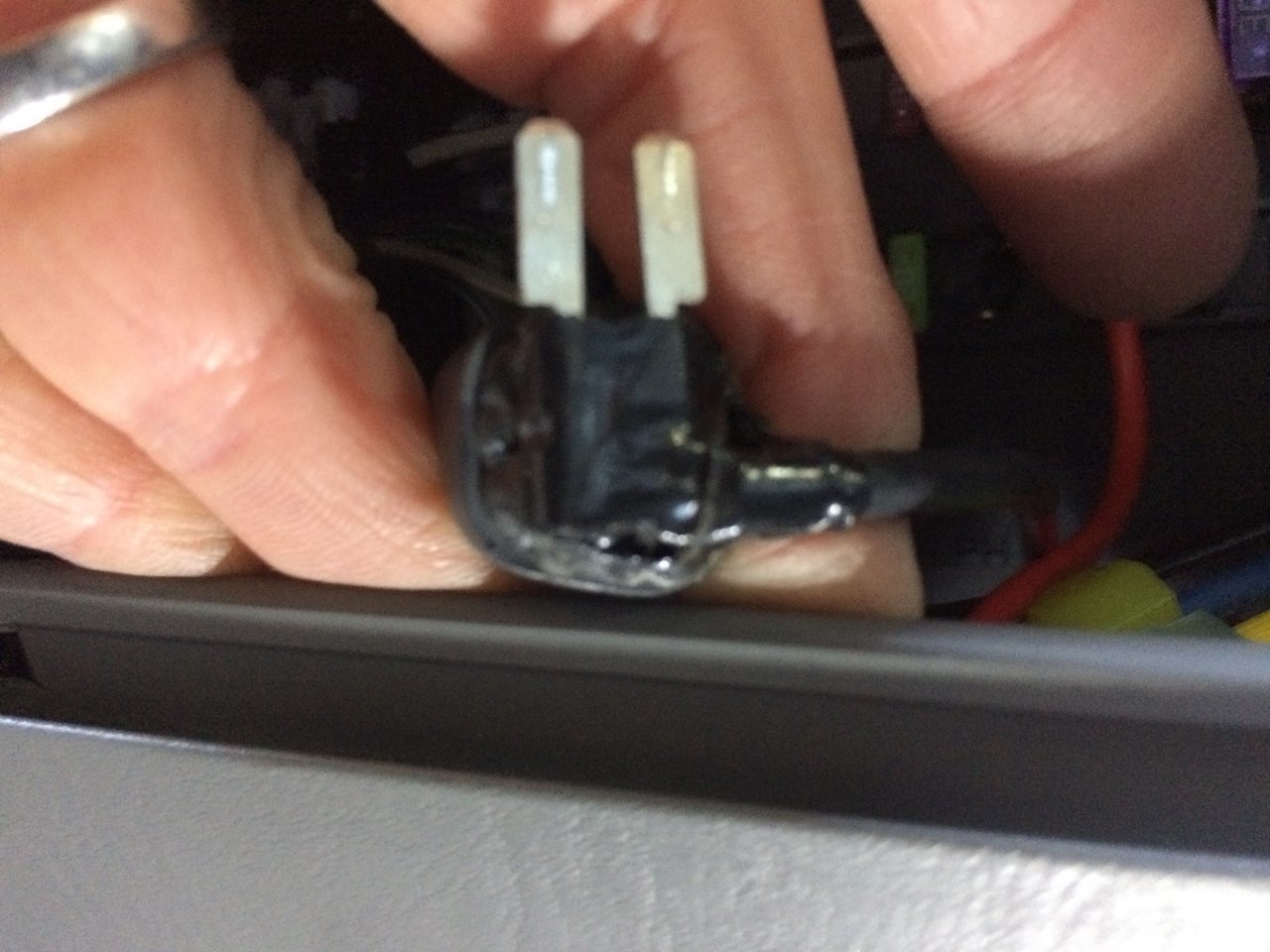

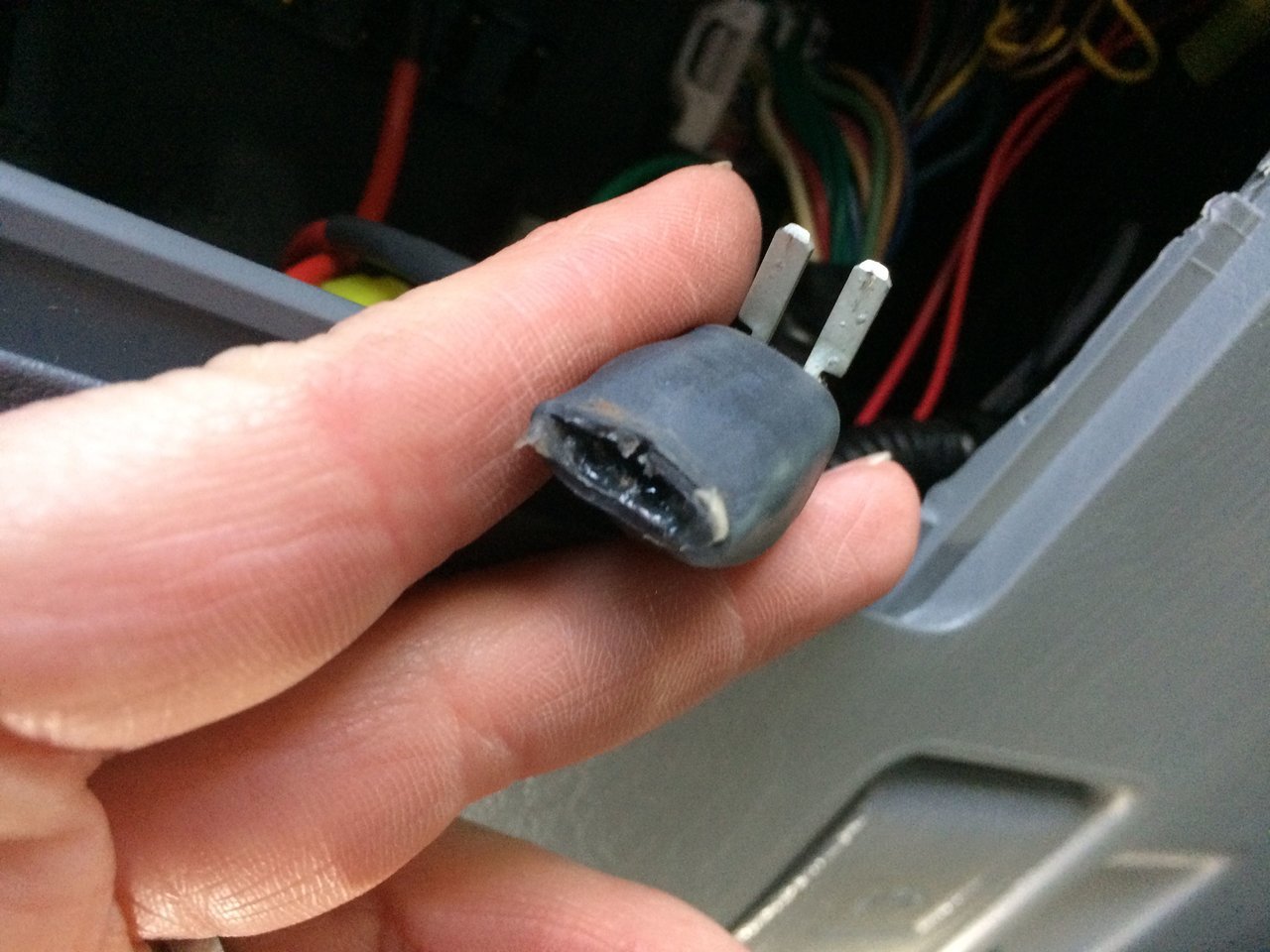

    Had some time to troubleshoot why my brand new AFR gauge was only working intermittently. Found this in my fuse box. Words can't express how furious I am at this shop - I paid over $200 for them to install this gauge for me. They even charged me for an 'Add-A-Circuit'. As an extra insult, they welded the bungs for the O2 sensors BEHIND the cats & the welds are pure UGLY.
    :frusty::angrygirl:

    02 4WD Tacoma
    Yeah I'd email those pictures to the manager of the joint and ask him what his plan is to make it right, cuz that ain't...

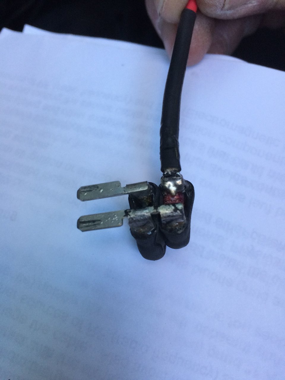

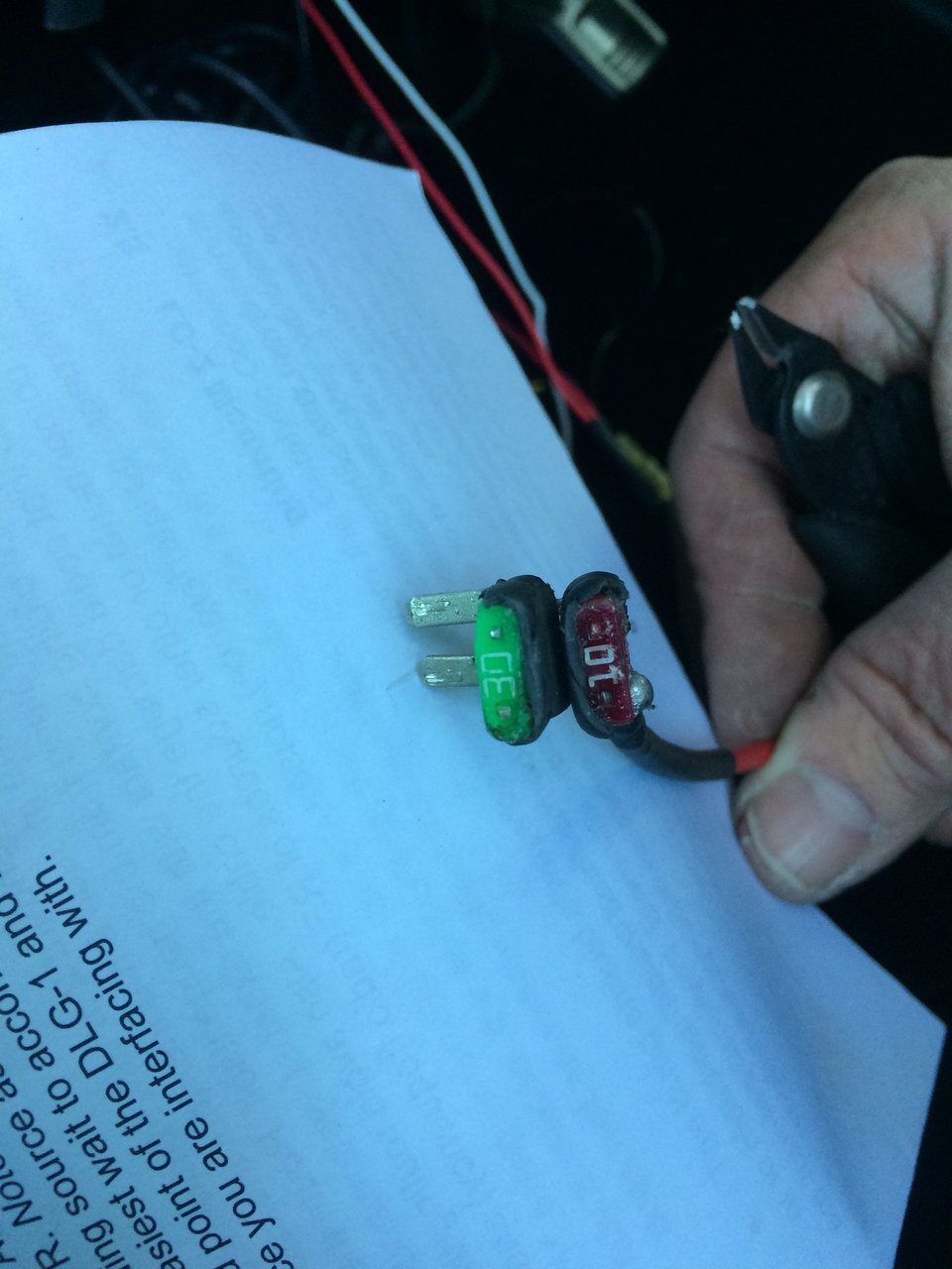

    So here's what we found. The 30 amp fuse is from the Wiper Motor circuit. The wires for the gauge & controller were joined & then fed into the 10 amp fuse. The directions state that the controller & gauge need a 5 amp fuse -- EACH.
    I might not be an expert with wiring & circuits, but I know that's all kinds of wrong!
    So very angry!!
    The shop is refusing to give me a refund. 'Negotiations' are continuing.IMG_2741.jpg IMG_2731.jpg
