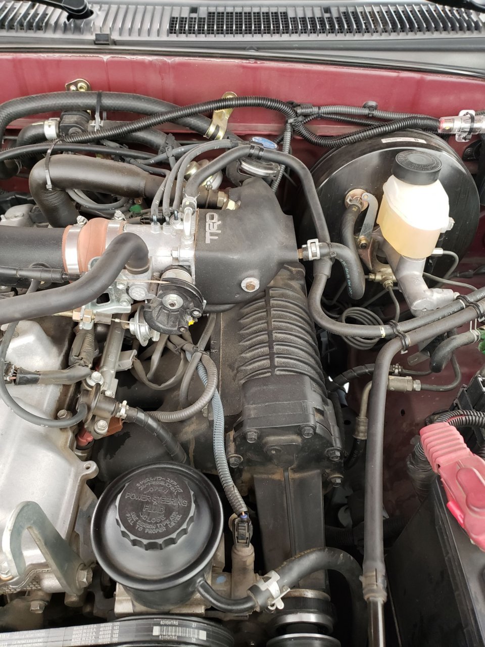

    02 Pre Runner supercharged 4cyl
    TRD supercharger , Doug Thorley header , K&N CAI 265/75-16 Toyo open country mud terrain , 15x8 Method Racing wheels , Rancho 3" lift , 4.88 gears , Detroit Locker
    Yes it's worth the cost I'm running a TRD Supercharger on my 2.7 and it's alot of fun especially seeing the other drivers expression when I pass them easily on a hill !!!

    Is your 4 banger setup stock or are you running a 5th injector, smaller pulley etc.?

    Supercharger was installed by the dealer in 2003 and it's the rare hard to find TRD

    Was installed at the dealer in 2003 , not sure on pulley size but it does have Supra " pink " injectors

    My truck only has 70k original miles !!!
