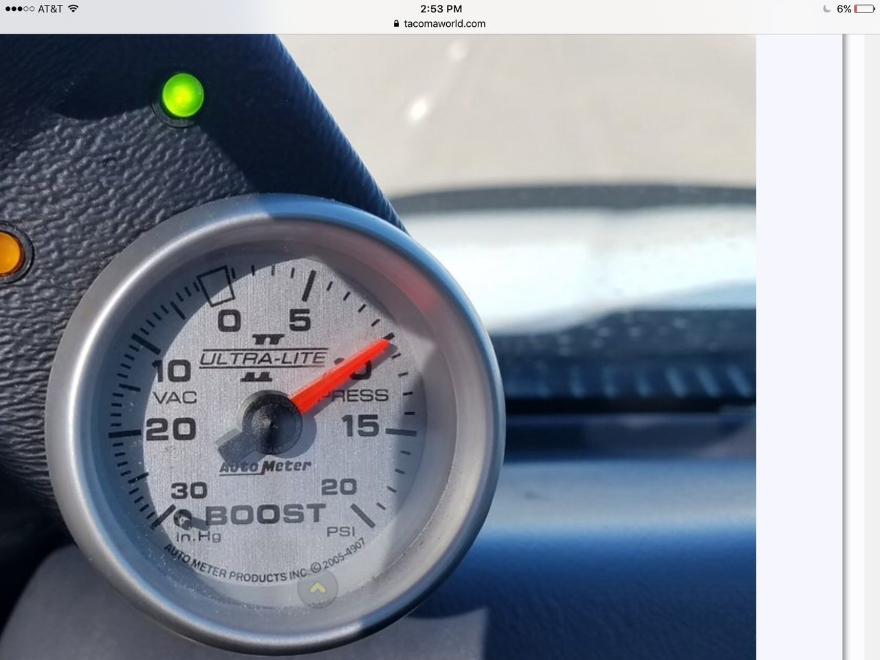

    You should be able to hit 10 pounds with some mods

    10lbs would be nice. Can the stock motor handle that with 7th injector and or meth inj? What mods are you referring too? Headers? Pulley? Thanks

    Depending on your motor if its ping happy. Stock pulley 5-6 pounds of boost probably will not need anything at higher altitudes.
    Higher altitude 10 pounds boost you definitely need fuel upgrades which I use methanol for my setup,
    i have a stock motor methonal only with 2” pulley at 6000 feet
