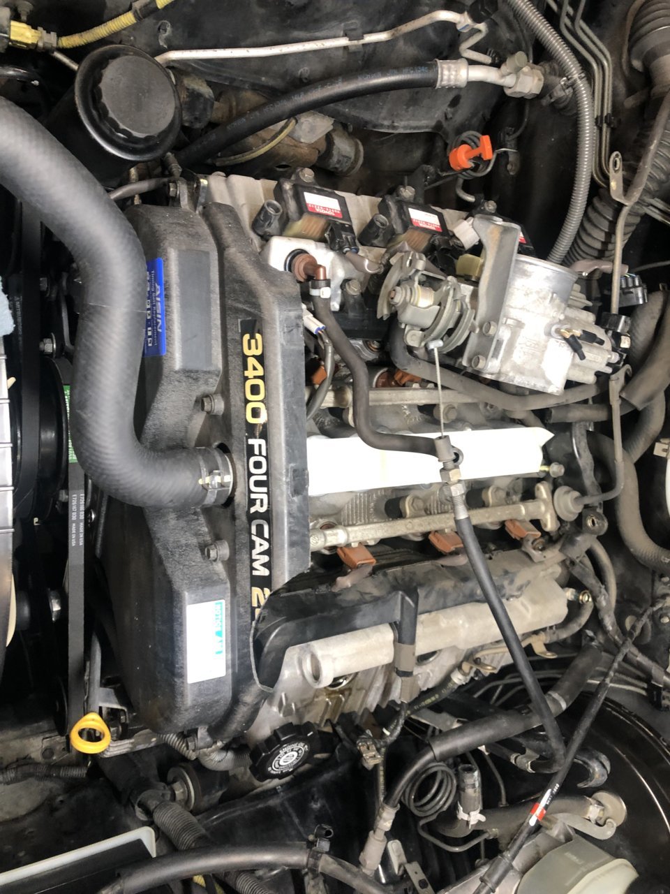

    My engine seems to be in good health. I take really good care of her. But I'm not the original owner. Here's a picture of when i changed the valve cover gaskets.

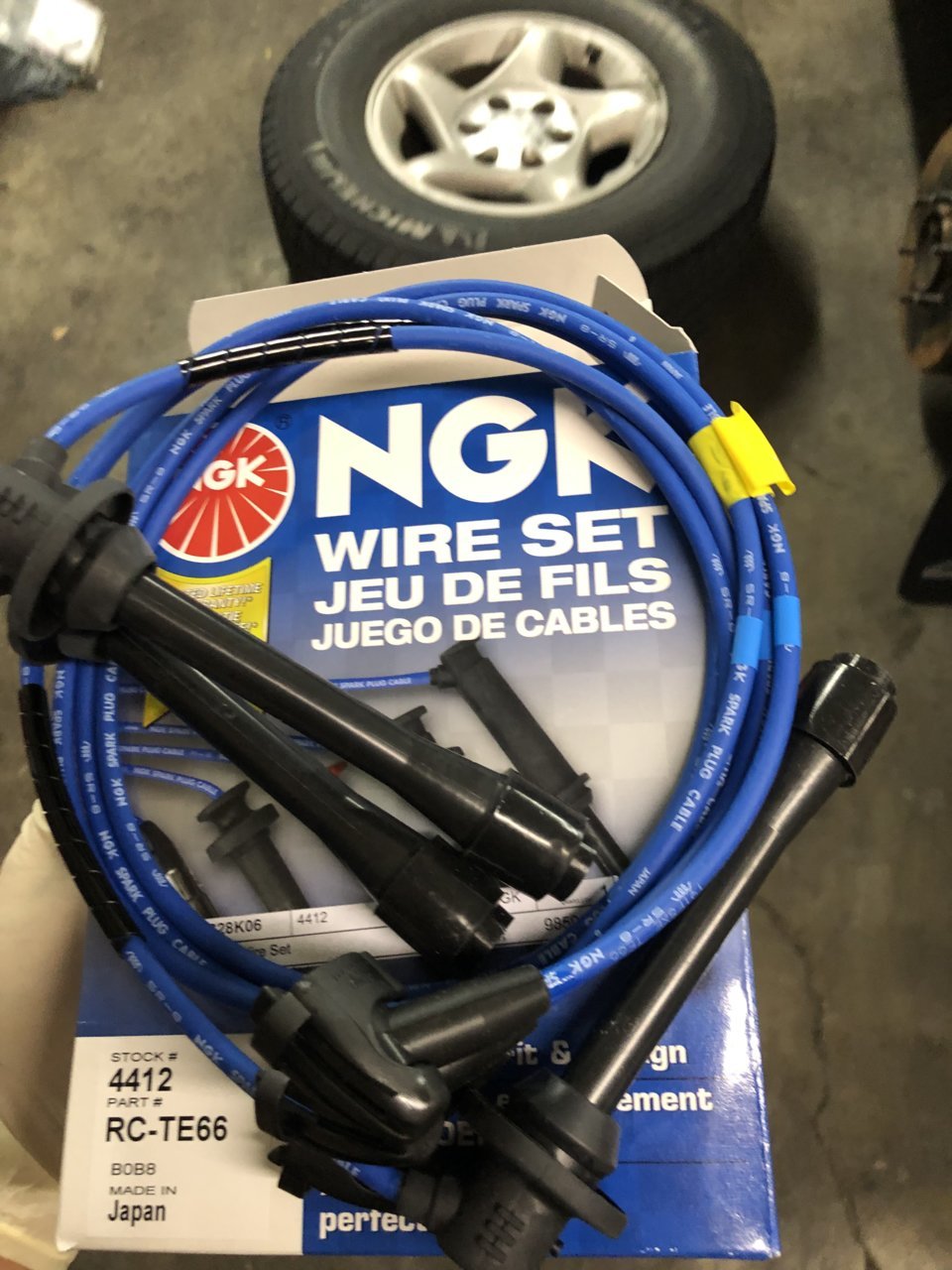

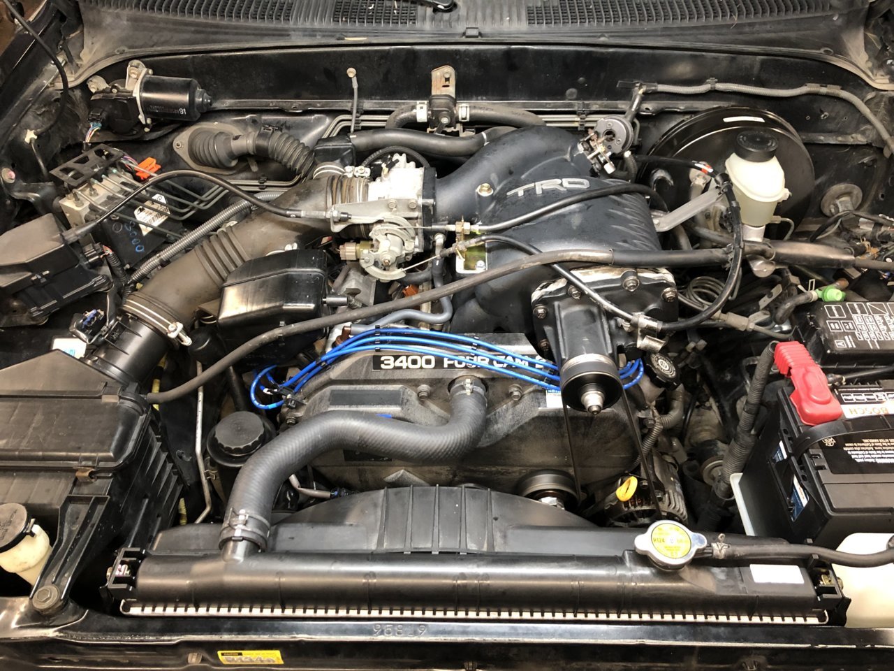

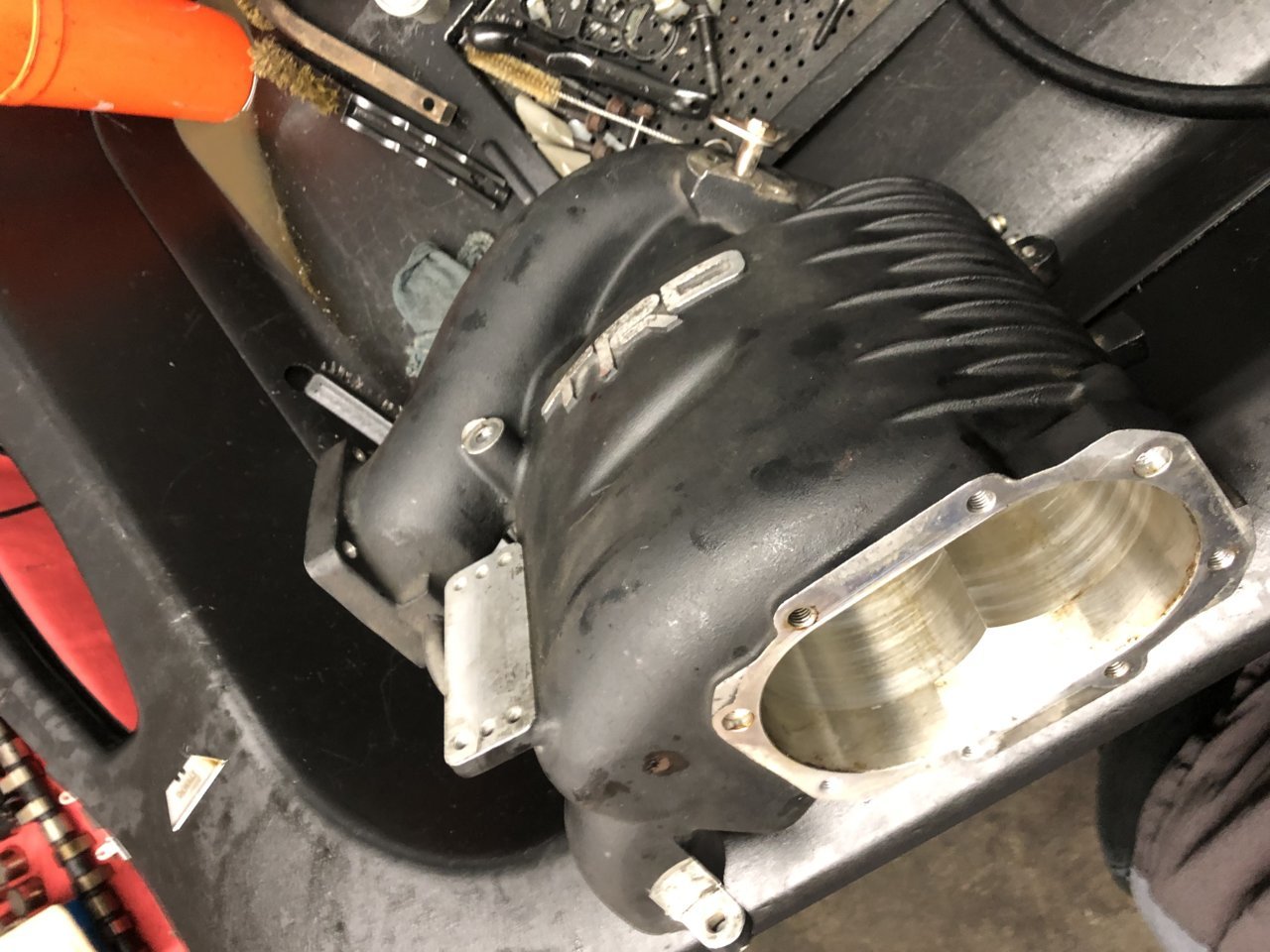

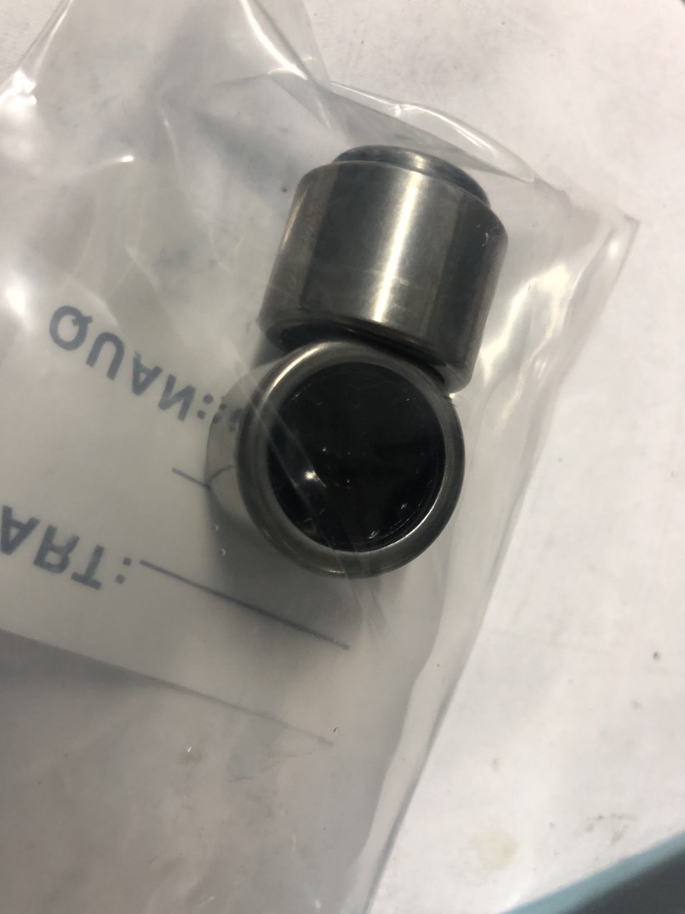

    Bought a used TRD Supercharger for $1900 with the TRD gauge . Replaced all the bearings. Cleaned the housing and installed using factory literature and templates. All in all, just under $2300 with new bearings, fluid, coupler, spark plugs, wires, intake and TRD O throttle gasket, belts and template. Supercharger definitely worth it. I am not planning on doing any other mods. I am planning on driving as many miles for the life of this car!

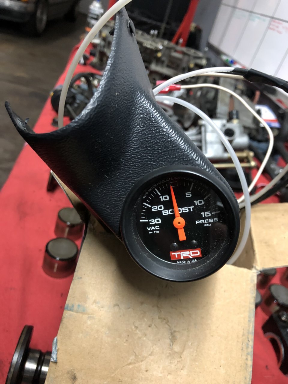

    Just an update and FYI... drove the truck some more today and I definitely noticed ping at tip in. I’m definitely going to need the 7th injector kit. It’s gonna start getting hot here in south Texas. I’ll be calling gadget tomorrow as I need to know when the other stuff will be coming in. They also sent me the wrong gauge pod mount. I’m still really happy with it. Truck drives just as good or better than before.
