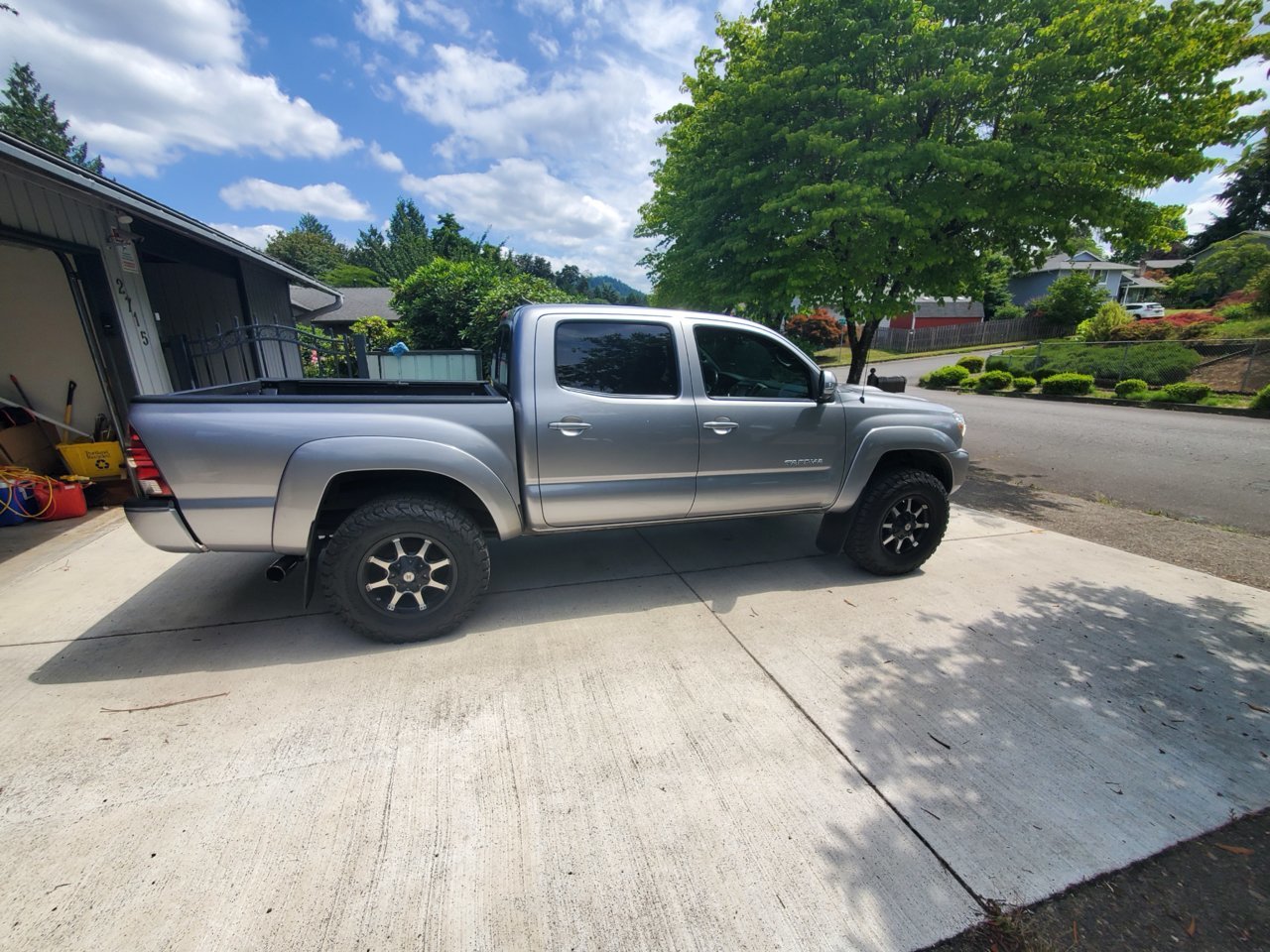

    My 14 Taco that will live on in his memory:
