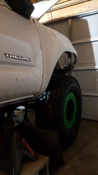

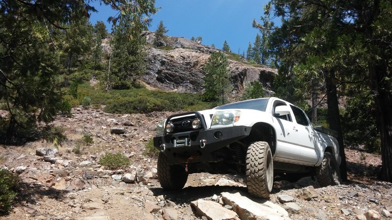

    Next stage was some 35" mud terrains, midtravel with kings, bump stops, limit straps and all pro expos.

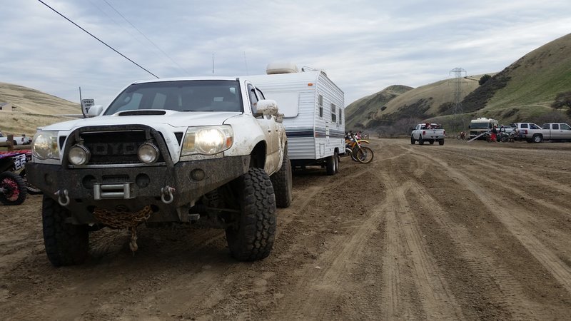

    Forgot to mention the relentless bumper which has saved my ass on numerous occasions.
    Shortly after this photo was taken, I got divorced, the new girlfriend and I decided it was time for a change so we bought a 24' camper, loaded up all our possessions and made the cross country trek to NC
    First trip out with the camper
    All loaded up
    I was very impressed with the taco, it out pulled the moving van and averaged 13mpg the whole 260p miles. We had a lot of help from the weight distribution hitch all pro Springs and brake controller. Only blew one trailer tire on the way.
    More to come

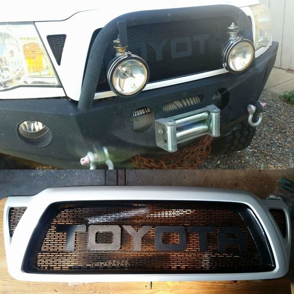

    Added a Satoshi grille thanks to my girl for the awesome present

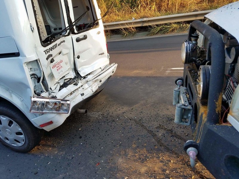

    Also added tow mirrorsreceived_10212739923599428.jpgGot Nina a transit for work, turns out it was a total pos. Had all kinds of trouble from it, so I decided to let the dog drive it which resulted in this

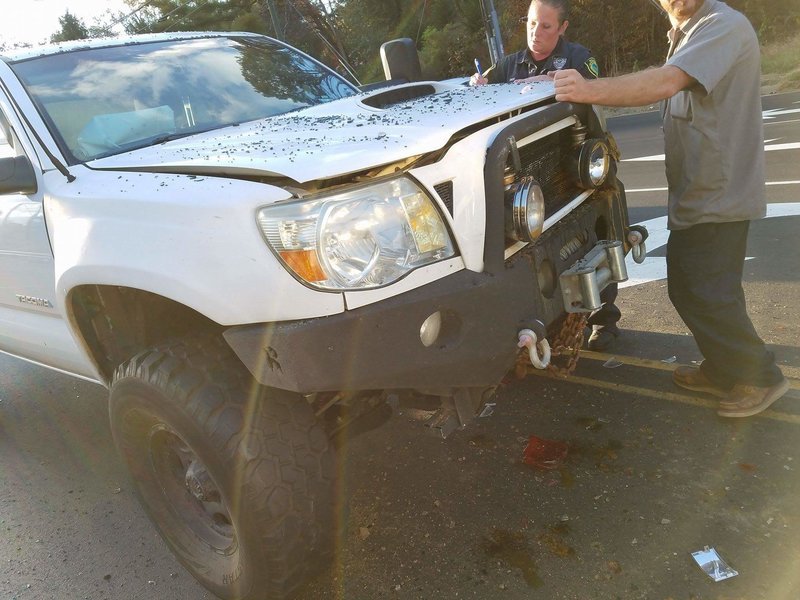

    Just kidding, she was in front of me when someone stopped in the road after an illegal turn which caused me to rear end her and a 4 car pileup
    Pretty bummed about the truck as my insurance had lapsed just before the accident, frame is bent slightly but the relentless bumper saved from a whole lot more damage.

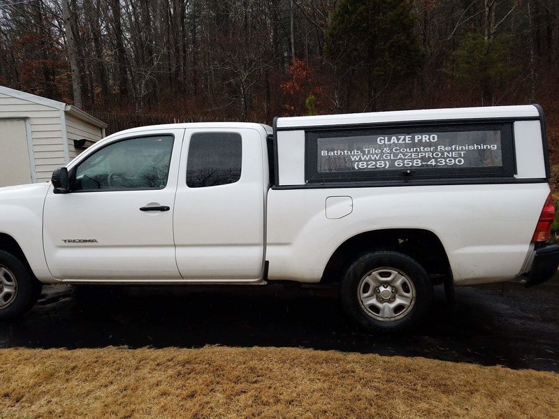

    Got Nina a new truck to replace the 90 which got my old 35,sreceived_10212739998161292.jpg
    The new truck, decided to keep it toyota after the Ford fiascoreceived_10212739999921336.jpg

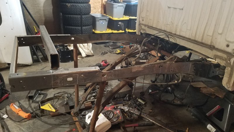

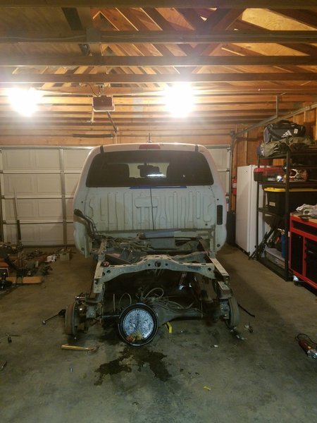

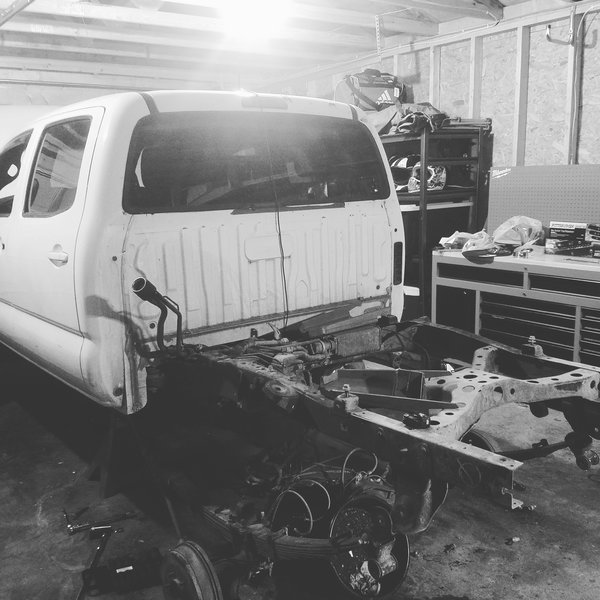

    Started tearing the truck apart, got the bed off and started removing everything

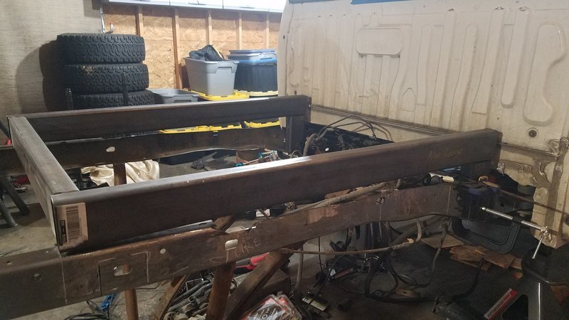

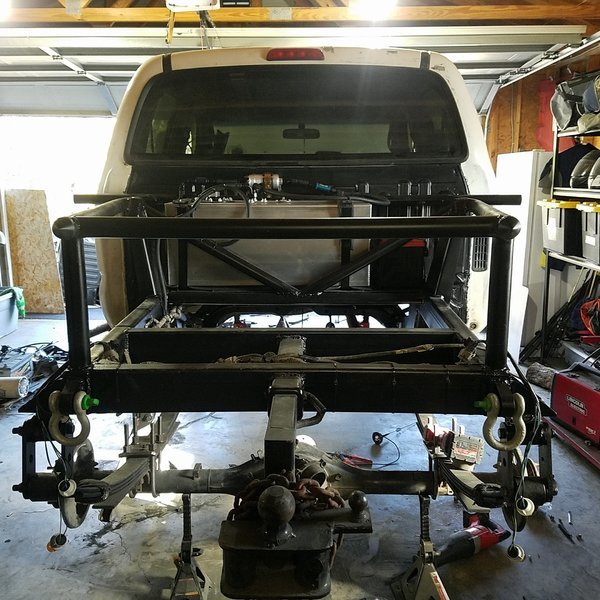

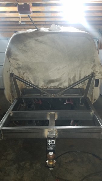

    Original plan was to plate the frame but after tearing it apart decided to just build a whole new rear frame.

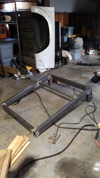

    Cut the humps off the frame and used it as a jig to build the new frame from rectangular steel and dom
    Frame starting to take shape all level and square
    Took the frame off to fully weld

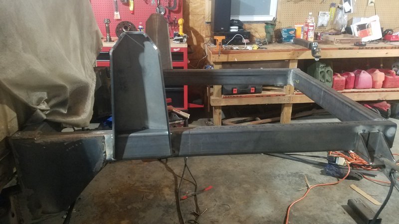

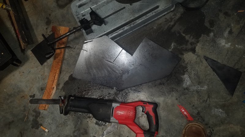

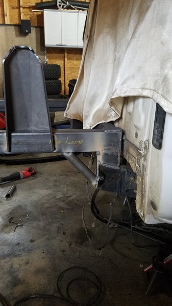

    Got the new frame welded on behind the cab and cut the factory frame off. Added some tube for good measure. You can see the ruffstuff shock towers here as well
    Welded on frame outriggers for the shackles to mount to and started plating the transition
    Sawzall getting lots of use, can't wait to get a plasma
    Picked up a tubing notcher
    Things are coming along nicely
    Picked up an rci fuel cell and started tube work

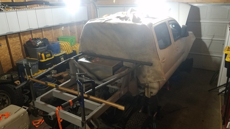

    Primed the frame, chopped the tailgate and test fitted. Also got the 63 swap tacked in place

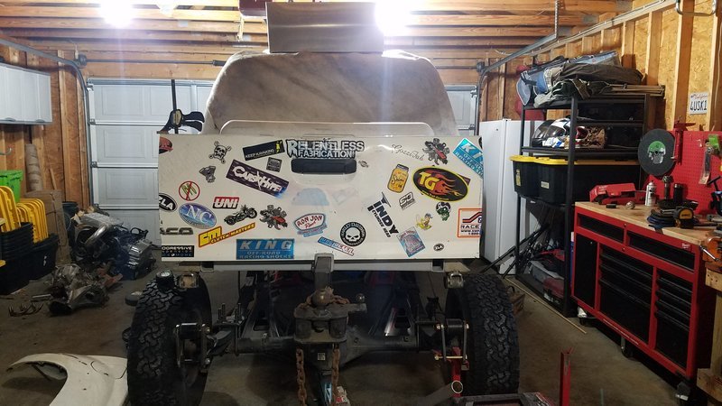

    Ordered tires and a dana 60 housing
    Going spool in the rear with gears and ruffstuff disc brakes
    Got the frame done and painted. Bedlined the back of the cab too.

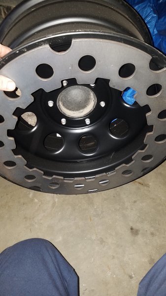

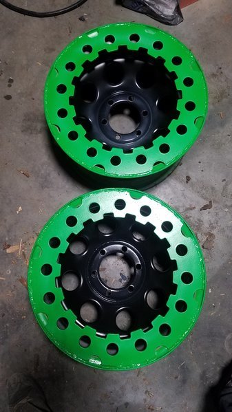

    New procomp wheels and tmi rock rings
    All welded and painted

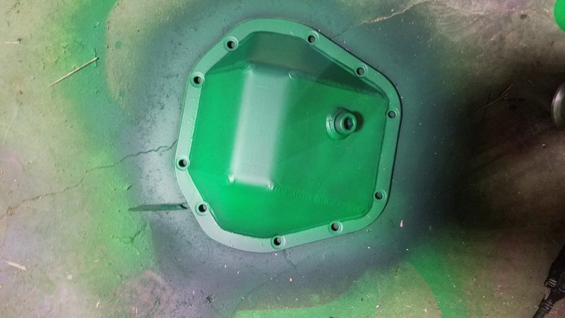

    Ruffstuff diff cover
    20170204_174505.jpg bobbed the bed sides 9 inches

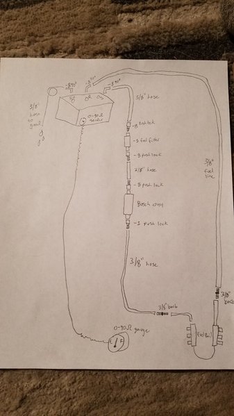

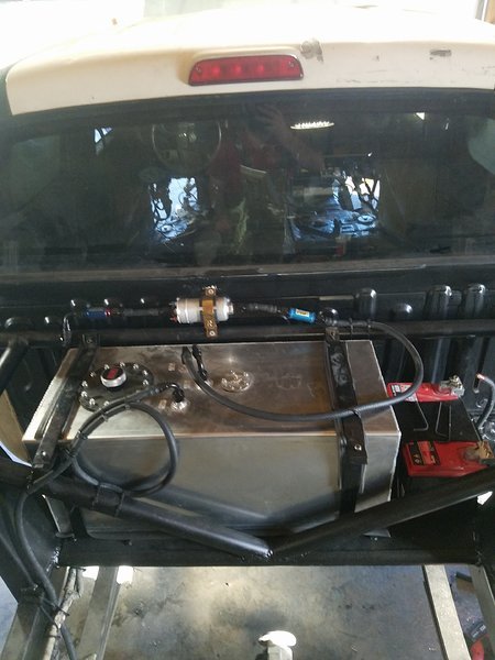

    Working out the fuel system
    New gauge to work with the Gmail sending unit

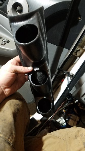

    Gauge pod for the fuel gauge and future goodies

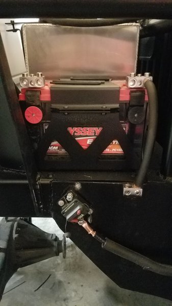

    Hooking up the fuel system and battery. Bosch 044 pump with an fittings
    Oddesy battery and ruffstuff tray, breaker for safety20170210_181313.jpgTeaching the girlfriend to weld on a gate for the porch20170210_181354(0).jpg

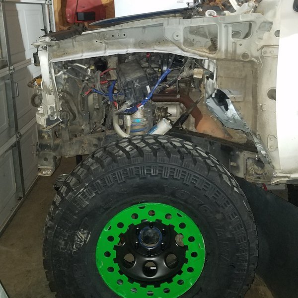

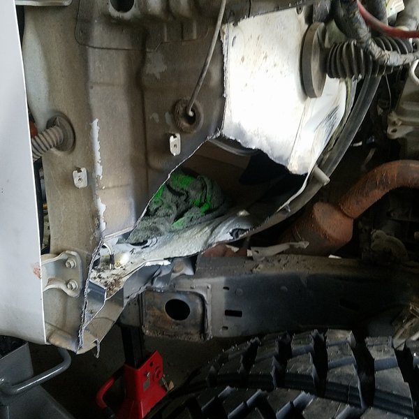

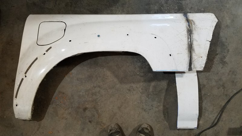

    Clearanced the inner wheel wells and firewall
    I cut it back a lot, should be able to stuff 40' s or better when I do the sas by moving the axle forward an inch and a half or so

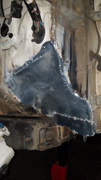

    Also cut the front cab mount off and modified a ruffstuff frame outrigger that I welded on upside down for the new cab mount. With delrin pucks instead of the soft rubber that comes on the factory mount.
    New cab mount on and tacking on the firewall plates

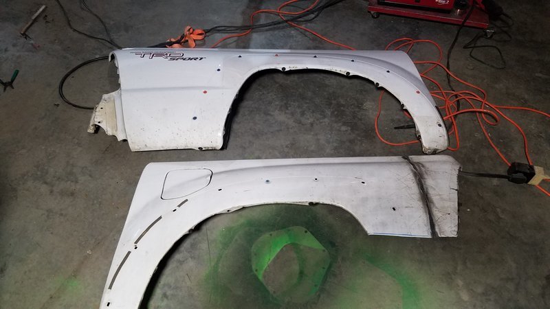

    Making sure the fenders line up and clear, will trim the lower portion when I can get it out of the garage and flex it out.

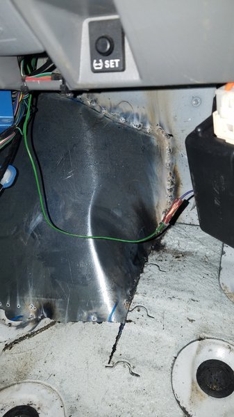

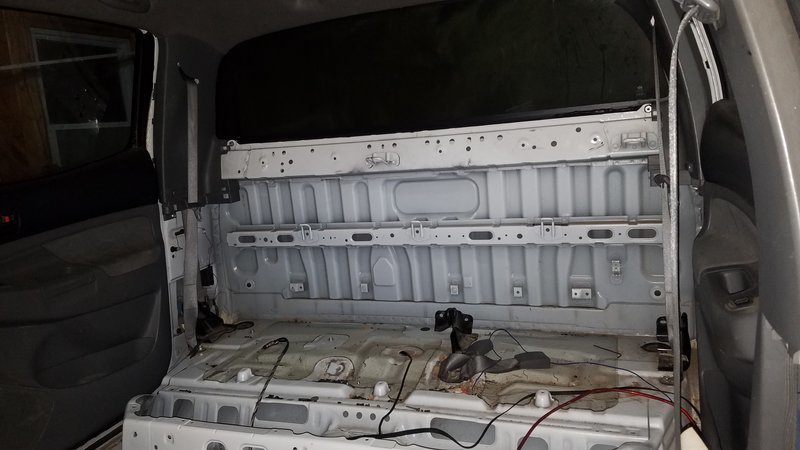

    Gutted the interior going to bed line it all.

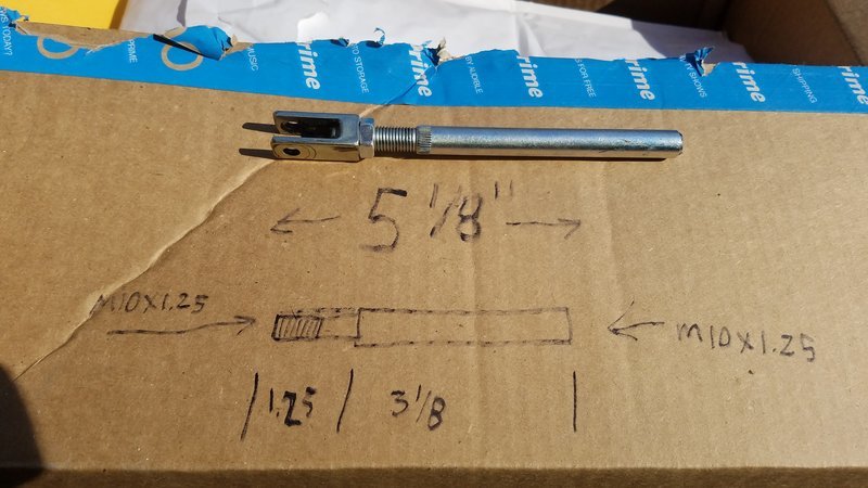

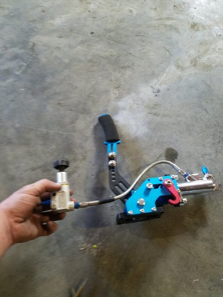

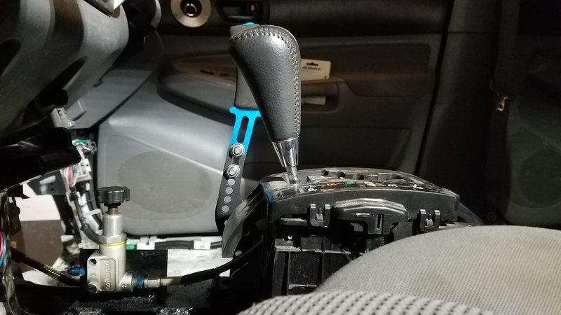

    Cut off the old booster rod to make an adapter from the t100 booster to the factory pedals.
    Proportioning valve and hydraulic e brake for the rear since I'm using a 60 with ruffstuff disc brakes and the entire brake pedal simply wouldn't have fit after tubbing the firewall and floor area
    Made up a bracket and mounted to the center console area. Braided line from prop valve to brake.
    Cleaned up the wiring and raised the fuse box, I will make a bracket later.

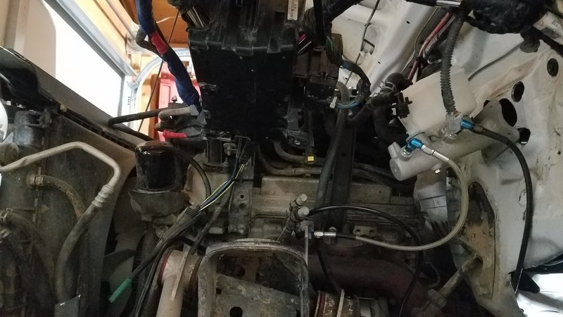

    T100 master cylinder with an fittings and braided lines. Front goes to a tee mounted on the strut tower, one braided line from tee to drivers side hardline on the frame rail. Need to make a hard line to the passenger side.

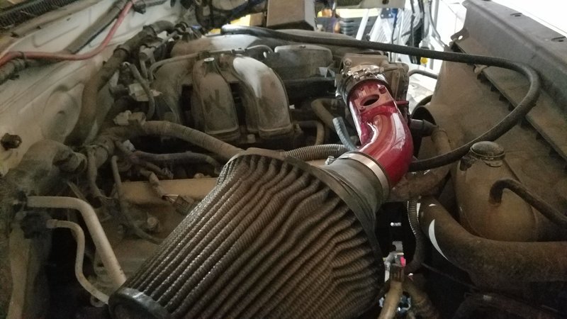

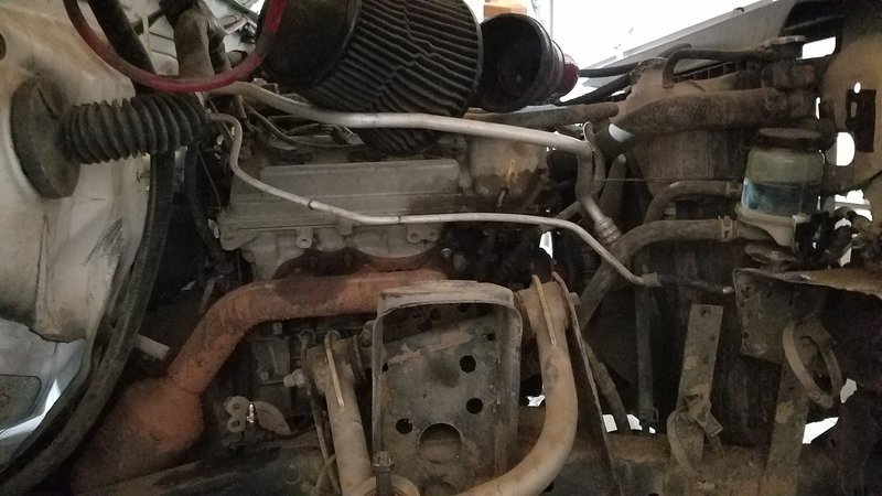

    Working on the intake setup a bit, I hate the factory design and this gives me much more room.
    This shows how open the bay is now, took out the abs pump and moved wiring and power steering reservoir.

    What front fenders were those?
    The fitment looked pretty good

    Trailer products they have a 3" flare and 2" rise

    Thanks bud, I contemplated useing the stock tank but it didn't fit as well and the rci looked much better. Can't beat the price on the 60 from ecgs, great guys to work with.

    Heard that. It doesn't fit as well I had to cut the bed up to make the tank fit better. Ecgs really is great and I live in Durham so it's a no brainer for me, 15 minute drive.

    I love my rci fuel cell. Did you go with 19 gallon?

    Yessir probably not enough capacity for expo stuff but I mainly daily it and stick to moderate trails should do the trick just fine.

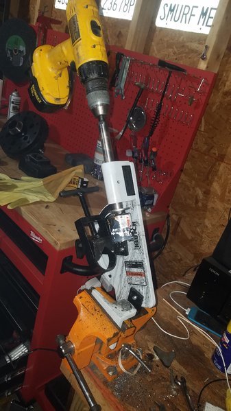

    Dad machined two different adapters for me which I will cut to final length once I get the adapter plate for the pedals finished.20170221_201548.jpg 20170221_201623.jpg
    Hawk super duty pads arrived today
