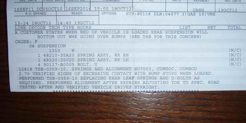

  17. Oct 21, 2012 at 9:04 AM
    #17
    nytro
    nytro Active Member
    Sep 20, 2011
    #63857
    25
    NorCal
    2011 DCLB
    Front:Bilsteins 5100 with 884's. Rear: Bilsteins 5100, tsb and AAL.
    I just picked up mine yesterday. Here's what the invoice showed with part numbers.

    that helps out a lot I'm going to take it back with those part #s
