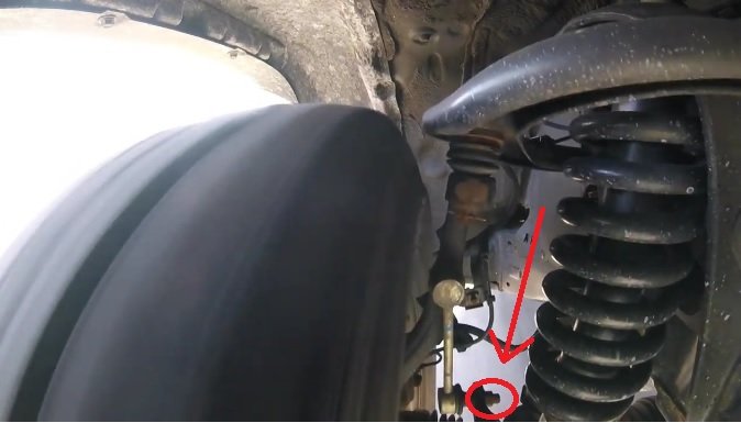

    When going over road bumps, potholes, and speed bumps my suspension makes a clicking/clunking sound as it articulates. Took it to the dealer and got the typical "it's normal" speech. I overheard them discussing something about a UCA bushing, and when I asked about it they just kept telling me it's normal. The truck didn't make this sound until around 23k miles, I changed the tires from 245/75/16 to 255/85/16 and it stayed exactly the same. Now at 34K miles. 2016 SR 4 Cyl ACLB with 150-200lbs in mods. I really appreciate any help or suggestion in diagnosis. They say everything is tight.
    https://youtu.be/rP2yIl9HsMo
    https://youtu.be/88wj6MJMRqk

    Check your sway bar link ball joint bolt tightness. I had exactly that on my Gen1, and it drove me crazy for a while until I figured it out. They seemed tight enough, but allowed just enough movement that I'd get that "click" or "tink" on bumpy surfaces. Even though I couldn't determine any play by hand, it was there. And surprising how irritating it was and how much noise it made when moving such a tiny amount.
    I swear I can see the lower joint on the sway bar jerk in your 2nd vid at the 11 second mark. It seems like it has something to do with that. Look closely and you can see that end of the sway bar jerk and "vibrate" momentarily with the click sound.

    To add to this, I had the sway end link loosen up on my hub carrier and cause a similar sound too. You could disco the sway altogether to eliminate it as a possibility as well.
