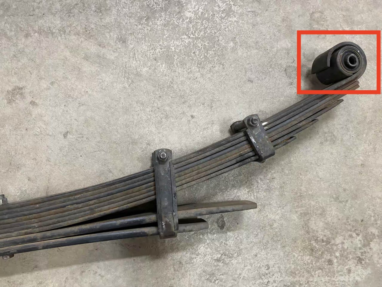

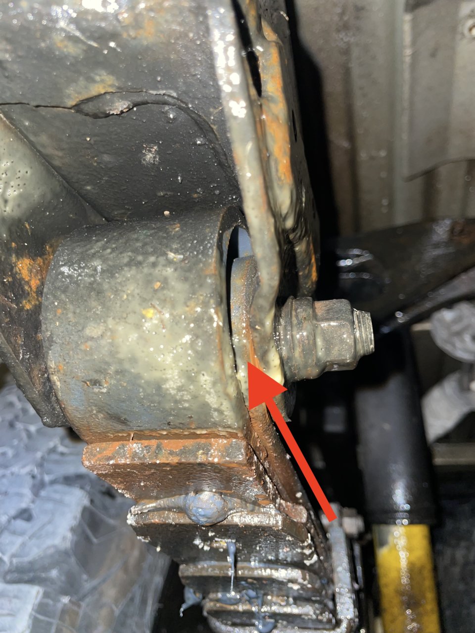

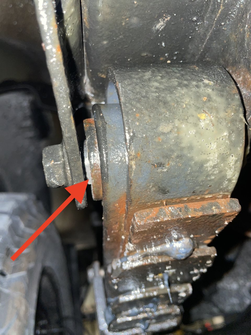

    Ok, reporting back on this. I have been fighting the truck all weekend. Toyota tells me the front suspension and steering rack all look good. They confirmed side-to-side leaf movement in my Dakar packs. I checked all the torques on the leaf to frame brackets, U-bolts, shackles, and shock mounts. Everything looks fine. I hit all the shackle zerks and anti-squeak pads with grease. Still clunks. After a lot of digging I found a thread from IH8Mud about the front spring eye bush that comes press-fit in from the factory. Note the little metal sleeve sitting inside the rubber bush (these are not my spring packs, I just found this photo online):
    Apparently the thin metal sleeve on the outside of this bush breaks loose over time and lets the spring "walk" back and forth, chewing up the ends of the bush. I checked my truck (these ARE photos of my spring packs):
    Looks like the sleeve has broken loose on my passenger side here. I think ordinarily the rubber bush would be tight up against both sides of the frame bracket. Since it's gone, when I hit a bump, particularly when turning, I get the clunking noise. I'm guessing body roll shifts the spring slightly; since the bush is buggered up, the whole spring eye clunks against the frame bracket.
    I have a set of Energy Suspension bushes on the way; will update if this finally fixes the problem.
