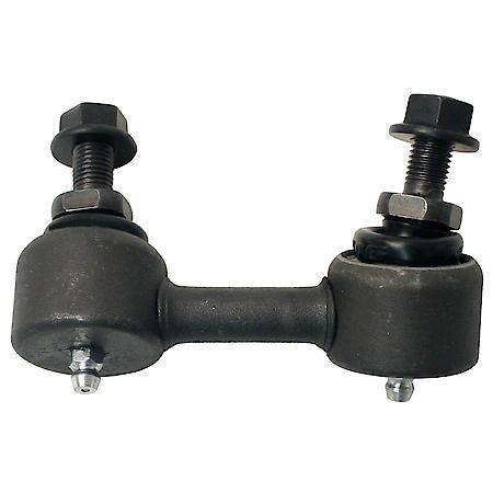

    And my sway bar end links are shot. I have attached a picture of what they look like. I know there one that looks like it has one end nut with a threaded rod. But that's not what I have. (Is left and right that different from each other lol?)
    Need that part number.

    If the OP's end links do in fact look like his pic, the only thing from your link here that will work are the middle bushings that bolt to the frame. Those smaller bushings are for a different style end link.
    This is probably why auto parts from Amazon is not all that a reliable way to get parts you know will fit.
    @Quality Taco, just get some MOOG or ACDelco endlinks from Rockauto or something. These are not a critical piece to get OEM like the lower balljoints.
    https://www.rockauto.com/en/catalog...ension,stabilizer+bar+end+link+/+bushing,7580
    Bushings for $7
    https://www.rockauto.com/en/catalog...418453,suspension,stabilizer+bar+bushing,7624
    If you want ES poly bushings, I believe you can get just the bushings, without the endlink bushings.

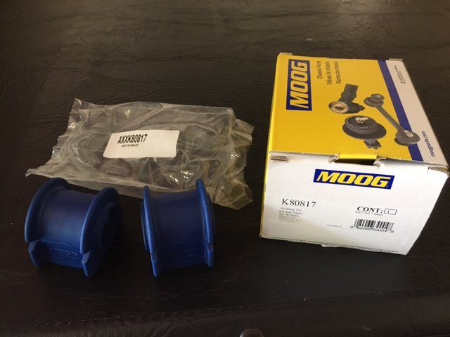

  10. May 5, 2021 at 2:02 PM
    Kevins60
    Kevins60 axle wrap tells me my rear brakes are working
    Dec 23, 2018
    #276677
    1,217
    Kevin
    Odessa FL
    ‘04 4cyl SR5 AT Pre-runner Garage Queen
    SCS Cruise Westin step bars Lund tonneau Jensen HU
    I am trying Moog, figured these are the easiest to replace if they suck.D3477573-8463-4941-B4BE-8BD29377FD00.jpg
