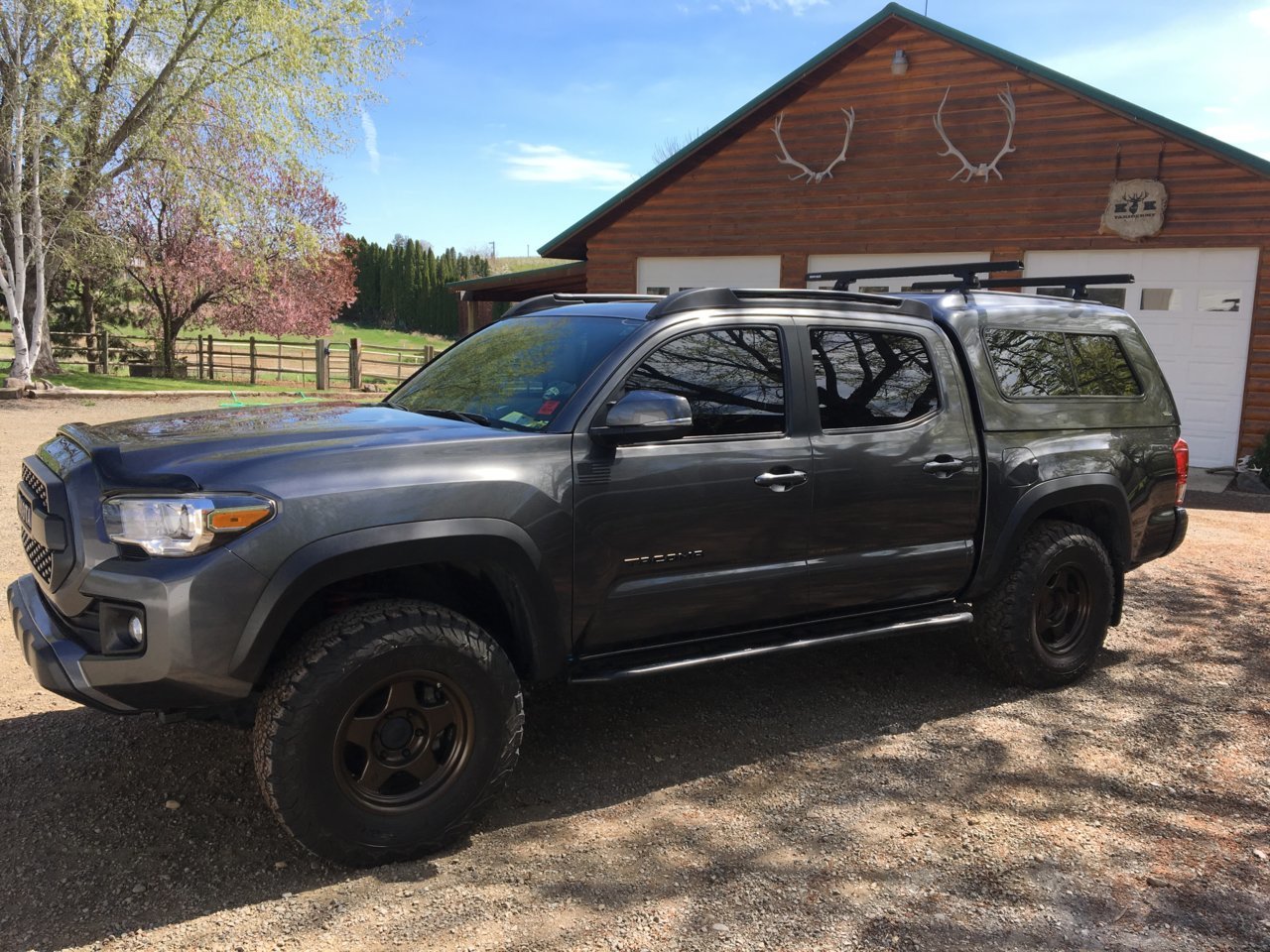

    I’m in the same situation. Daily driver but also my hunt/fish rig. I put fox TRD pro on the front. I’ve got Bilstein 5160’s for the back. Gonna put Dakar heavy leaf pack on rear when I put Bilsteins on. I’m running a canopy and decked boxes with gear so the heavy leaf pack is needed. I’m still a few weeks away from finishing up but I’ll keep you posted on progress

    @fireman10 Yes, definitely do. Exact same scenario running canopy with truck vault (probably a little heavier) and sliders. I was thinking of doing Bilstein 6112 in the front but heard they are a bit rough.
