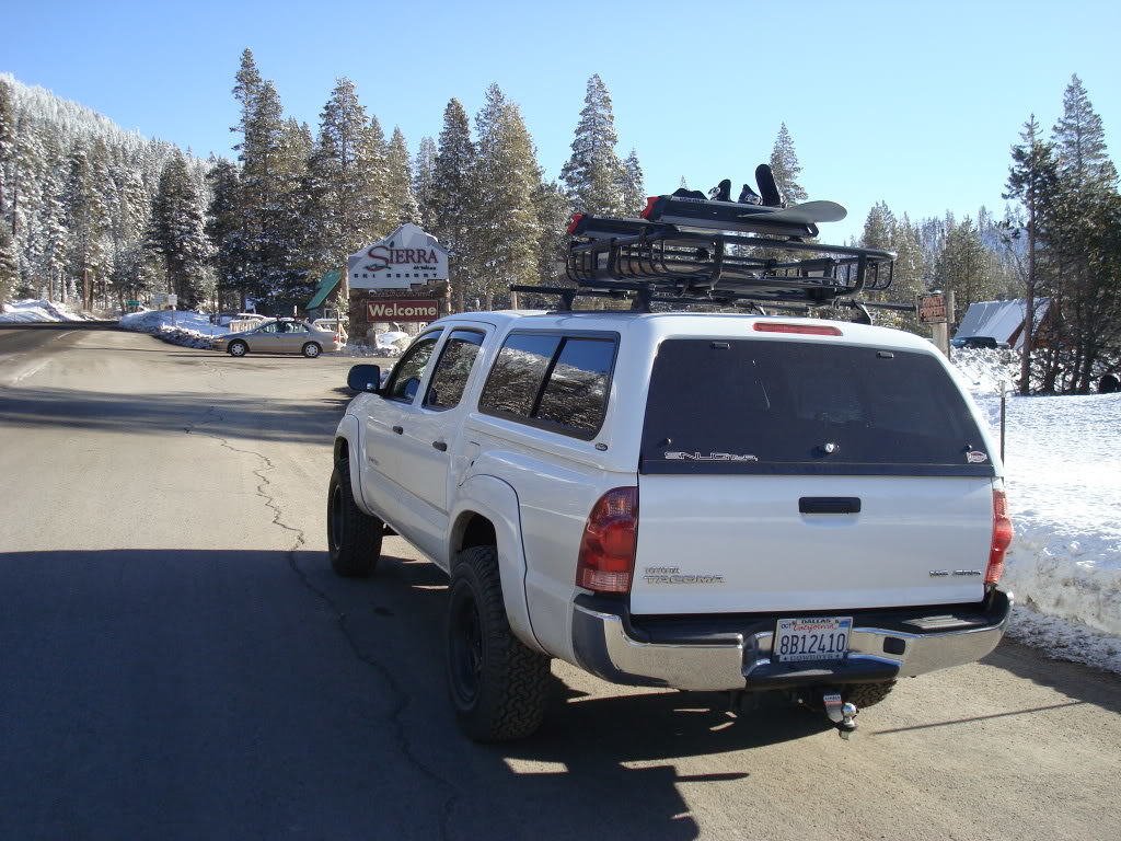

    This is prob kinda late but here's my truck with a little bit of rake. The front billies are set at .85 and the rear has tsb done and 1" block. Your aal should make the rear a little higher.

    That is a sweet looking truck. I think I will be good to go on my rake as I am adding the AAL toyotec and I already have about a 2.5" lift in the front.
    My tires look so stupid with the lift. They are the stock tires and I need to do something about that. What size and make are your tires?

    ^ doesnt that rear tsb add over an 1". so with the block your at least 2" rear. with only 1" up front shouldnt that increase the front rake?
    from that angle it looks like (or theres just alot of weight added to the back with the camper and all) that there should be more than 1" lift up front. but its not my truck so im just making an observation :)
    did you add a top plate spacer to the front?
    then to the op: if you can touch 2 grooves your set at .85 which means your close to 2.5" up front. was there any top plate spacer added with that package 4? if so and they are installed your closer to 3" up front. also with the rear idk if the package came with 5100's for the rear but that would be a good idea to upgrade to those for rear shocks with the 2" leaf.

    My tires are stock size 265 75 16
