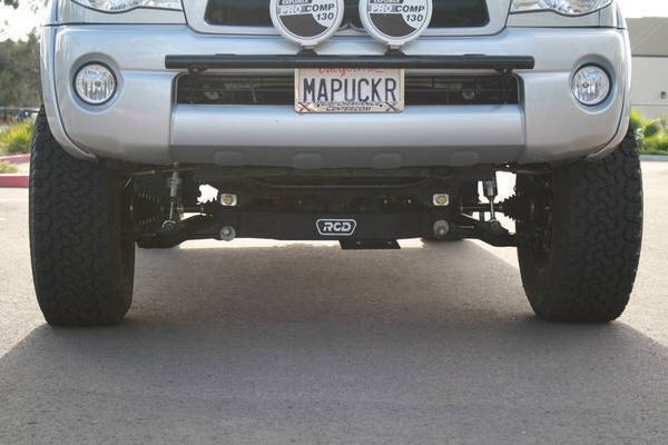

    drop bracket lowers the front diff.
    https://www.tacomaworld.com/threads/drop-bracket-lifts.66013/
    edit:
    Yes the frame is higher off the ground, but your front differential has been lowered so you're not gaining ground clearance. You do gain a little ground clearance due to the larger 35" tires. You're better off clearancing your fenders to fit 35" tires on 2.5-3" rather than scrapping what you have for a 6" lift.
