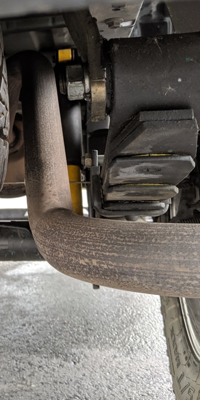

    Fresno County
    4 run, 2 don't
    As you can see, it's already rained a few times.
    Hoping to get the exhaust cut when it's not raining, then go inside and push out the bushings on my fox shocks. Once I get the shocks installed, it's all over.

    Jun 26, 2014
    #132748
    11,990
    Northern California, Bay Area
    02 3.4 DC TRD PreRunner 4WD SWAP
    Looking good! I left my exhaust intact for the time being - didn't want to cut it and hasn't been an issue so far. Don't forget the BPV bracket - be it homemade or otherwise.
  12. May 16, 2019 at 10:01 AM
    #32
    Kwikvette
    Kwikvette [OP] Well-Known Member Vendor
    Feb 27, 2019
    #284735
    82,337
    Fresno County
    4 run, 2 don't
    Really?
    I figured the exhaust would be making constant contact with the leaf.
    As for the BPV bracket ,post #17, second picture :thumbsup:
    Area51Runner[QUOTED] likes this.
  13. May 16, 2019 at 10:10 AM
    #33
    Area51Runner
    Area51Runner Well-Known Member
    Jun 26, 2014
    #132748
    11,990
    No contact
    Kwikvette[QUOTED][OP] likes this.
