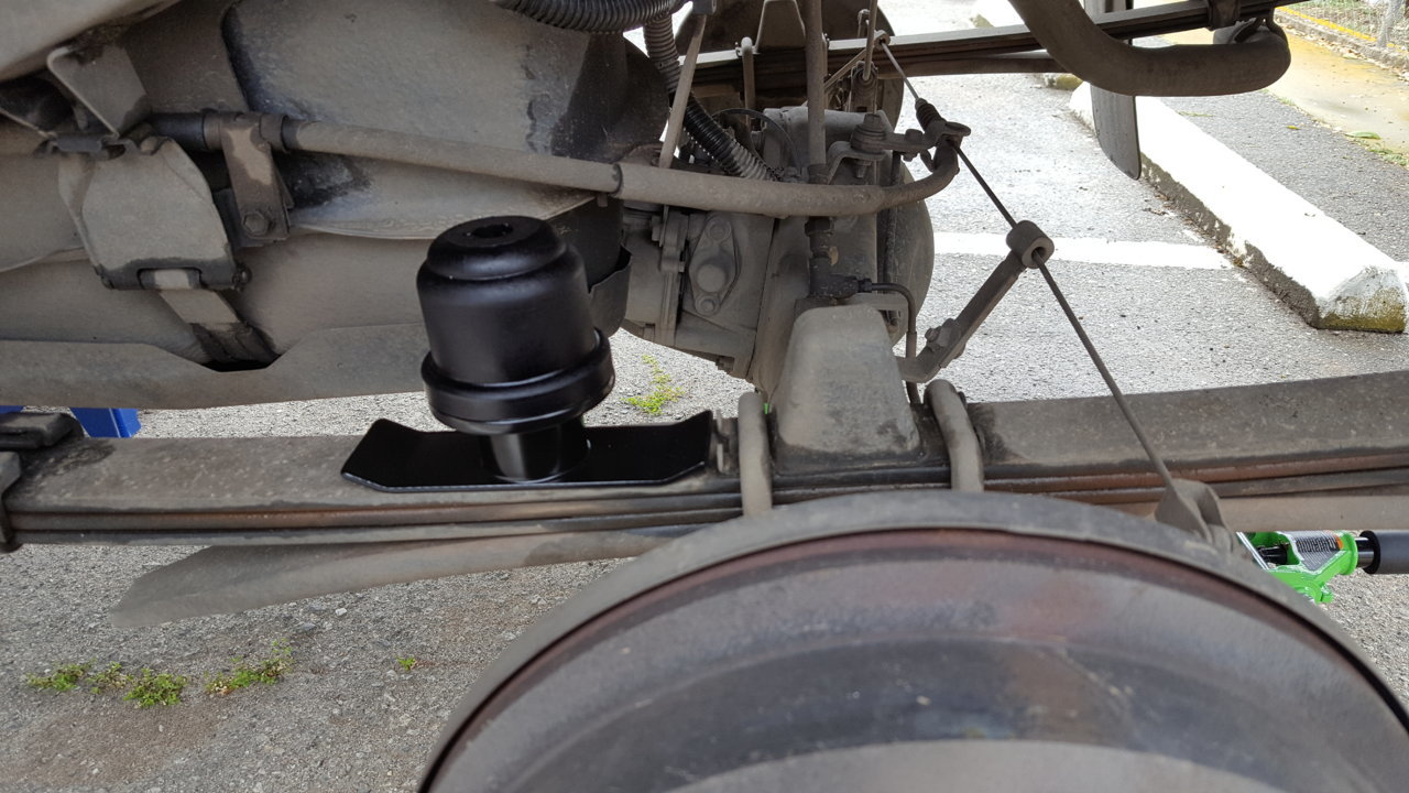

    Don't know how some of you guys do it but, I could not for the life of me, get the lower part of my Fox 2.5 coilover to line up at all to the lower control arm.
    Mod party?
    Will bring food and drinks :fistbump:
    Just need to do the rear...leaf springs that is.

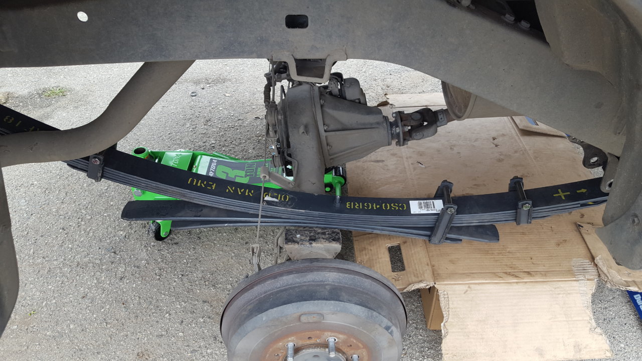

    Today's progress, driver side. Front bolt not in yet...will do later.
    Passenger side, shackle isn't even on yet.

    Driver's side needs the leaf spring to be ratcheted back as you suggested to get the bolt all the way in.
    Passenger's side has the leaf spring resting on the axle. Shackle's and bushings greased up but nothing is bolted down.
    Area51Runner[QUOTED] likes this.

    Uh-oh... Damn. You want the "+" marked pack on the driver side.
    I forgot to mention that in my first reply to you. Sorry bud.
    The indicates the pack tested a little stronger above spec. The "0" means it meets spec. If it were marked eith a "-" then it would be slightly below OME spec but still meeting OEM specs.
    You want the higher rated pack on the driver side due to the gas tank, your weight, etc.

    I thought that, but I went by part number instead.
    "A" is for driver's side, "B" is for passenger's side.
