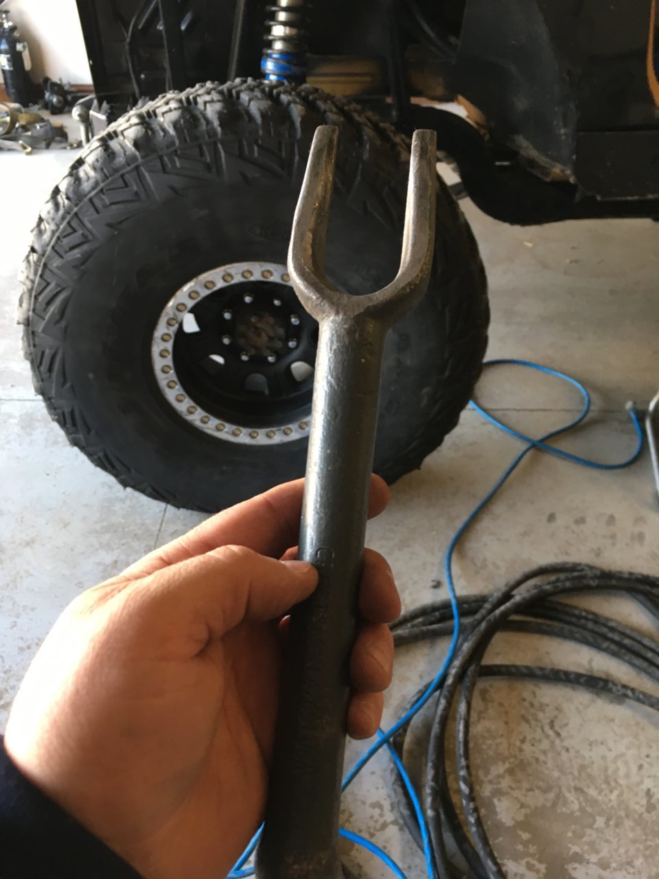

    Just managed to get the coilovers on beautifully without having loosen the LCA cam bolts. Uninstalling the knuckle bolts definitely helped a lot. However, I am having issues trying to shock the spindle out of the b/j bolt to get the UCA free. Any tips? I have already tried shocking it out of place while having the castle nut loosely on the b/j to ensure the UCA doesn't shoot up as fast.
  18. Feb 15, 2019 at 3:56 PM
    #18
    ColoradoTJ
    ColoradoTJ Retired cat herder Moderator
    Sep 3, 2018
    #265097
    10,190
    Colorado
    3500 Duramax, Roush Mustang, Jeep Crawler
    You can heat up the knuckle a bit.
    Use BFH.
    Or use this....

    @ColoradoTJ got the spindles out after a few good whacks. Had some rust from coastal SC and GA. Got everything in and greased this morning. I did find out I got seized cans from rust, though. Tried to get an alignment, which is how I found out. Other than that, the parts were super easy to install by myself.
