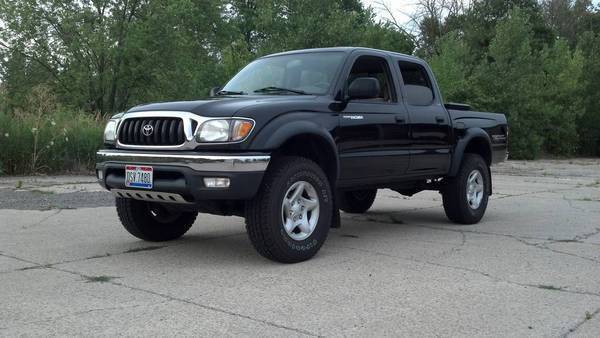

    Ohio
    04 DC trd 4x4
    deck plate mod, grey wire mod, 5100s front w/OME 881s, 5100s rear w/wheelers 5 leaf, 265/75R16 Firestone Destination A/Ts
    Front 5100s at Zero with OME 881 springs, Rear Wheelers 5 leaf with 5100 shocks.
    Very satisfied with lift and Wheelers Customer Service.

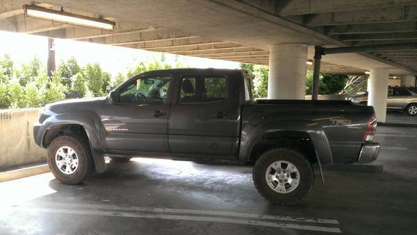

    Southern California
    09 Tacoma DCSB - TRD O/R
    Stubbs HD-SKO sliders, OME kit w/ 885s and Dakar leaf pack, LR UCAs, 265/75 MTR w/ kevlar.
    OME Kit, 885s with trim packer for taco lean, no spacers. Sport shocks all around with Dakar leaf pack in the rear. The front came up more than I was expecting, but it looks good and doesn't bother me one bit. Went with LR UCAs just to be safe. Loving the ride so far. Tires are 267/75 MTR w/ Kevlar.
