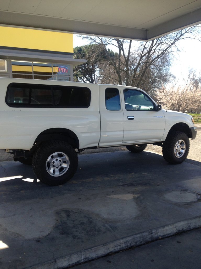

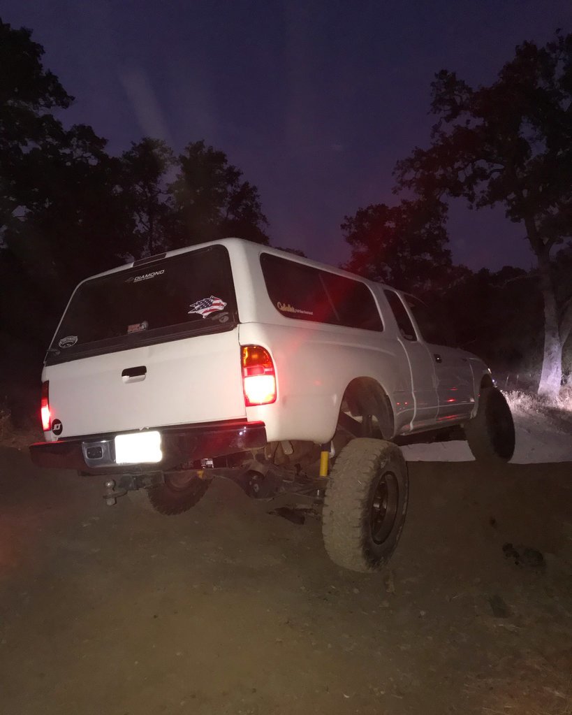

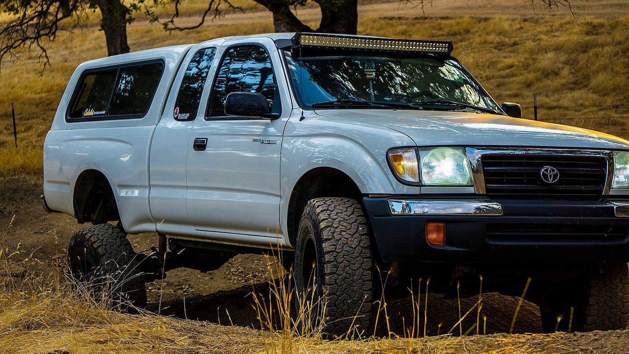

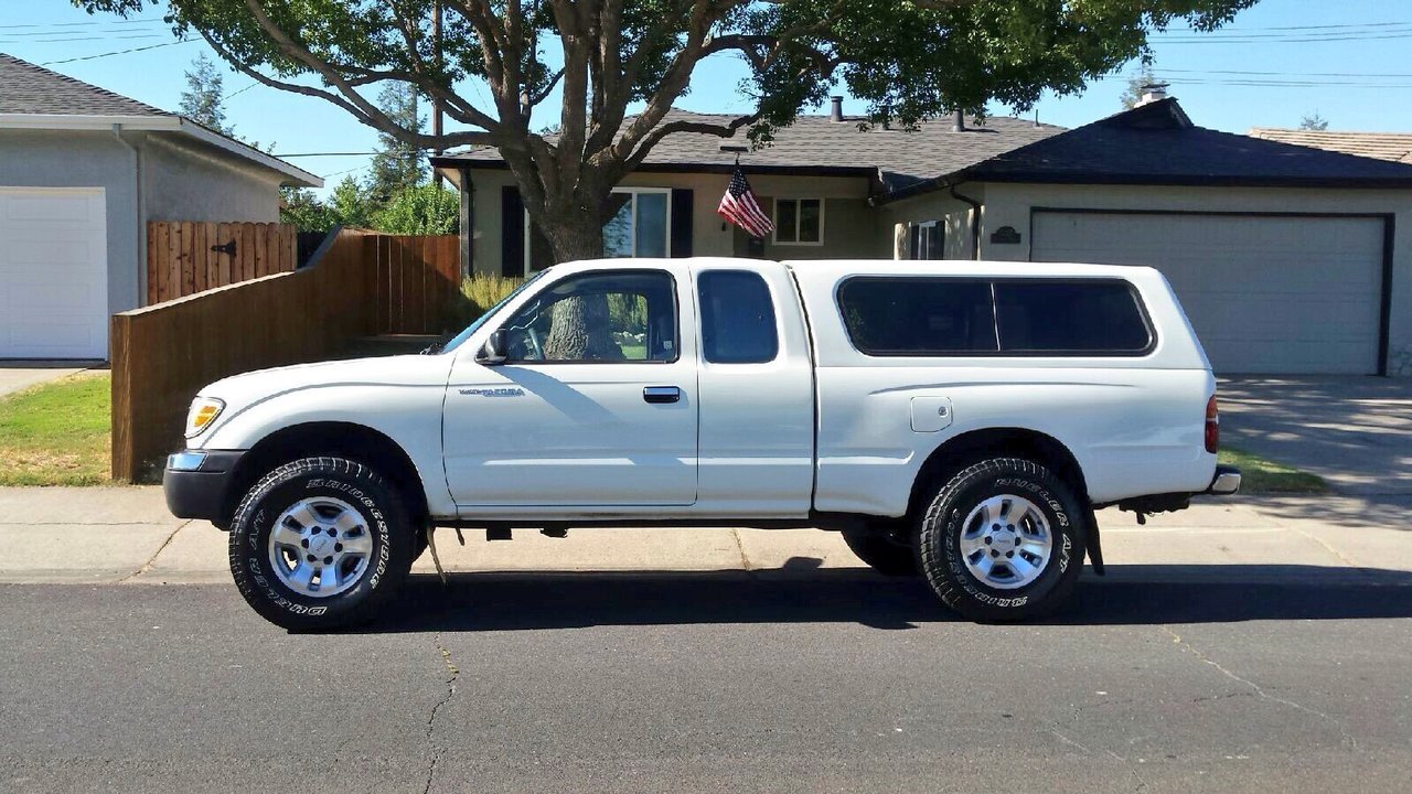

    I ordered my suspension from wheelers. Old man emu 882 coils up front and dakar lead springs in the rear. $1300 shipped, I got the 882 coils because I plan on adding weight in the front (bumper/winch). They offer 883 coils for a good amount of weight and 881 for basically stock weight. My 882s are a little stiff but bearable and they gave me about 3.5” after they settled and will settle more when I add more weight. As for the Dakar’s I’m very pleased I got them, worth every penny with their performance.

    First off nice truck. Are the top 2 pictures stock and the bottom 2 with the lift? if so could you maybe post a side view of your truck lifted on flat ground. what size tires are you running? Second, how rough actually are the 882's with no steel bumper? Reason I'm asking is because I honestly thought about getting 882s and building a steel bumper in the future but idk if I'm dead set on putting a steel bumper on or not and by the time I actually decide a tube bumper might be thrown in the mix (although if I were deciding today there would be no chance of that).
    I'm leaning towards replacing my rear leafs with Dakar's along with the extra OME leaf and then doing bilstein 5100's around. 1 reason for the bilsteins is I have a serious vendetta against any shock that utilizes that hard stiff style shock boot like the nitro chargers. The edges always seem to rust out and end up looking like complete trash before the shock is even close to be worn out. Second is that given my predicament above about the steel bumper or no steel bumper in the future I'm thinking that I could maybe utilize my stock front coils for the time and maybe when I get closer to the point of deciding, switch out the coils for OME coils (either 881's or 882's) and set those coils on the stock setting of the 5100's. Does this seem like an impractical or bad idea?
