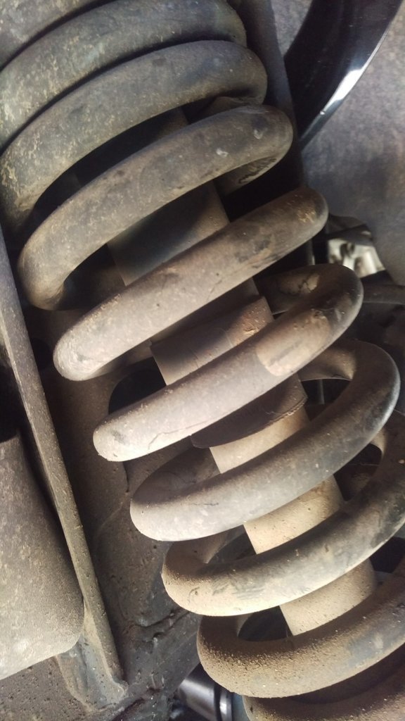

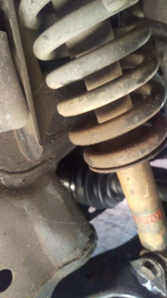

    Wanted to confirm I need new coils when I replace shocks. I think i know the answer but wanted to confirm. Attached are a few pictures of my coils(1999 tacoma). I bought the truck used @ 260k and put about 7K on it so far. Ride is quite rough on bumps.
    I suspect I need to replace them at same time as shocks given how compressed they look parked but wanted confirmation before I wasted money.

    With 267K Miles on the truck, you are definitely not wasting any $$ getting new shocks and coils.

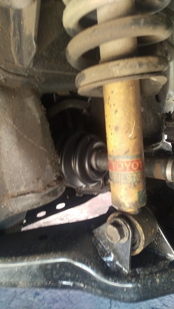

    the lower bushing on that shock is toast

    Well... what's left of it at least.

    Thanks for the confirmation. I'm just getting into working on my truck but the bushings looked dead to me too. Suspension needs some love.

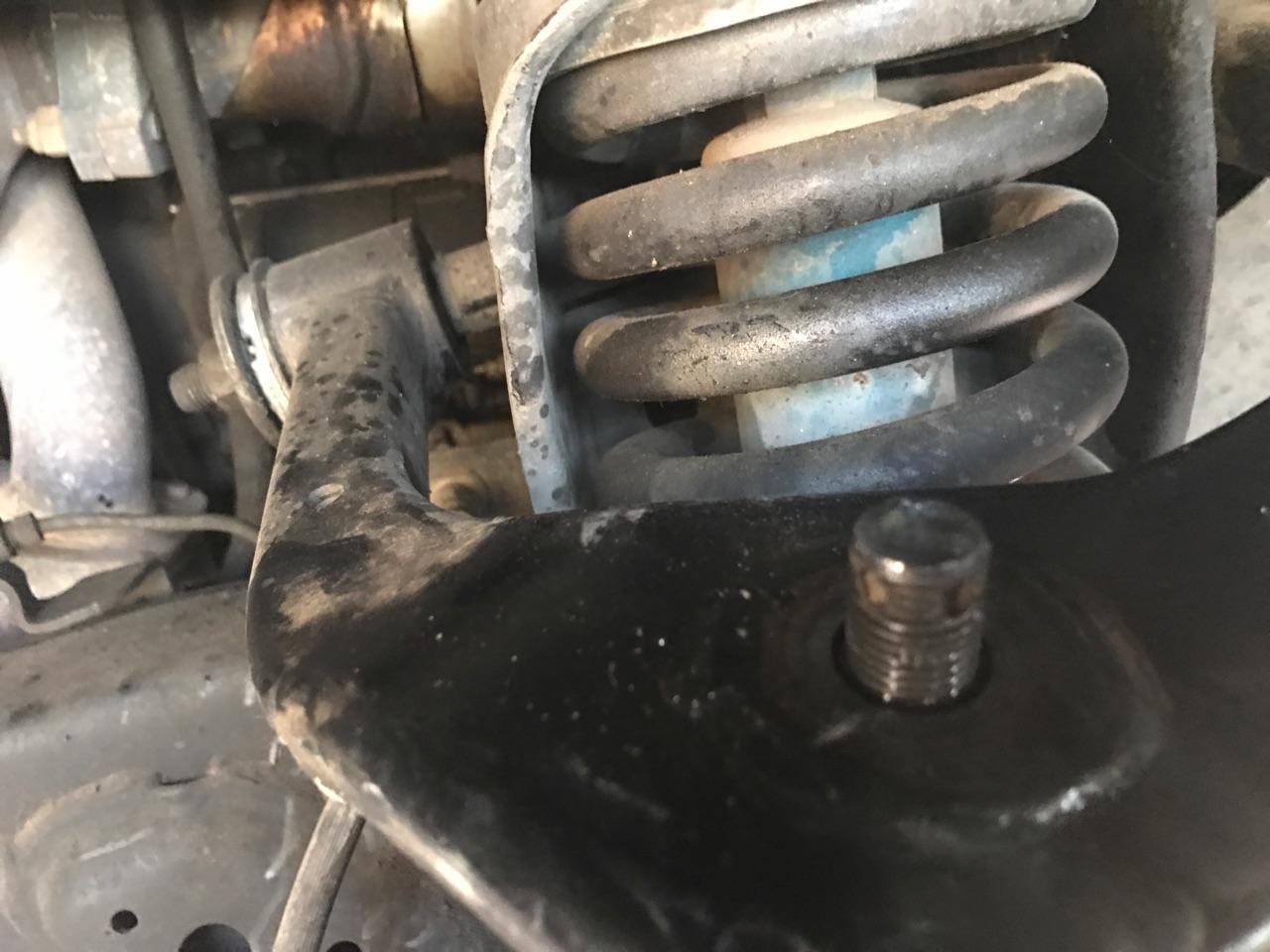

    Replaced lower ball joints already and trying to replace upper. Cant separate UCA and balljoint for the life of me. Boot was torn already but is now demolished. 4hours at least yesterday. At first I thought maybe I needed to hit the gym but then I snapped my picklefork using a cheater bar. Tried a prybar briefly. Hit it with a 4lb mini sledge till i was sore. Top of stud is a little bent near cotter hole now.
    Tried lots of WD40 rust penetrate. Gently heated it with a propane torch toward the end but am wary of heating suspension metal unless other think this is reasonable. I dont see how people are getting these out with a fork easily.
    This form member looks to have had an almost identical issue but never returned to say if/how he got it off.
    https://www.tacomaworld.com/threads/removing-upper-ball-joint.301174/
    KenLyns had said "Get a pitman arm puller: ". Which I'm going to be trying in the next few hours.
    Any advice is appreciated. Ill post back if I fix it.

    Got them separated with a 7ton reversible puller 27271 and an adjustable wrench(no headroom whatsoever due to long center screw so ratchet would not fit). Now im finding after i returned it the 4x4 adapters dont fit in the area with the standard tool screw bolt. its just too long at full extension to fit in wheel well. (half way in is the upper section).

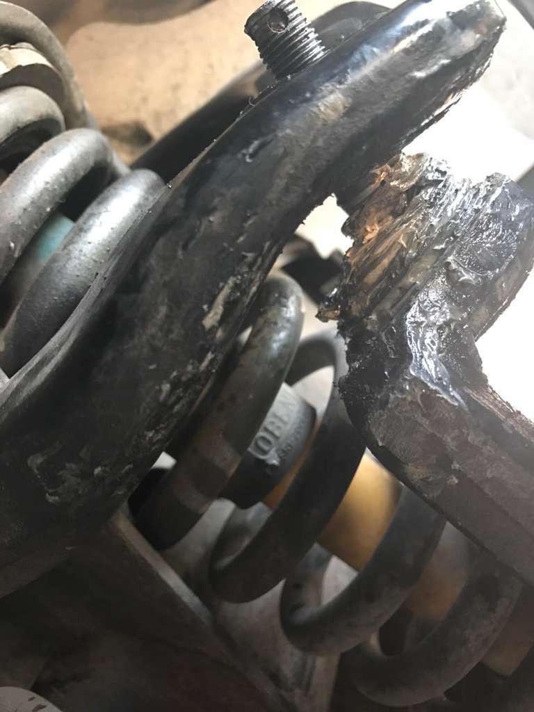

    Completed, and more problems ensue. Angle ground bolt off. With a shorter press screw bolt this could have been avoided. Pressed out with 3 jaw puller and a second pair of hands(key, did not have first time). Pressed back in and popped CV axle out at the same time; Or at least there was a pop that we both agreed was the CV as we flexed the spindle outward too far when pressing in upper ball joint with wrench). Watching cv replace videos right now.
