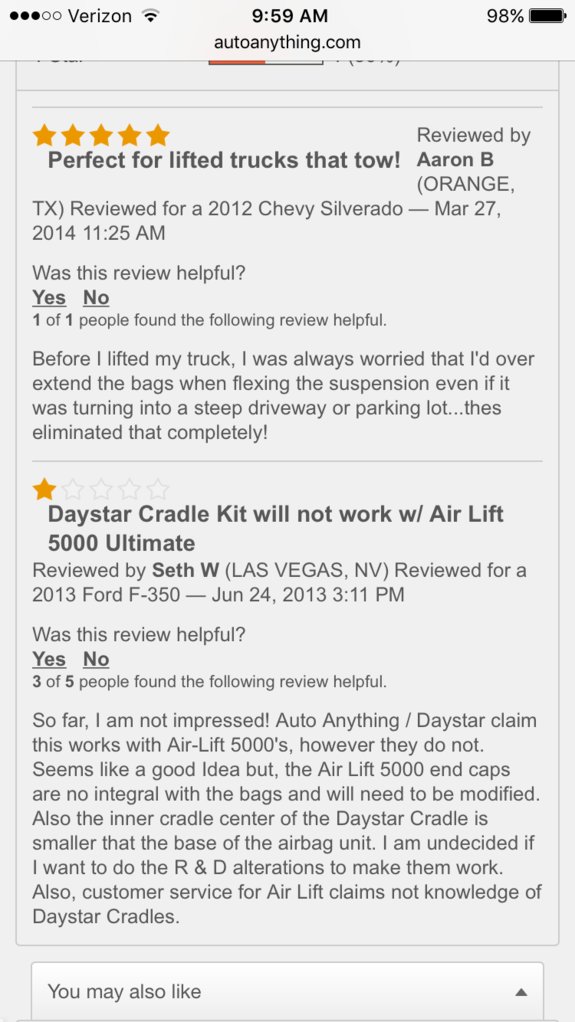

    I read somewhere that voids the warranty of the Firestone kits, and maybe others(?). That those (2) reviews aren't encouraging...
    That's certainly the way to go to get full articulation, though.
    eccracer104[QUOTED] likes this.

    It would be a solid pair and support the added weight without needing new leaf springs. You can adjust the air pressure to make the ride firmer or softer. The cradles will allow the bag to lift off the axle when you're articulating the rear suspension.
    Hmmm... possibly. I haven't looked into the warranty with the addition of those cradles.
    There's one 5 star review and one 1 star. Neither on a Tacoma and the 1 star is because they didn't work with the larger 5,000 bags.
