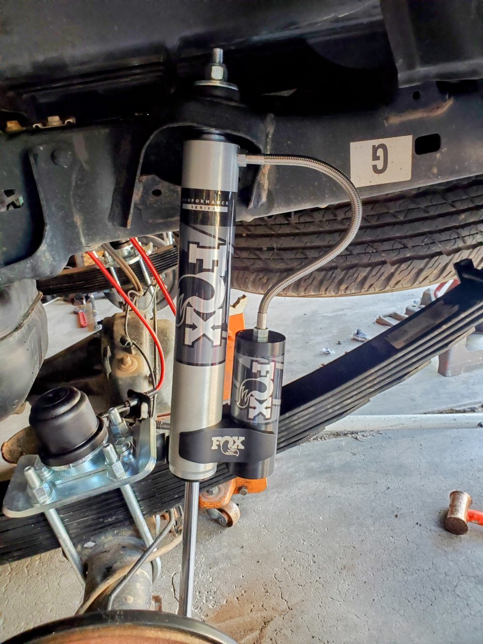

    For what they are? They are Fox coils/shocks that have been R&Ded to perform off-road and ride amazing on road. Ive seen them go for around $900 for coils and rear shocks. They are by far better than most Bilstein, OME, Toytec kits people install. OP said small lift and comfort. That's what these will achieve.

    Yeah that's pricey. I would really look into a low mileage kit someone replaced. At OEM prices you might as well go aftermarket kit. I run fox 2.0s up front. They give 2" lift and ride really good. Around $1000 for the front.

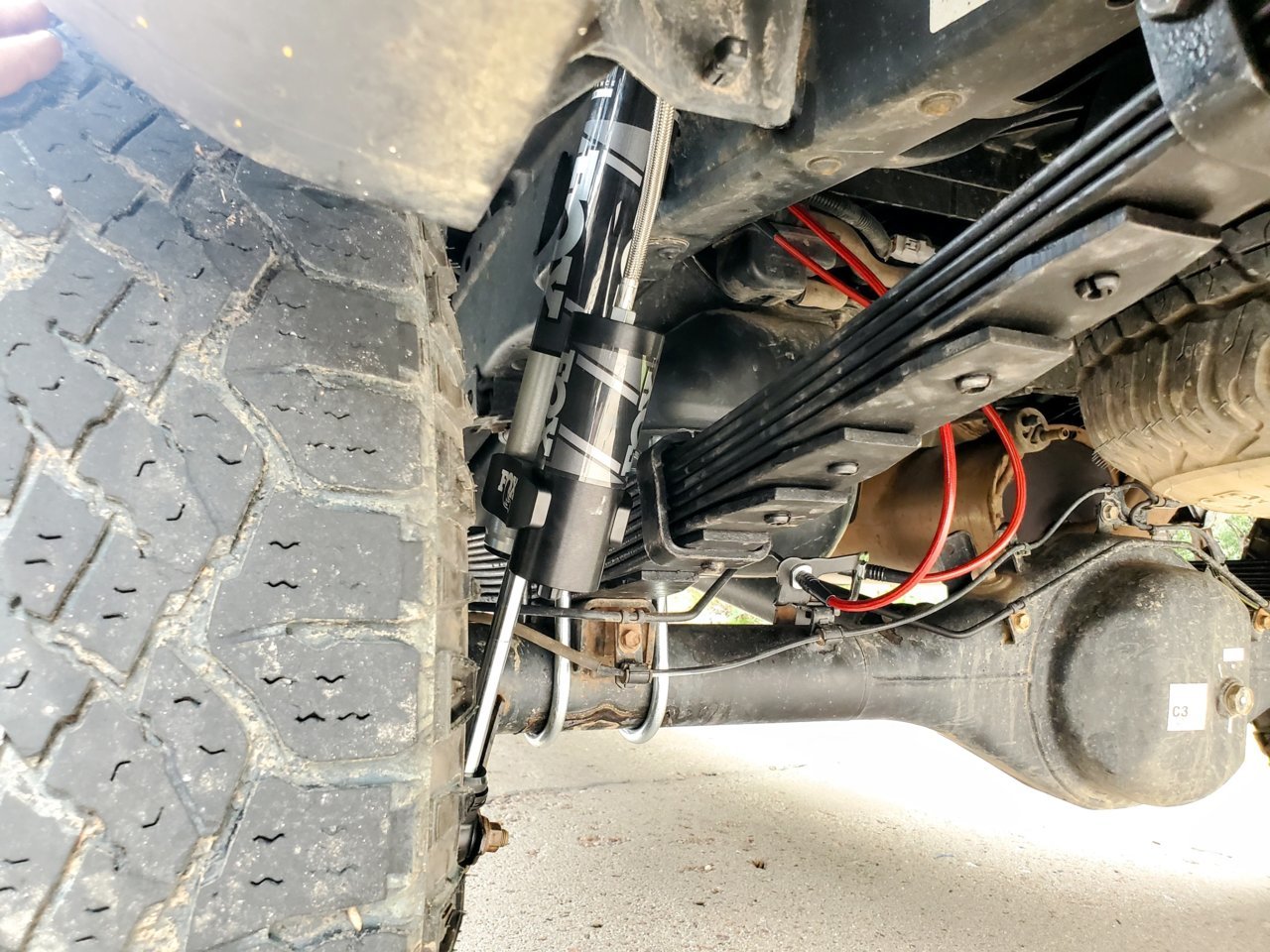

    I did all pro expedition leafs because they were a good price, super flexy, 4" lift and handle 500lb weight while still holding 3" lift. But they lose their paint and rust quickly. They also have 2.0s that handle 1000lbs now. Then I have extended travel fox 2.0 with resi, wheelers ubolt flip kit, superbump stops and extended brake lines.
    The icon RXT leaf pack is adjustable because you can remove and add leafs. They seem to not rust and people love them. Also a good price.

    Deaver U402 expedition stage 3 is rated for 3 inches lift @ 700 to 1000lbs. I sit at about stock height with my Deavers with 2000+.
