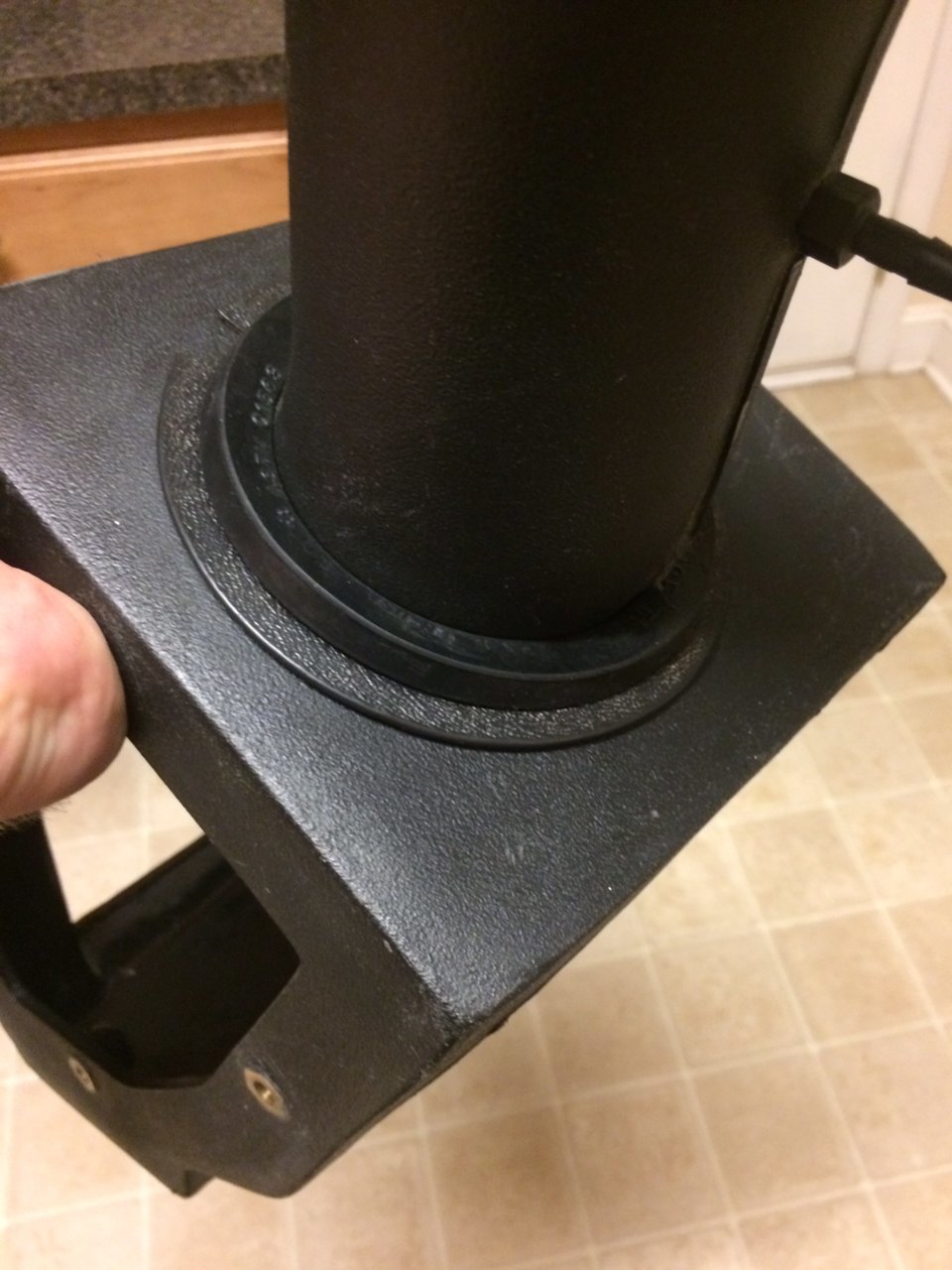

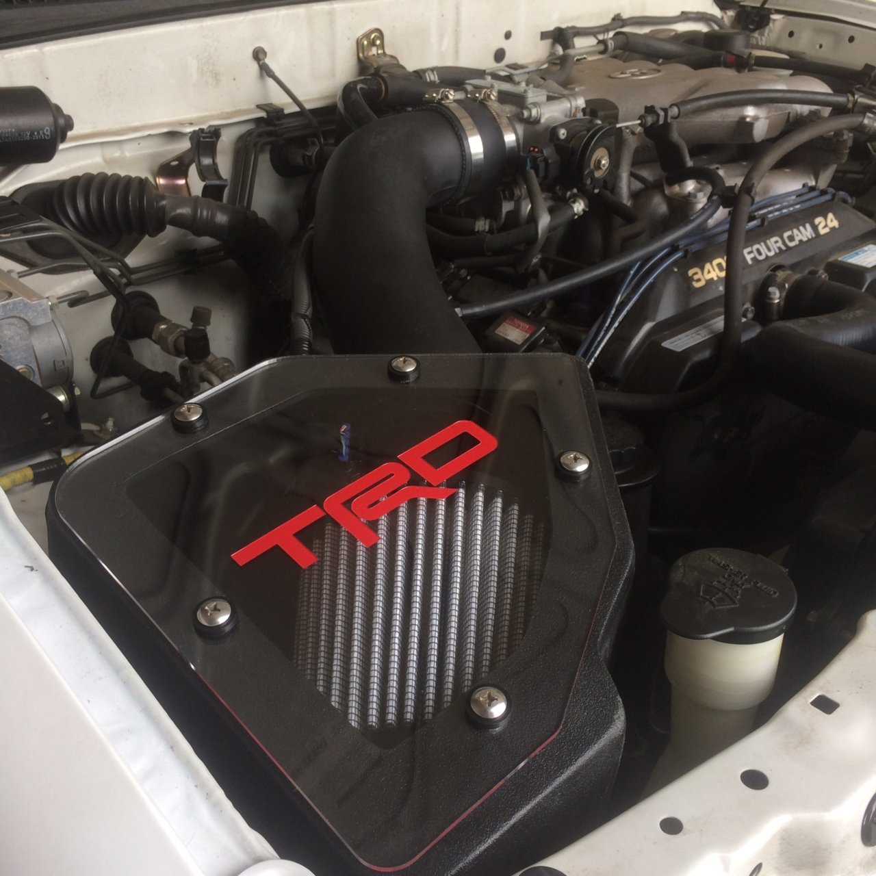

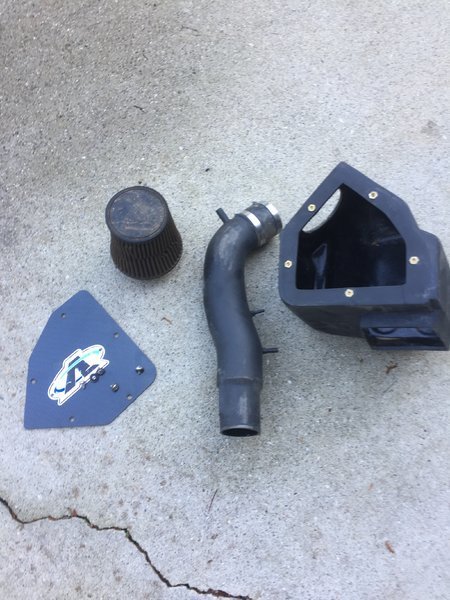

    Engine

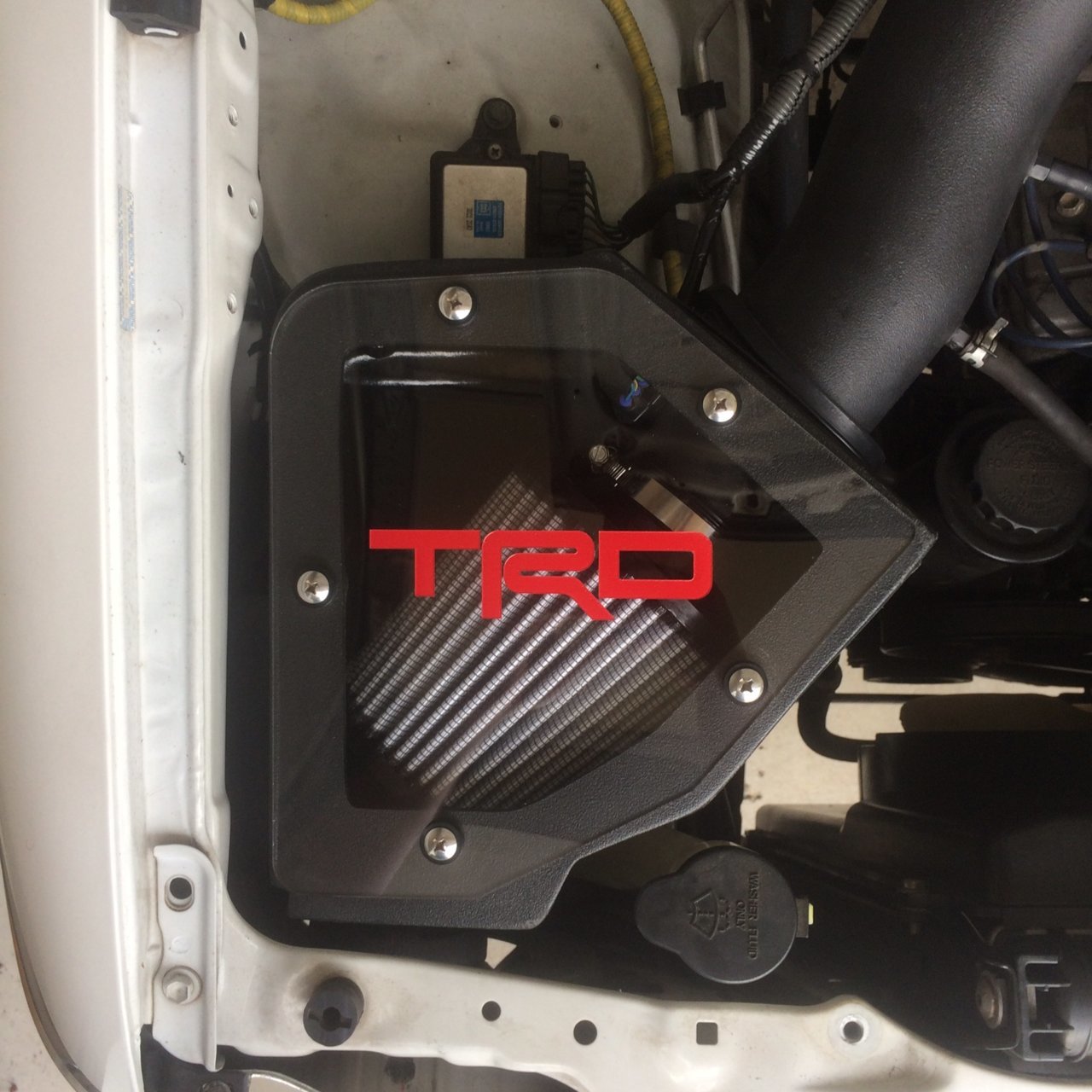

    Cold Air Intake - Volant Performance - Part # 18634 (1999-2004 Toyota Tacoma 3.4L V6 Cold Air Intake)
    Conical Dry Air Filter (no oiling required) - AFE Power - Part # 2199999 (Custom Build Your Own Filter)*
    *dimensions for a custom Pro Dry S filter were sent to AFE since Volant only sells filters that require oiling.

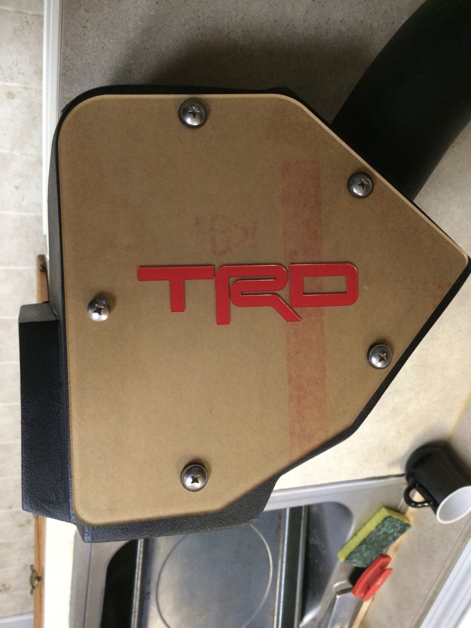

    TRD Cold Air Intake Cover - @Coupe - Part # N/A (Acrylic Cover for Volant CAI with TRD logo)

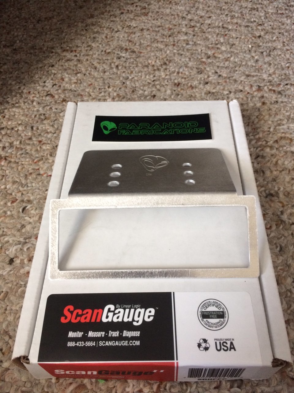

    OBD Reader Mount - Paranoid Fabrications - Part # Unknown (1st Gen Tacoma Ashtray ScanGauge II Holder)

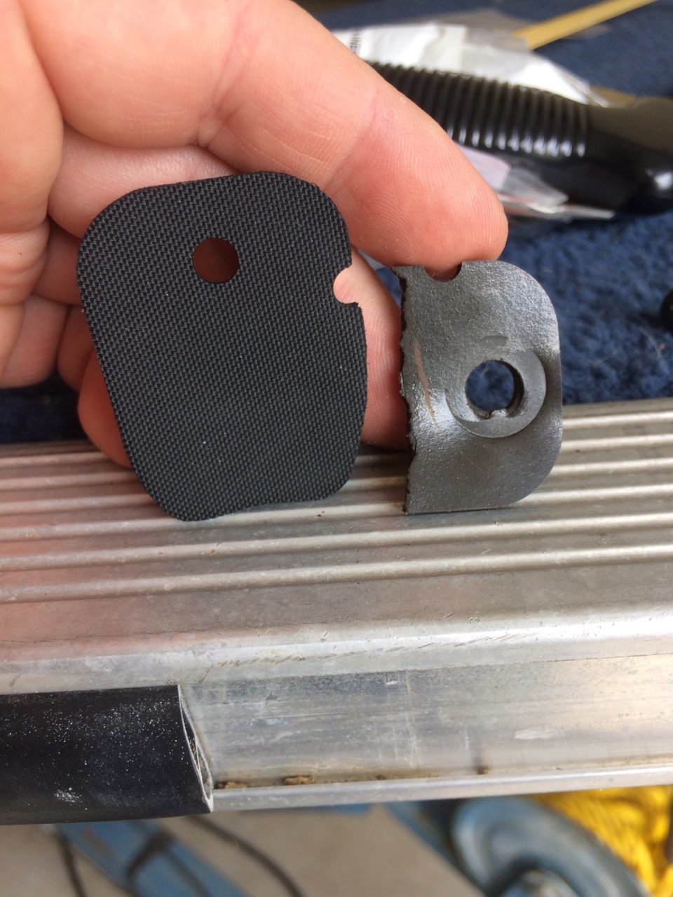

    Driver's Seat Side Trim Reinforcement - @mechanicjon - Part # N/A (1st Gen Tacoma Seat Trim Side Cover Reinforcement)

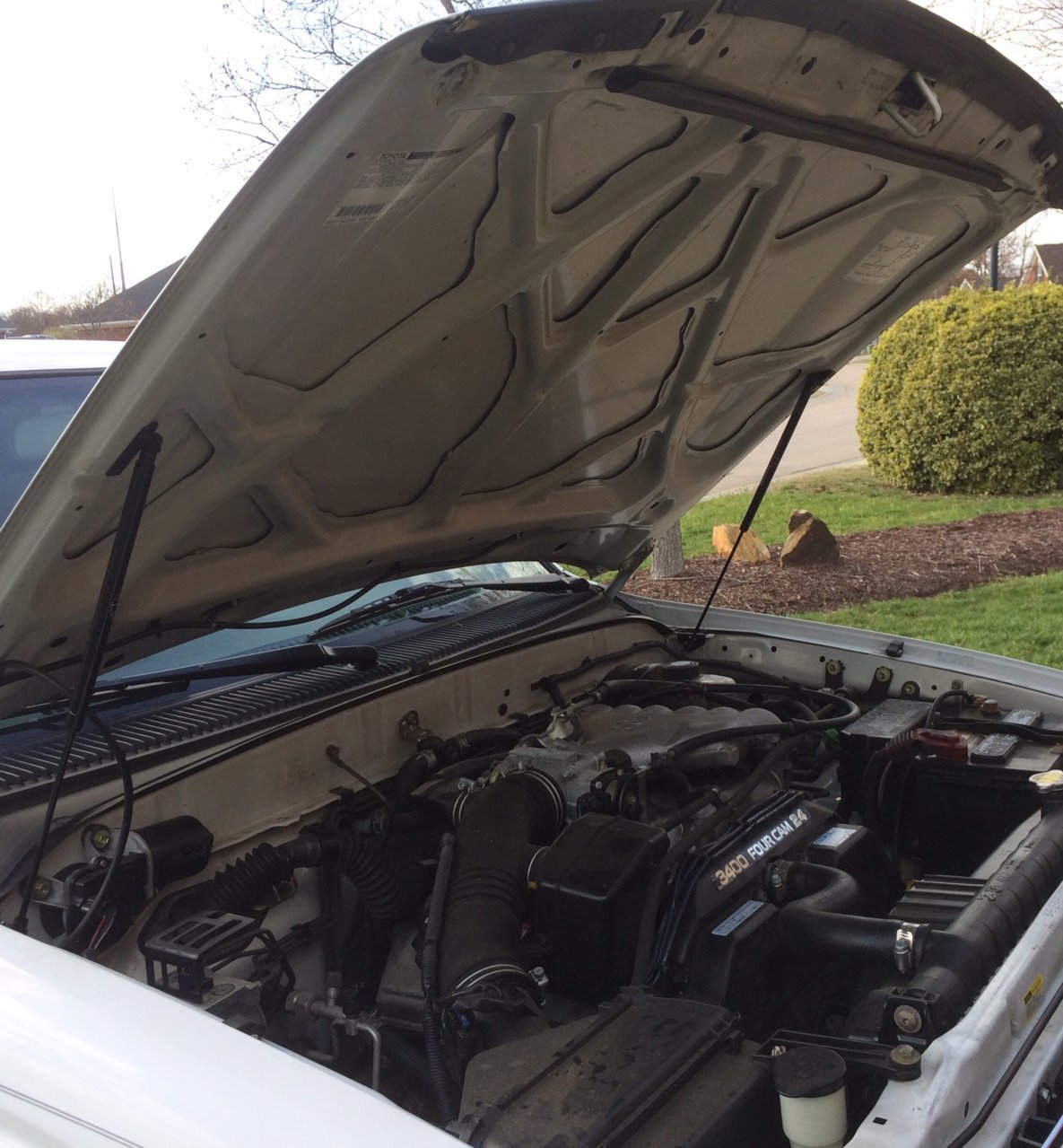

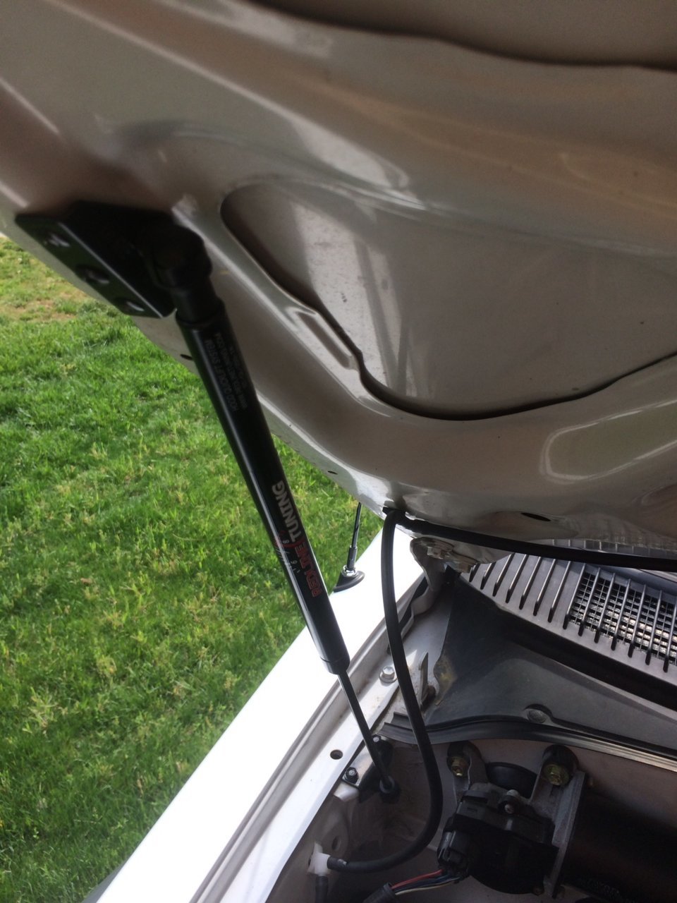

    Hood Struts - Redline Tuning - Part # 21-27009-02 (1995-2004 Toyota Tacoma Hood QuickLIFT Plus)

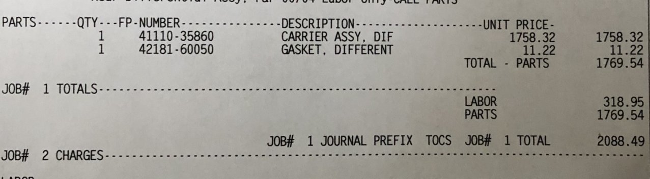

    Rear Differential Assembly Replacement - 03.01.2016 - Hendrick Toyota of Concord (157,023 miles)*
    *Parts replaced included Carrier Assembly, Differential (41110-35860) and Gasket, Differential (42181-60050).

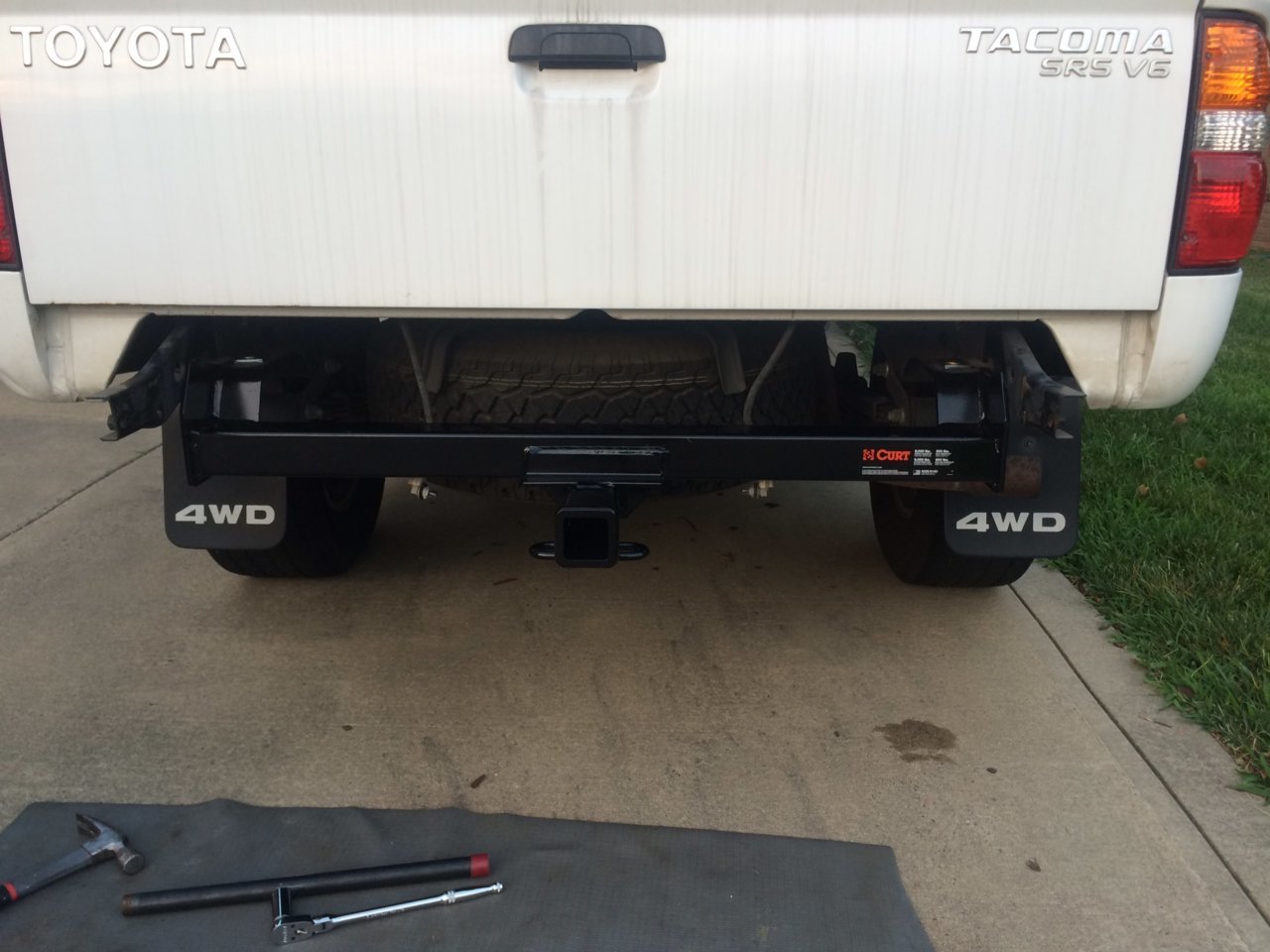

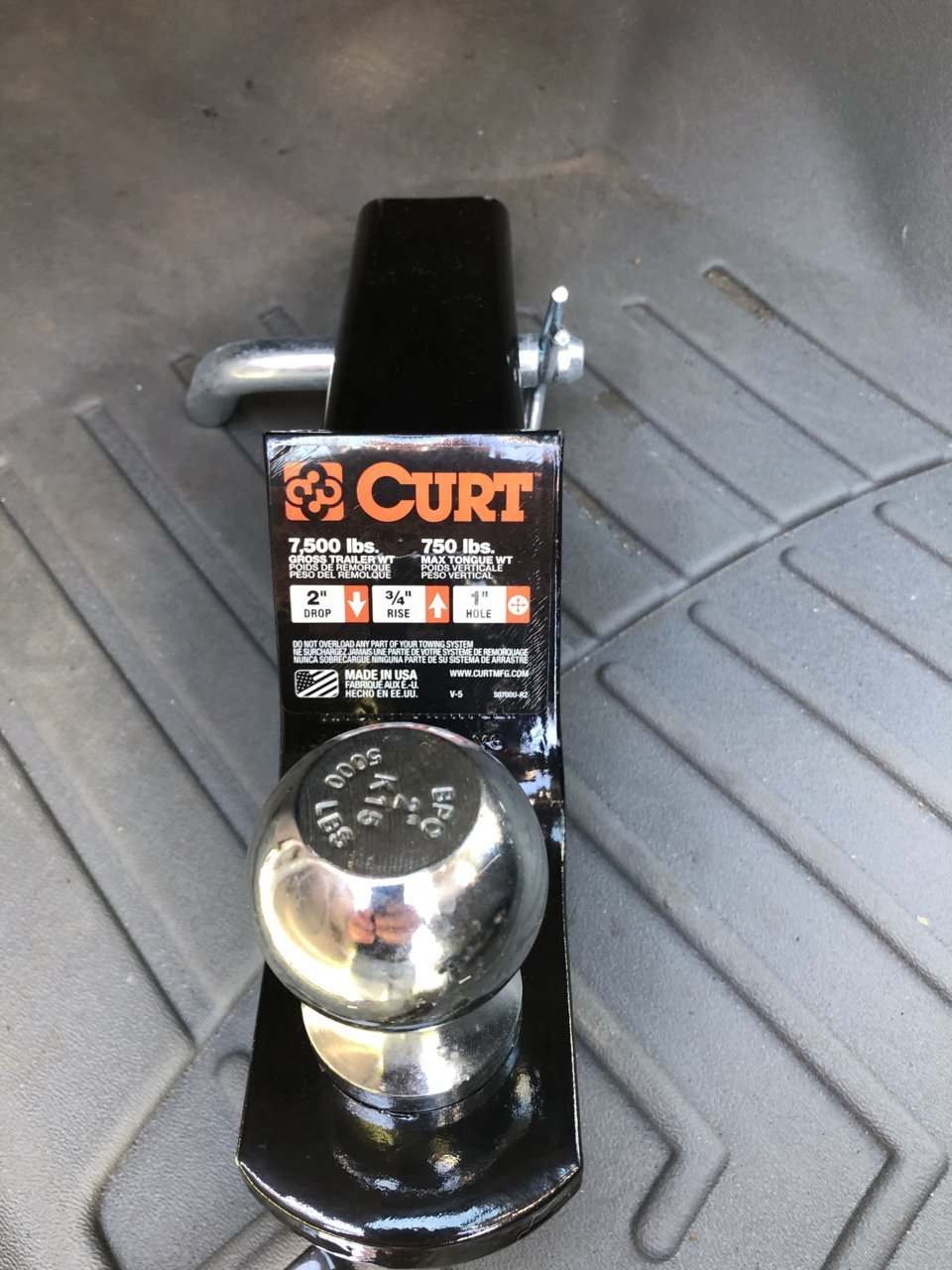

    Trailer Hitch, Wiring Harness and Trailer Ball Installed - 06.25.2016 - Me (Mileage Unknown)*
    *Parts installed included Curt Manufacturing Class 3 Trailer Hitch w/ 2" Receiver (13013), T-Connector Vehicle Wiring Harness with 4-Pole Flat Trailer Connector (55379), Connector Mounting Bracket for 4-Way Flat Connector (58301), Ball Mount for 2" Hitches, Class 3 (45030), 2" Rubber Hitch Tube Cover (22272) and a 2" Trailer Ball from an unknown manufacturer.

    Hood Struts Installed - 03.25.2017 - Me (Mileage Unknown)*
    *Parts installed included Redline Tuning QuickLIFT Plus Hood Struts w/ Gas Springs (21-27009-02) purchased via Tacoma World Group Buy courtesy of @RedlineTuning.

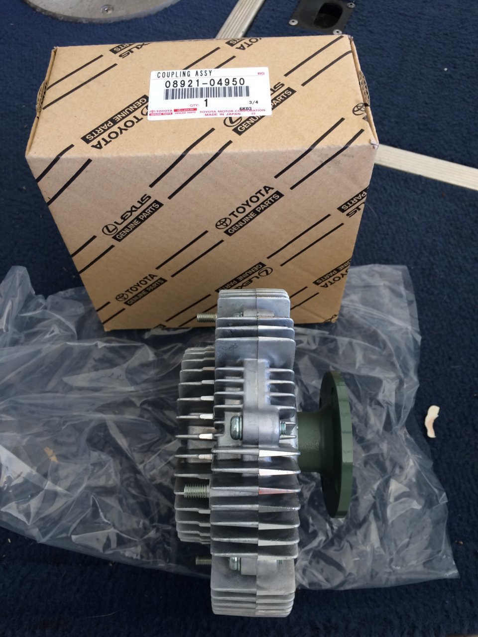

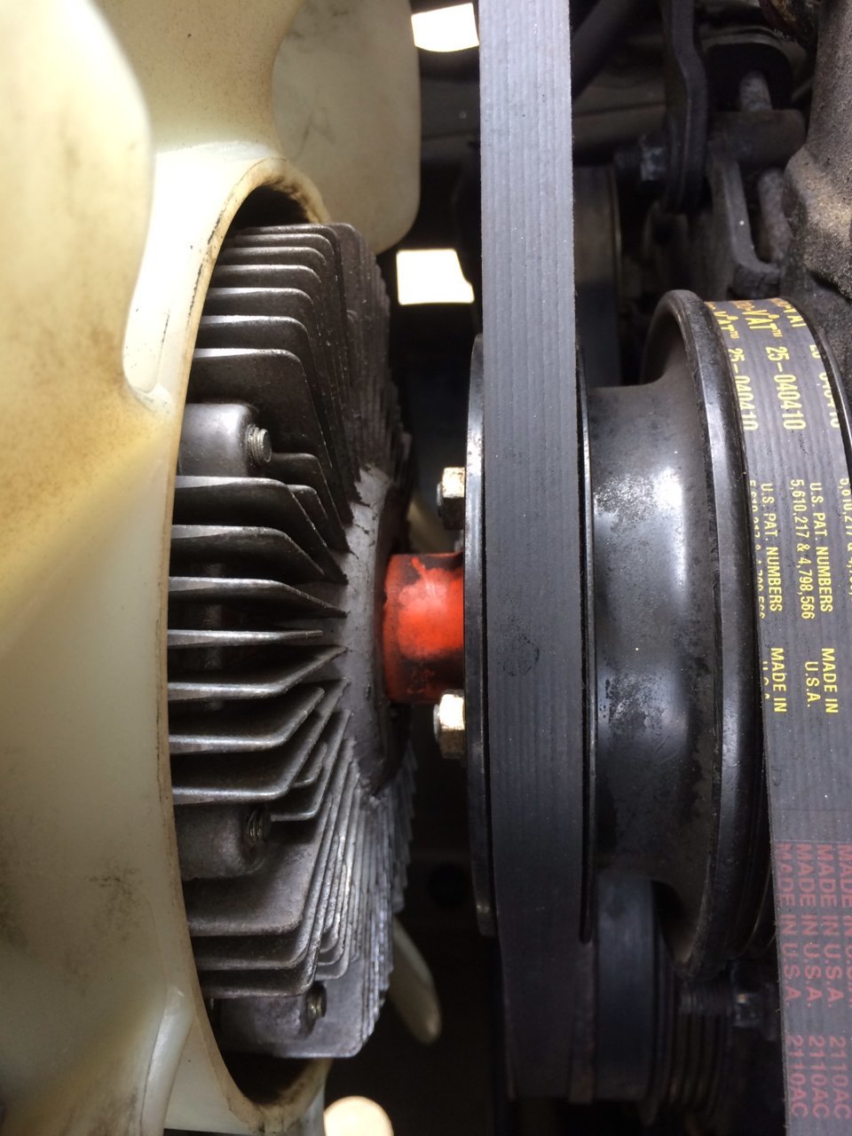

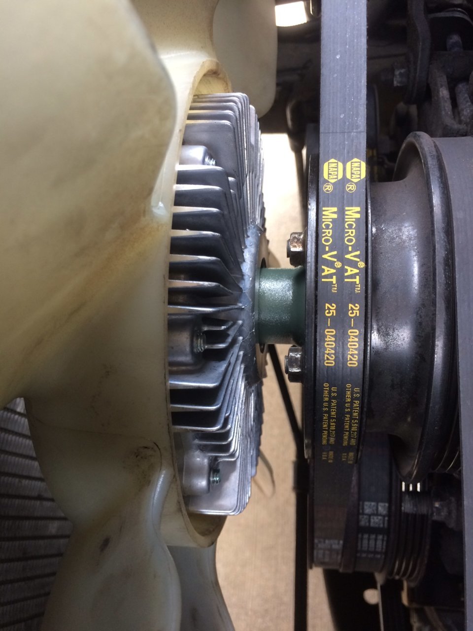

    Heavy Duty Fan Clutch Replacement - 04.21.2017 - Me (162,768 miles)*
    *Parts installed included Fan Clutch (08921-04950) purchased from McGeorge Toyota Online Parts.

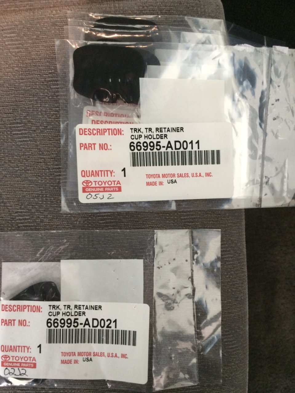

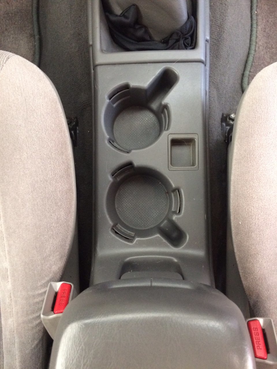

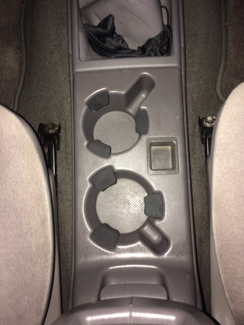

    Console Cup Holder Repair - 05.25.2017 - Me (Mileage Unknown)*
    *Parts replaced included Retainer, Cup Holder (66995-AD021 x 1 each) and Retainer, Cup Holder (66995-AD011 x 4 each) purchased from Camelback Toyota Scion via @gunny1005.

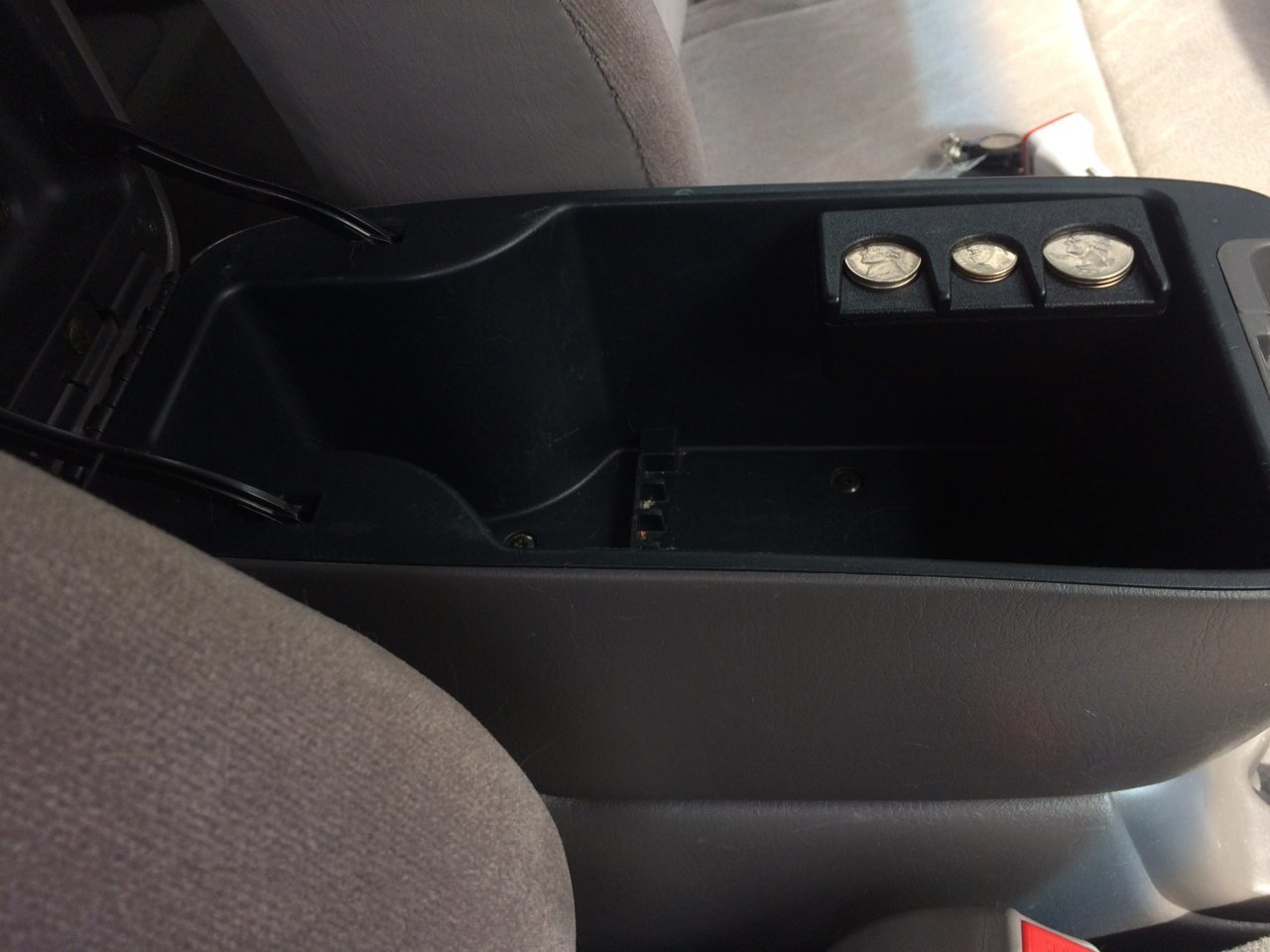

    Coin Holder Replacement - 06.01.2017 - Me (Mileage Unknown)*
    *Parts replaced included Console Coin Holder (55450-0C010) purchased from @License2Ill.

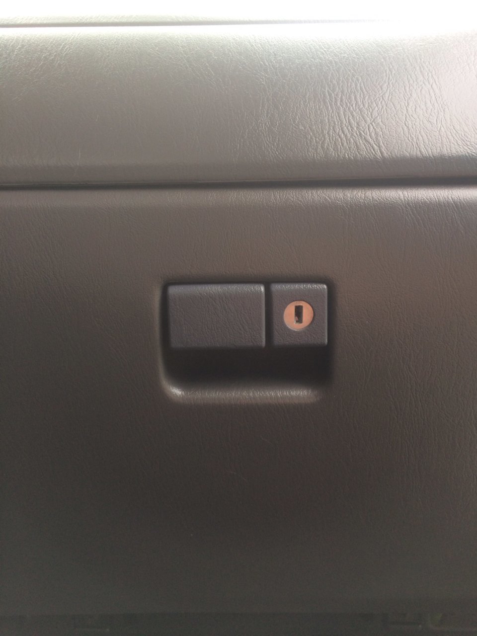

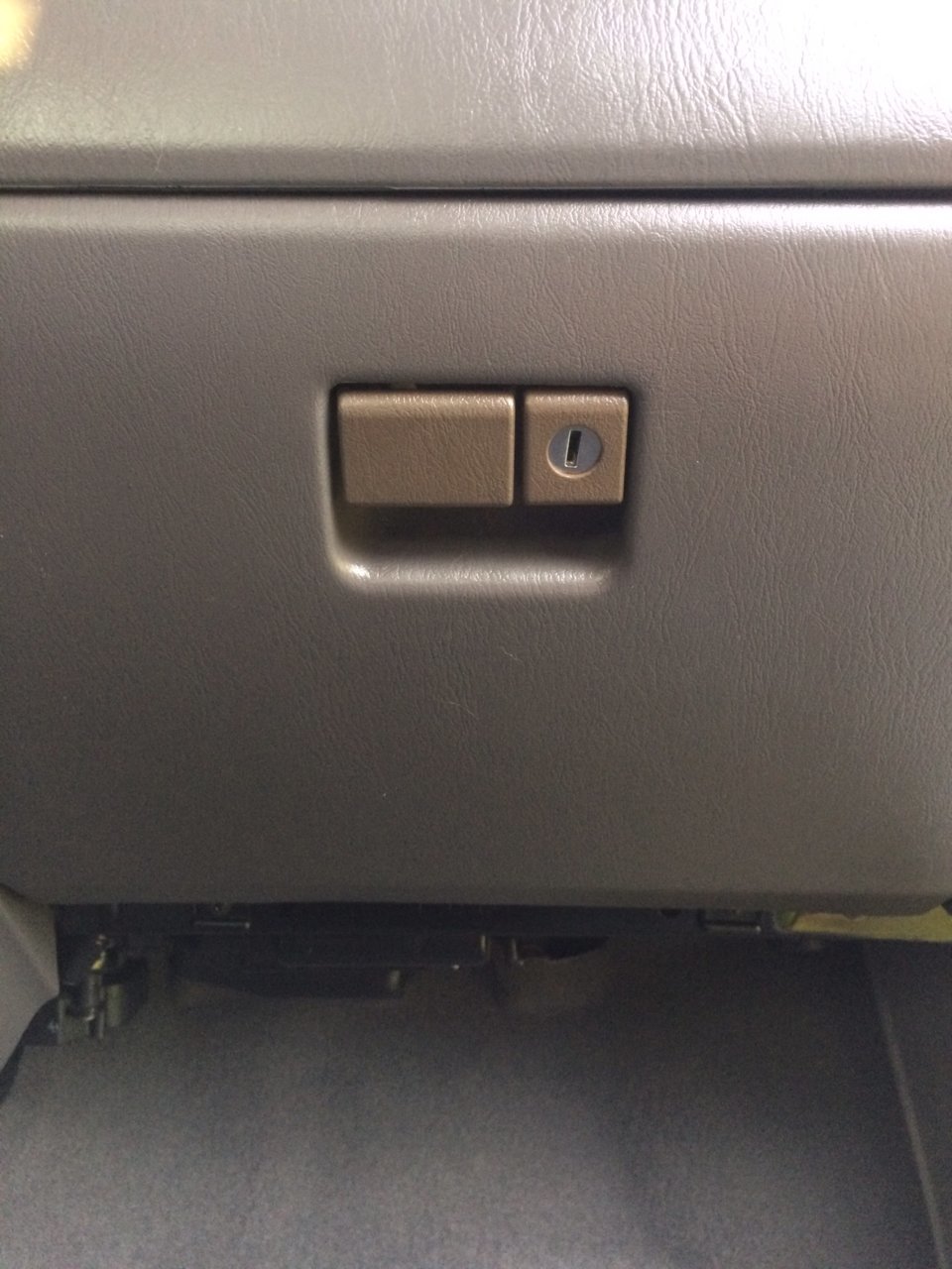

    4Runner Locking Glove Box Mechanism Installed - 07.07.2017 - Me (Mileage Unknown)*
    *Parts replaced included Lock Cylinder (69056-60080) purchased used from eBay.

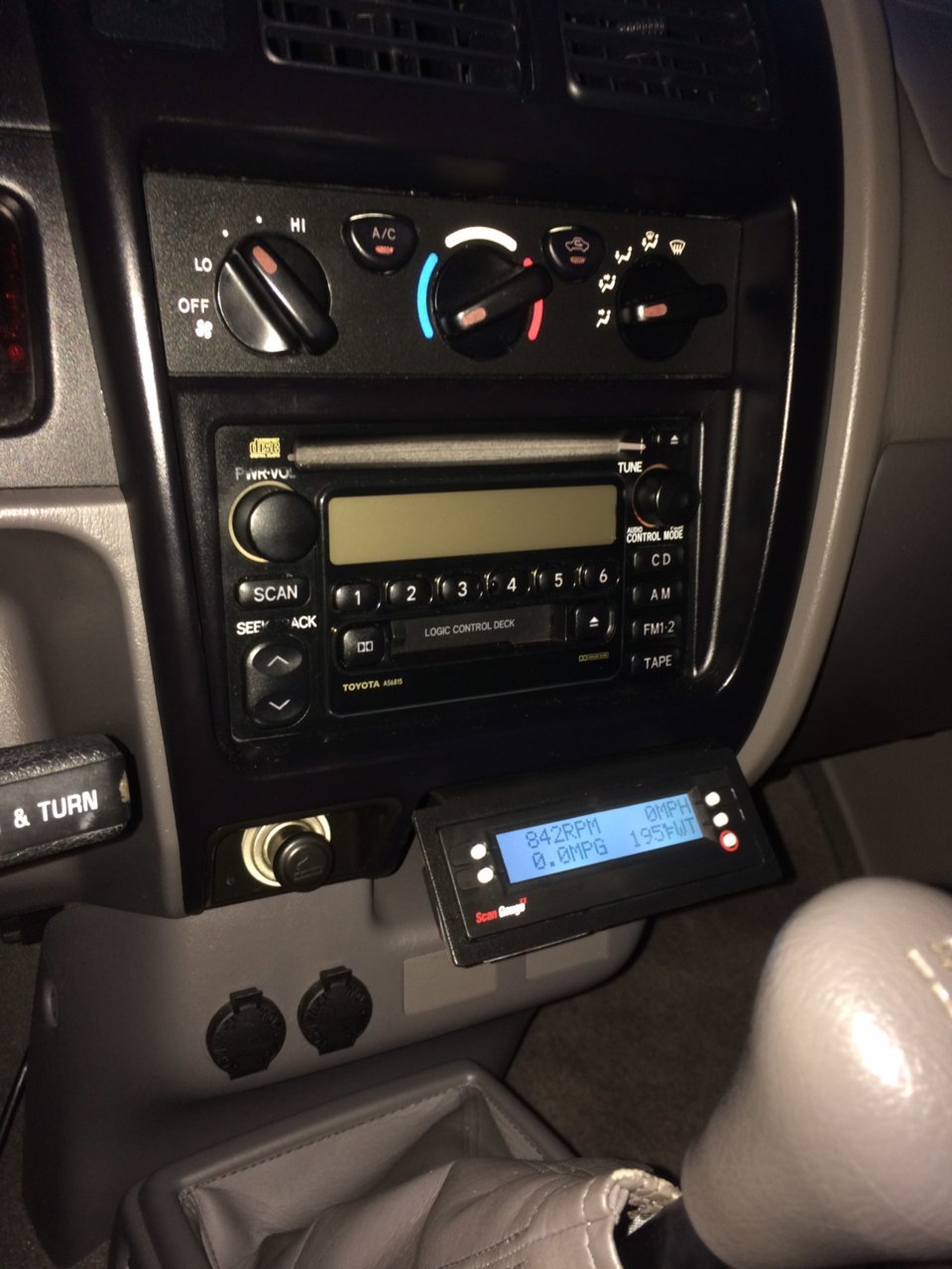

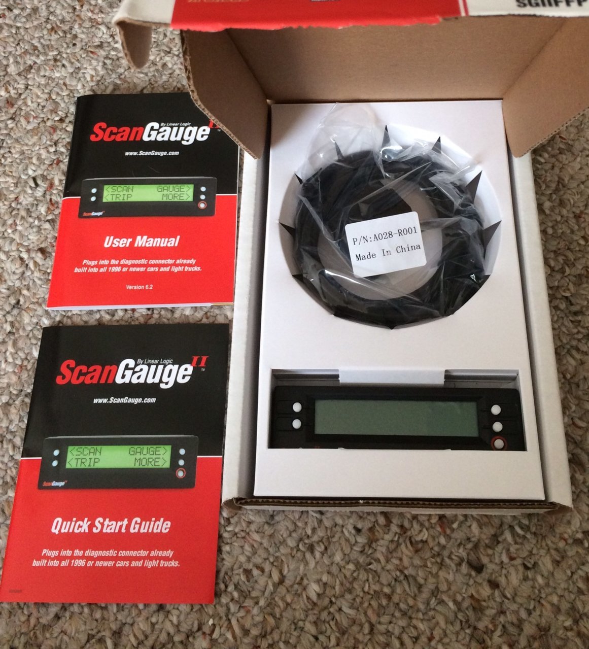

    ScanGauge II and Paranoid Fabrications Ash Tray Mount Installed - 07.24.2017 - Me (Mileage Unknown)*
    *Parts installed included ScanGauge II (SG2) purchased from Amazon and 1st Gen Tacoma Ashtray ScanGauge II Holder (No Part Number) purchased from @paranoid56 Paranoid Fabrications.

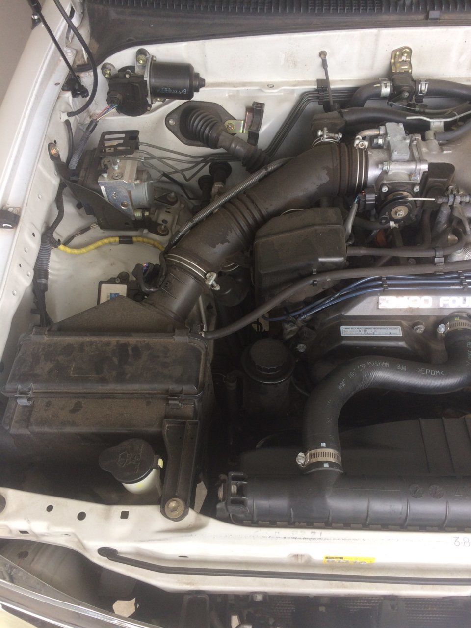

    Cold Air Intake Installed - 08.13.2017 - Me (Mileage Unknown)*
    *Parts installed included Volant Cold Air Intake (18634) purchased from @BYJOSHCOOK, AFE Custom Conical Pro Dry S Filter (21-99999) and an Acrylic CAI Cover with TRD Logo (custom part purchased from @Coupe).

    Driver's Side Seat Trim Reinforcement - 09.13.2017 - Me (Mileage Unknown)*
    *Parts installed included 14ga Driver's Side Seat Trim Reinforcement (custom part purchased from @mechanicjon).

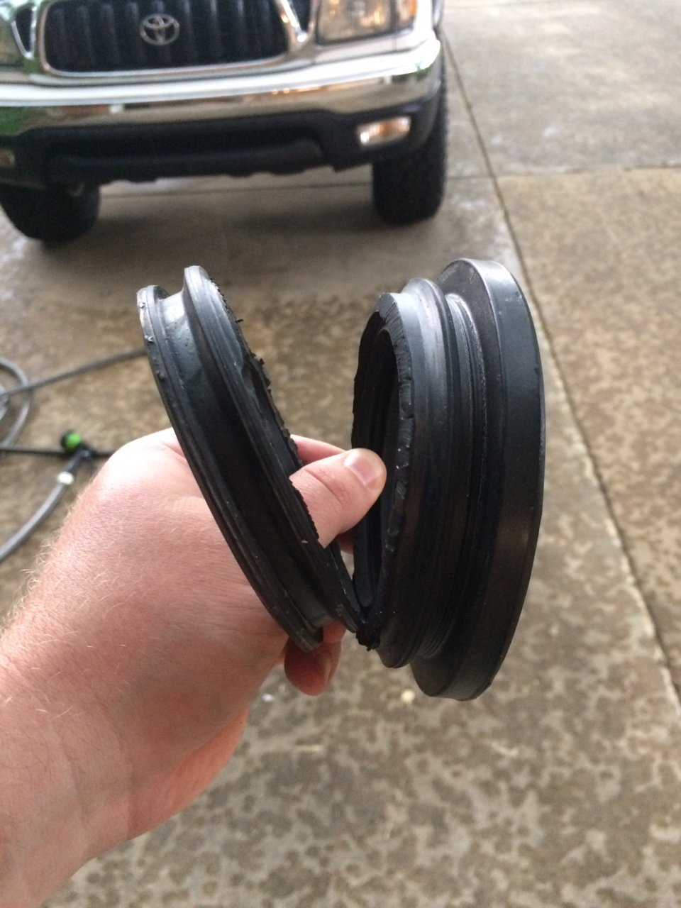

    Chasing a Noise
    Day 5 -
    July 2, 2015. The truck had what I thought was a bad wheel bearing, there was a howl coming from the rear end that increased with acceleration. I took the truck to a recommended mechanic who thought the same. The rear driver's side wheel bearing was replaced but the noise remained. At that point the mechanic decided it was the rear differential and quoted service. Conveniently he claimed the rear wheel bearing had needed to be replaced too.
    Confirmation
    Day 181
    - November 23, 2015. The truck wasn't purchased as a daily driver so I wasn't in a hurry to fork over a lot of money for rear diff work, and I didn't really trust the mechanic who replaced the wrong part on his first attempt. I took the truck to the dealership for it's free oil change and tire rotation on November 23, 2015. I decided to have Toyota perform their own diagnosis. Toyota confirmed that it was indeed an "Interior failure of rear differential assembly."
    An Expensive and Regrettable Fix
    Day 280 - March 1, 2016. The quoted repair from Toyota was high and meant that I had to wait until I got my tax return to have the rear differential fixed. On February 29, 2016 I dropped it off at Hendrick Toyota of Concord to have it fixed. The next day I had a truck with a new rear end. The regrettable part of this service was at the time I had no idea what mods would happen to this truck, I hadn't gone down that Tacoma World rabbit hole. A couple years later I realized the truck could've been regeared to accommodate the additional weight and larger tires that it currently has for what was spent on factory gears. It is what it is.
    In case anyone was curious what a new rear end would cost using OEM parts and a Toyota Technician, well, here you go:

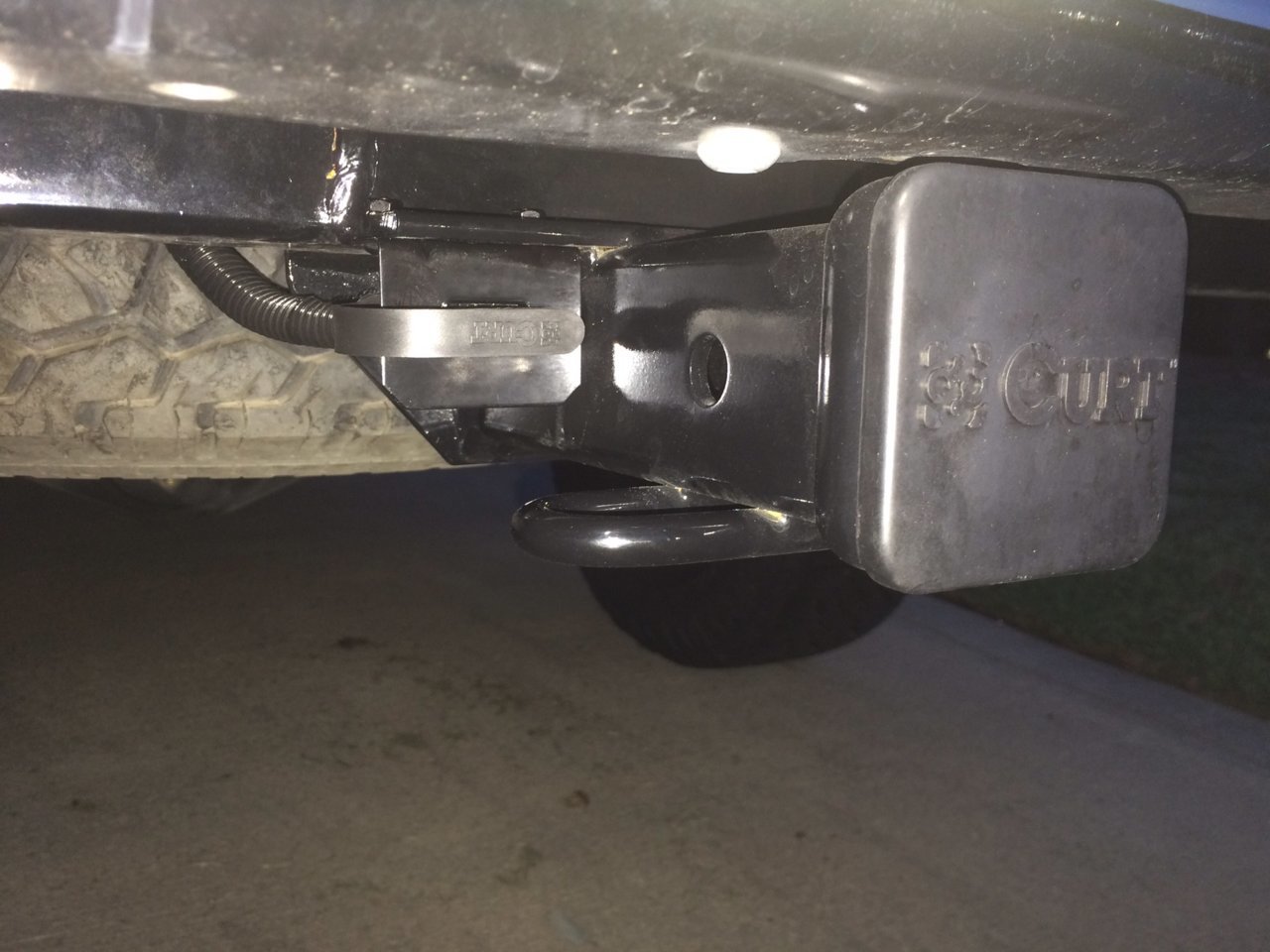

    June 25, 2016 - The first modification to the truck was for the boat. I added a Curt Manufacturing brand Class 3 Trailer Hitch with a 2" receiver (Part # 13013), Class 3 Ball Mount (Part # 45030) and a 2" Trailer Ball.
    For the trailer lights, I added a Curt Manufacturing brand T-Connector Vehicle Wiring Harness with 4-Pole Flat Trailer Connector (Part # 55379), the connector was attached to the hitch using a Mounting Bracket Connector for 4-Way Flat Connections (Part # 58301) and for days when the hitch wasn't being used a 2" Rubber Hitch Tube Cover (Part # 22272) was purchased from Curt Manufacturing.
    On December 28, 2019 all of this was removed as it was not compatible with the Relentless Fabrication bumper I added. In the 3 years and 6 months that this was on the truck the boat never left the garage and the towing accessories were never used which made it an easy decision to remove them.

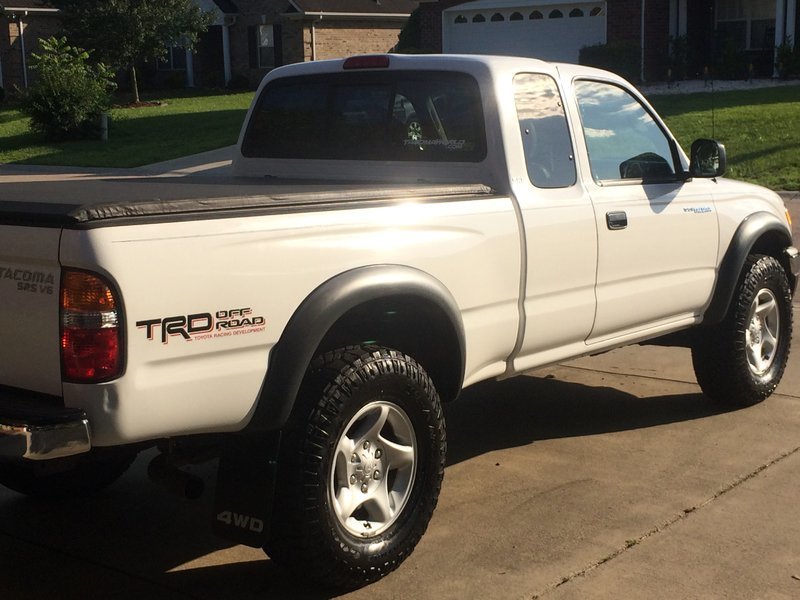

    July 29, 2016 - Purchased a set of Goodyear Wrangler Duratrac tires (Part # 150564601) from Goodyear and got the 3 Year Alignment program to keep them wearing right. I stayed pretty close to stock size with 265/70 R16.
    On May 29, 2019 these were removed and replaced with a larger tire and wheel. They had 11,114 miles on them and were aligned regularly. As of February 17, 2020 they are still sitting in the garage next to all the Curt towing equipment mentioned in the previous post. I need to sell some stuff.

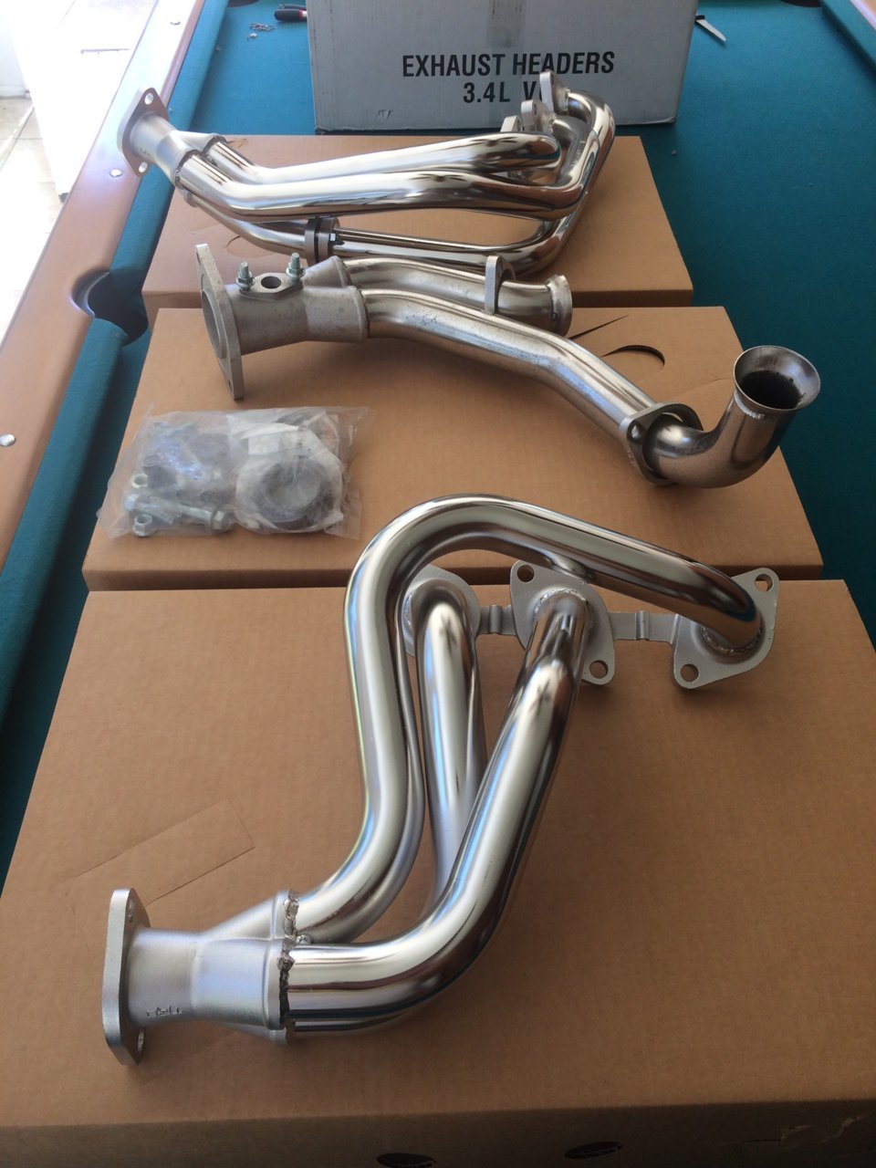

    February 17, 2017 - If there is one common theme with the modification of this truck and me it's procrastination. I'm good about buying a part then letting it sit for a while before I get around to putting it on. There's no better example of that than the TRD Headers. In February 2017 I was looking around the internet and found a set of TRD Headers for the 3.4L (Part # PTR10-34950-04) for sale at McGeorge Toyota in Richmond, VA. Knowing this part was discontinued years earlier, I called McGeorge Toyota and had the parts desk confirm it was actually in stock. The parts guy said "he didn't show them as discontinued," which was weird but sure enough they were in stock! $523.88 + Shipping and a couple days later they were delivered to the house....where they remain in the box to this day. Ironically it is 3 years to-the-day later.
    These headers require a corrected Y Pipe to fit the 2001-2004 Tacoma. This Y Pipe (Part # PTR10-89990-18) is also a discontinued part and is impossible to find so modification to the exhaust will need to be done. This is the main reason I haven't tackled this job.

    No More Prop Rod
    March 25, 2017 - Probably still one of my favorite mods on the truck is the gas springs on the hood. On March 1, 2017 @RedlineTuning opened a Group Buy for their QuickLIFT systems. I signed up and got a pair of the Redline Tuning QuickLIFT Plus Hood Struts w/ Gas Springs (Part # 21-27009-02). March 25th they were installed on the truck. Much better than working around the prop rod.
    April 21, 2017 - What's a Heavy Duty Fan Clutch you ask? From TTORA: "The towing package on '01-'04 consisted of Toyota installing the correct fan clutch. Up to 2000 they installed one fan clutch in all Taco's & 4Runners which was green in color. Starting in '01 you had to pay extra to get the green fan clutch to have your truck rated to tow 5,000lbs. Otherwise, your truck would be equipped with an orange fan clutch and the weight limit was 3,500lbs."
    Still intent on using the truck for towing a boat around, I ordered Toyota part # 08921-04950 and replaced the orange fan clutch with the green fan clutch from the towing package.

    Cup Holders
    May 25, 2017 - If you have a 2001-2004 Tacoma your cup holders are probably missing the retainers. You may not even notice, I didn't until I saw it in another truck on here. If you need to replace them order four of Toyota part # 66995-AD011 and one of Toyota part # 66995-AD021. Remove the console, replace from underneath and stop spilling drinks.

    Coin Holder
    June 1, 2017 - I had no idea these trucks had a coin holder, more useful information from Tacoma World. I checked my center console and mine was missing. The coin holder, Toyota part # 55450-0C010, is detachable and was missing when I bought the truck. No worries, someone is usually parting out a truck on Tacoma World. At the time, @License2Ill was parting out a truck that still had the coin holder. Now the spare change has somewhere to go besides the cup holder.

    Locking Glove Box and Interior Color

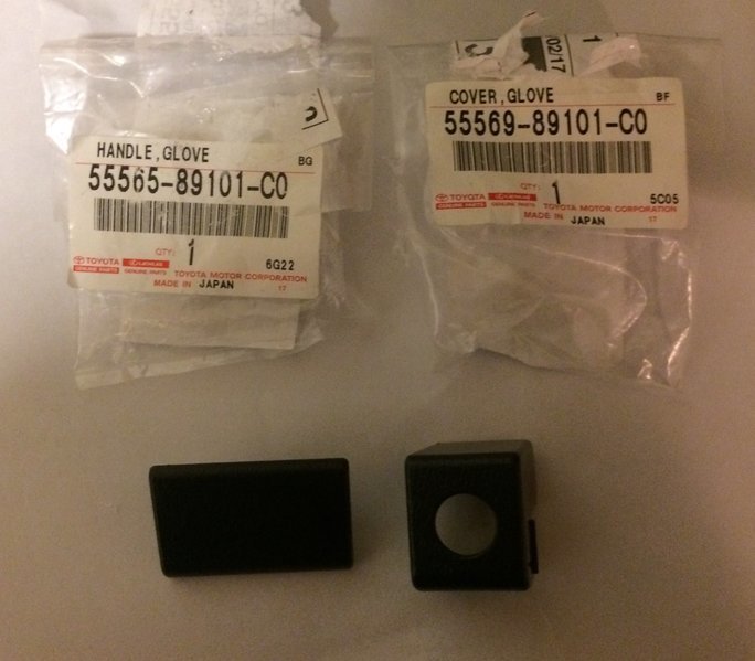

    July 7, 2017 - I decided I wanted a locking glove box like the one 4Runners come with. First I tried to order new parts from Camelback Toyota using Toyota part # 55569-89101-c0 and 55565-89101-c0. Well those were just the plastic covers for the locking mechanism....and they were black. Strike 1.
    Couldn't give those damn parts away. Seriously, I tried:
    FREE: '96-02 4Runner Glove Box Handle Cover (Handle & Cover Only NO LOCKING MECHANISM OR KEY)

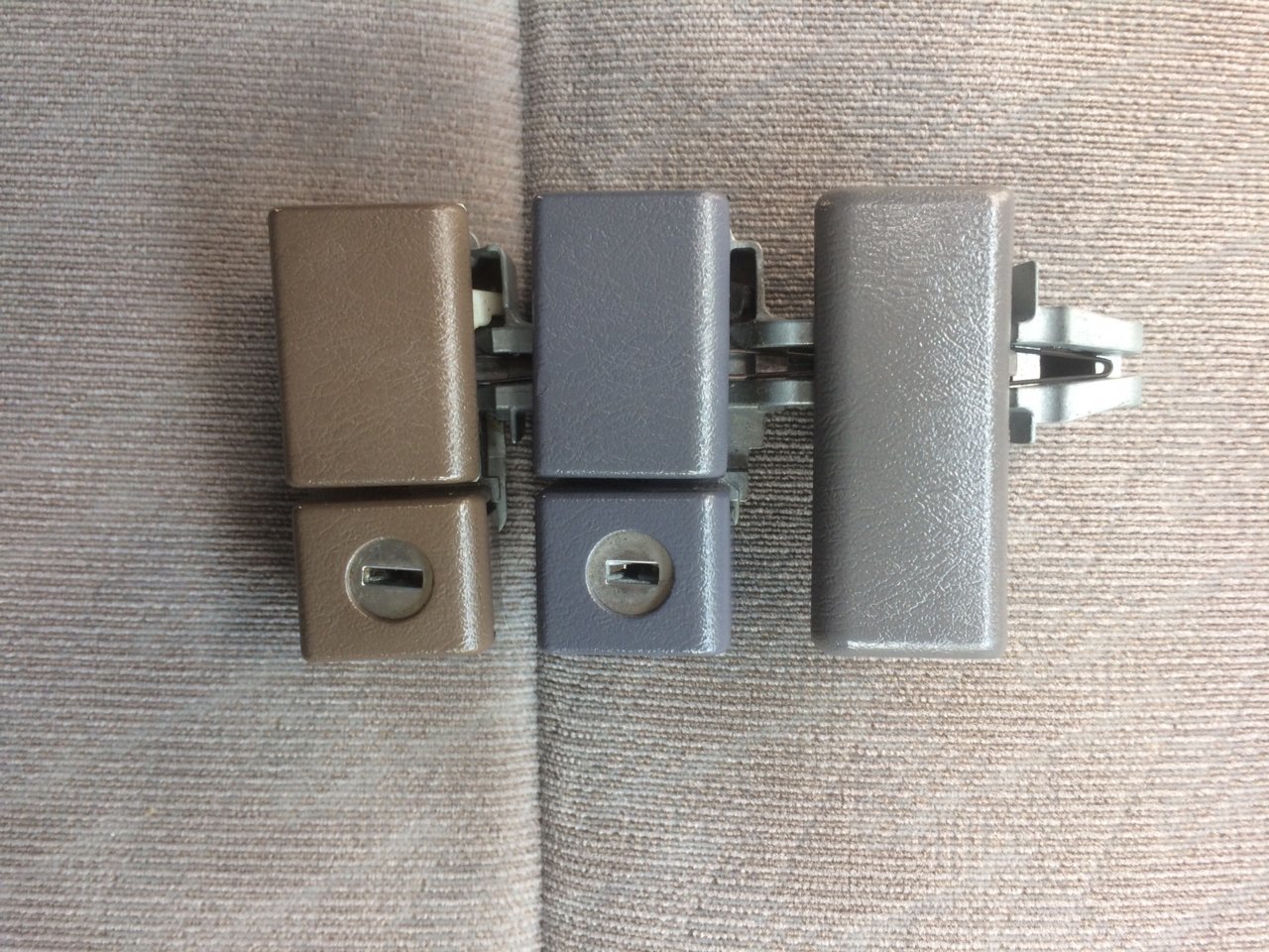

    Next I tried to order a used one from eBay. It's hard to judge color in an eBay photograph so I used the color code on my door jamb. Mechanism arrived, it was not even close. Strike 2.
    I gave eBay one more shot and tried to eyeball the color from the picture. Well, the third time wasn’t a charm. As you can see, it’s a little closer but not a match to the truck’s interior trim color (original latch is the one on the right w/o a lock). Strike 3.
    Well, that was enough time, effort and money for a damn glove box lock so I used the second one from eBay. Good enough.
    I sold the tan one to a member here. Didn't match his Tacoma trim color either.

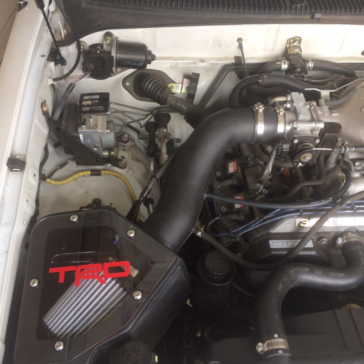

    Cold Air Intake
    August 13, 2017 - I finally installed the cold air intake that I purchased on May 2, 2017 from @BYJOSHCOOK. It was a Volant Cold Air Intake (Part # 18634):
    Before I put it in the truck though I wanted to modify it quite a bit. It was enclosed, like the factory air box, however the tube going into the air box didn't seal. I went to Ferguson Plumbing Supply looking for a rubber gasket. I found one that fit perfectly. It was a PROFLO 3" Compression Service Multi-Tite Gasket (Part # PFSVQTGM) and with a bit of alteration I had an air tight seal for the air box:
    Next up, I wanted to get rid of that oiled air filter. I've read they screw up your MAF sensor plus I didn't want to hassle with oiling it periodically. I measured the Volant air filter that came with the CAI then went to the AFE Performance website but didn't see an exact match in their dry filters. They did however build custom filters if you gave them parameters. On July 29, 2017 my AFE Custom Conical Pro Dry S Filter (Part # 21-99999) arrived:
    The last thing before install was a new top cover to the air box. There is a member on here, @Coupe, that makes custom acrylic covers for 2nd and 3rd Gen Tacoma CAI air boxes. He was nice enough to fabricate one for my 1st Gen Volant airbox, it arrived on June 24, 2017. Still one of my favorite cosmetic modifications to the truck. Here it is being test fitted with the protective backing still in place:
    With all modifications done, I installed it on August 13, 2017:

    Cold Air Intake - More Pictures

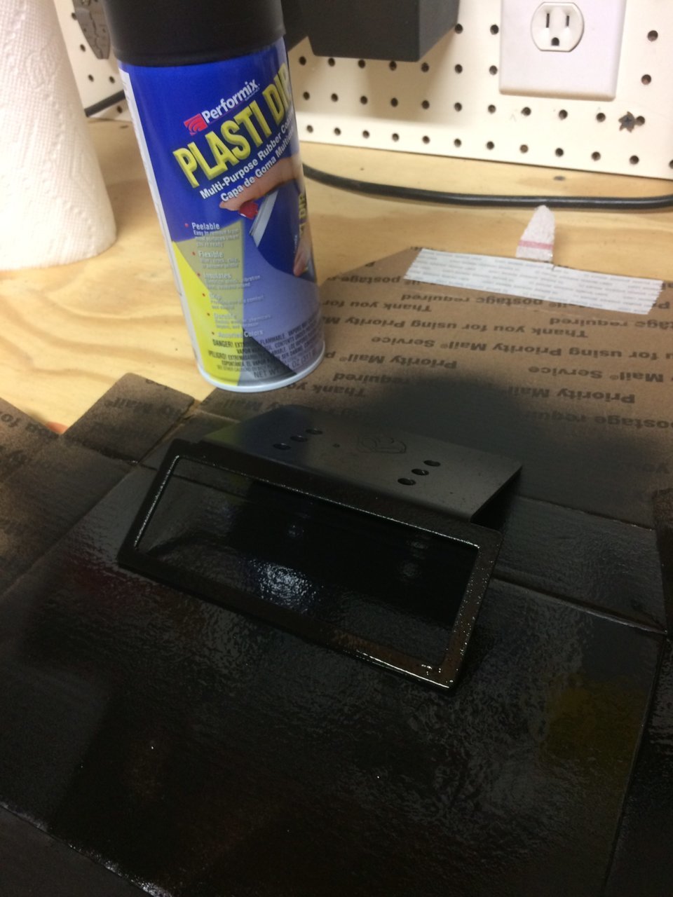

    ScanGauge and Mount
    July 24, 2017 - On July 5th a TW member mentioned that the ScanGauge II was on sale on Amazon for $79.00, which was close to half price. A few days later I had a nice new toy for the truck:
    I purchased a mount for the ScanGauge from @paranoid56 Paranoid Fabrications to secure it in the ash tray location. This mount is set at an angle for easy viewing from the driver's seat. When it arrived, I plasti-dipped the part:
    The ScanGauge II will show four readings on the screen, but there are multiple options for what information you want to display. Mine currently displays Engine Temperature, Voltage, MPG and Intake Air Temperature. Into the truck it went:
