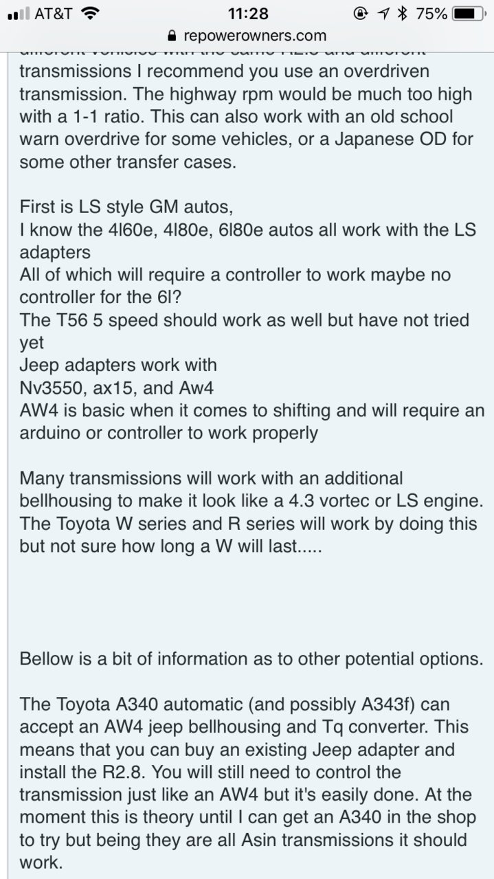

    The new cummins 2.8r bolts up to toyota R trannies

    Ok couldn’t find where i read R serious but on their website they have a Toyota pickup with a 2.8 and a A series tranny so im sure R series will work too

    Yeah i recall jeeps using the same/similar a340 transmission as tacomas/4runners.

    Mix/match A340 and AW4 parts is pretty common, it's what people do for 1UZ swaps in Jeeps

    Did you read the parts about a different bell housing on a R

    Yup, interesting read.
