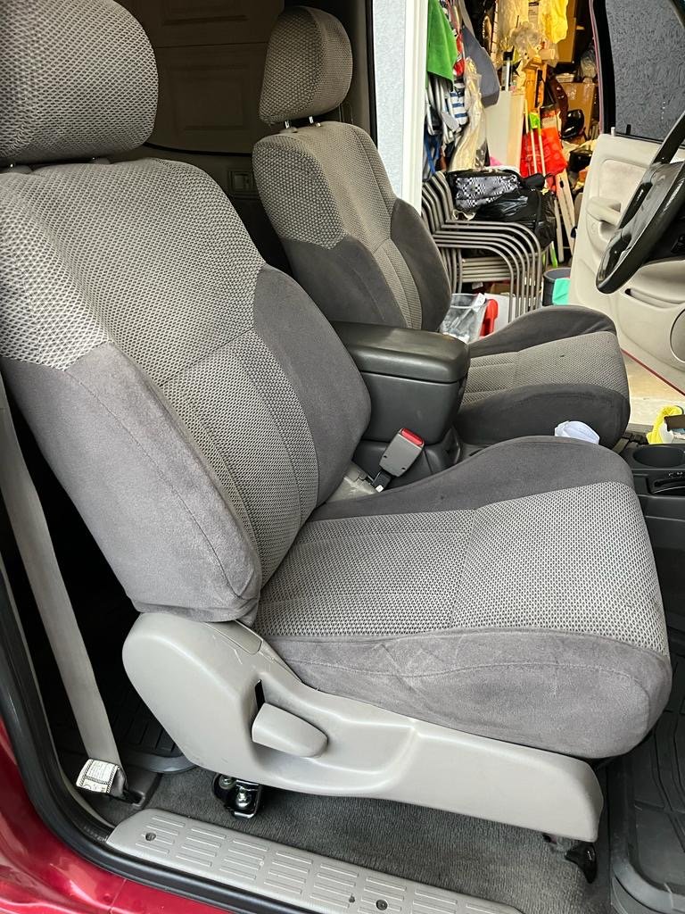

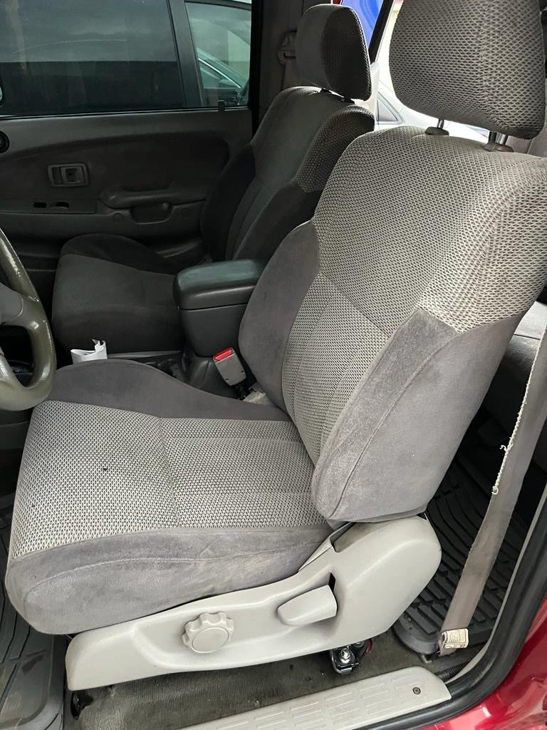

    d2371cc9-8652-4597-beb5-778da7371735.jpg 46f5bcbf-f423-4fee-9231-a2e66571949a.jpg
    this might help
    From 99 4 runner special edition got lucky on this set for a cheap price also . no cutting or welding just got a bolt adapter for the rear passenger bolt from a member here in TW .

    Yes I make those adapters for the outside rear feet. Here's the thread: https://www.tacomaworld.com/threads/4runner-seat-adapters.622390/
