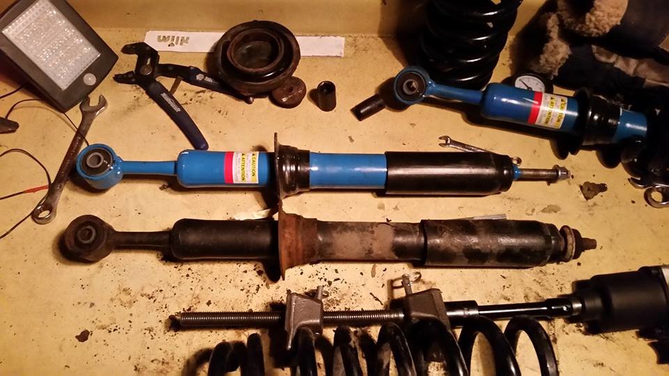

    I'm swapping in struts and springs from a 2017 tacoma (unknown model) into my 2007 (SR5 4x4) I got for a steal on Kijiji. When I researched ahead of time it sounded like a straight swap, but the new struts would give me a ~1" lift.
    However when I pulled the old strut (OEM), it's almost 1.5" taller than the newer strut... Looking at the toyota website, all 2017's have the same ride height, am I missing something? As far as I know, my current struts are original... I had to cut off the top retainer nut/bolt, so there's no going back.
    New struts are #48510-04220
    I have the springs and they're almost the same height, but much thicker metal.
    Also have a set of blisten coilovers and they're 1" taller, but I wasn't planning on using them as I think they're from a Tundra and I only have fronts.

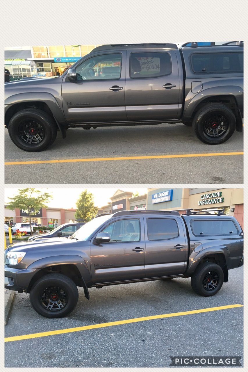

    I put 2017 TRD Sport struts on my 2015 TRD Sport and got exactly 1” of lift in the front. I have found the biggest tire size I can run without trimming or removing mud flaps is 255/75/17. Also did a 1.5” icon progressive add a leaf in the rear.

    Don't know, but maybe 2005-15 top hats are different from the 2017 top hats, anyone know?

    They are direct bolt ins....

    Makes 100% sense now that I think about it. Maybe I'll have to look into leveling blocks if it's bad.
    I'm swapping my old top hats over, the new struts didn't come with any.

    Are you referring to the beat up black strut in your original post as being a Bilstein?
    Edit: never mind I see you were referring to the tundra bilstein not your base SR5 shock

    Understood, was just saying maybe the height difference comes from the top hats being different(maybe someone knows), since he didn't get 2017 top hats....

    Yeah sorry to be confusing, that one isn't pictured.

    I think he’s referring to how it looks without top hats.
    Once OP puts on the springs and top hats it will look like it’s supposed to. The shock height isn’t really the lift factor here, the springs just have one extra coil which provides the lift for the 2nd gen once assembled.

    I get where you're coming from. Well if that makes the difference I'll be back at stock height anyways. Images I've seen look pretty similar though.

    3810F987-2AD5-4A5C-8180-BB6260563603.jpg When I did the swap the rear end was lower than the frnt in its stock configuration noting that I have a cap on the truck. With 1.5 add a leafs with overload in and the 2017 struts up frnt I am now the same as stock with approx 1” of factory rake. Above is before and after pic with stock tire size.
    1” more lift in front and 1.5” rear lift with this set up.
    As far as ride quality, New 2017 struts are sprung stiffer and really only found them good after increasing tire size due to extra weight. With add a leafs in rear new shocks are def. needed. Went with toytec boss 0-3” lift shocks. Now that it’s done I am super happy with this set up and would def recommend it!

    wow surprised they are that much shorter. Talk about a loss of droop!
