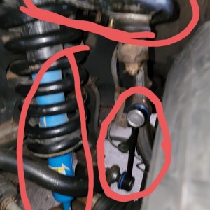

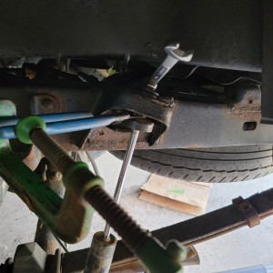

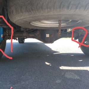

    this is about the best pic I have atm of the 3rd gen suspension but there were no problems at all.
    This was what I used to get the rear shocks off, the top thing you'd usually latch onto was so crusty I had to do it this way, note to self just cut it off next time lol. idky i didn't. You can also see how crusty that 9 year old suspension from north east pa is. These leafs that came stock on here originally broke, one about 120k the other about 2k miles after I had only the broken leaf replaced by a local guy and since then the leafs started rusting pretty good, however before that they looked better way less rust before I had that replaced. Now they look brand new again. I'll add a better pic in the future.
    this is the new front suspension from the 3rd gen, everything is exactly the same as a stock Tacoma just pretty blue. I'm assuming the shocks and springs ae set up a little diff as the truck feels totally diff now in a good way.
