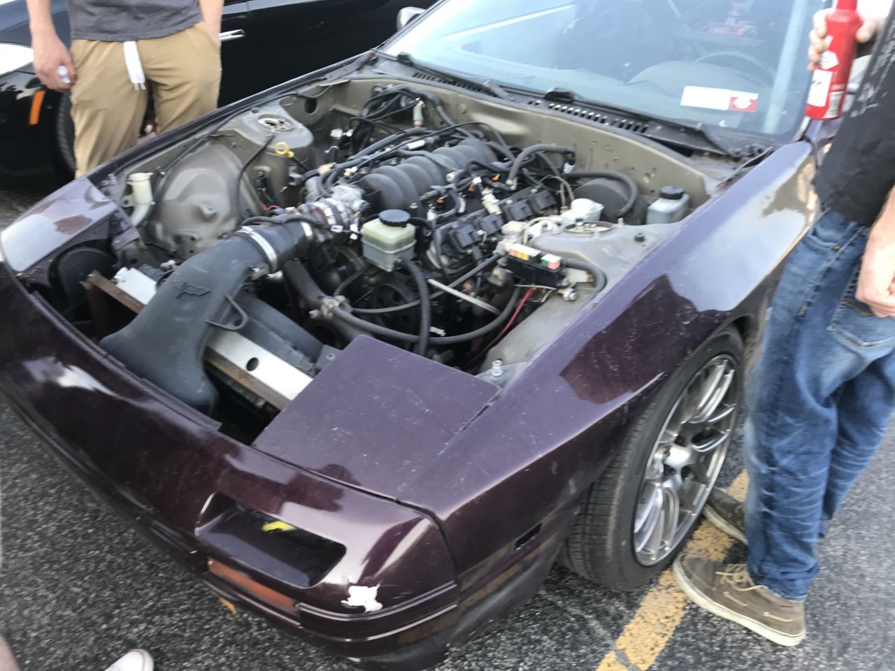

    This dude dumped an LS into an RX7 (or is it an RX8 - whatever)35ED665F-CF77-455F-9858-8B360ABD8C97.jpg
    frenchee likes this.
