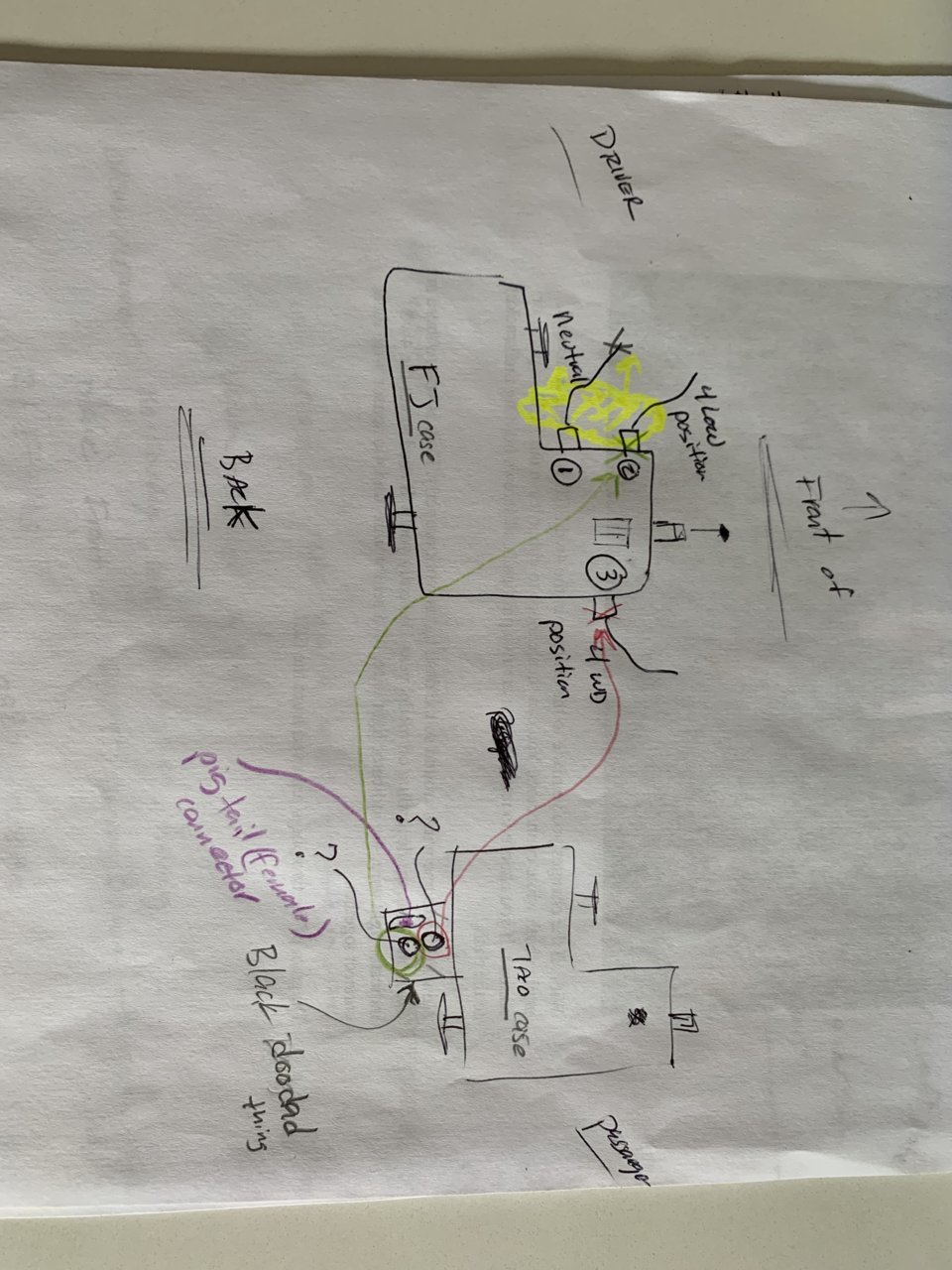

  10. Mar 22, 2022 at 2:30 PM
    #50
    dborrer
    dborrer Well-Known Member
    Apr 28, 2018
    #251944
    550
    Mr. Dan
    St. Augustine, FL
    2006 Tacoma TRD Sport 4x MT
    2018 new Frame (thank you Rust!), FJ T-case swap. SPC(LR) UCAs, Bilstein 5100s front - rear, OME 883 at 0, HeadStrongOffRoad 3 leaf progressive AAL, MESO custom 2nd gen (Red/White) LED dome & Ultimate Maps, Spyder Halo Projector w LEDs (which SUCK), Spyder LED tails
    Na fellas.... I think I get it at this point, I will put back in the FJ neutral sensor and let it live unplugged (i'll secure it so its not dangling).
    I will try placing the forward Taco sensor [Red color in my pic] (from my Tacoma's "electronic doodad that actually switches the case between 2/4/hi/lo." which I called an Actuator...) into the #3 position on the FJ case...
    And the back Taco sensor [Green color in my pic] into the #2 position on the FJ case...
    Unless I have this backwards?
    And i'll just leave the now unused pigtail that did plug into the doodad, unplugged and secured up somehow. [Purple color in my pic]
    If that is all good above; I think my LAST question will be: do I need to "massage" with a big fucking hammer, the area in my truck where these 2 new sensors will now be fitting/living? [Yellow hi-light color in my pic] How much?
  11. Mar 22, 2022 at 2:35 PM
    #51
    EatSleepTacos
    EatSleepTacos [OP] Well-Known Member
    Mar 24, 2015
    #151688
    59,842
    Randy
    West Valley, AZ
    2017 4Runner
    I don’t recall which sensor is which but I do know that no massaging is needed at all.

  12. Mar 22, 2022 at 3:24 PM
    #52
    Mescorpio1147
    Mescorpio1147 Well-Known Member
    Nov 19, 2018
    #273216
    49
    Ivan
    06 tacoma 4x4
    I love what you are doing, ha e you ever thought of installing a Atlas transfer case?
  13. Mar 22, 2022 at 4:16 PM
    #53
    6 gearT444E
    6 gearT444E Certified Electron Pusher
    Feb 3, 2018
    #243372
    7,798
    Deep South
    Herculiner Hootus
    that looks good. Shouldn’t be any need to massage for a stock placement. It will be tight up between the body and transfer case to get to those plugs once everything is in place though.

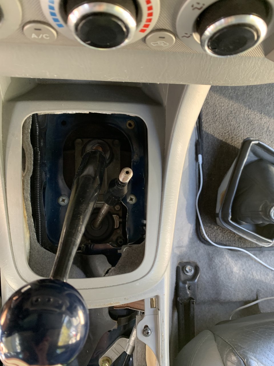

  15. Mar 28, 2022 at 3:47 PM
    #55
    dborrer
    Apr 28, 2018
    #251944
    550
    Mr. Dan
    St. Augustine, FL
    Money Boys: Thanks again for all the help with answers etc....
  16. Mar 28, 2022 at 3:57 PM
    #56
    EatSleepTacos
    Mar 24, 2015
    #151688
    59,842
    Randy
    West Valley, AZ
    2017 4Runner
    Fuck yeah, looks awesome. I ended up remaking my t case shifter because I was worried about it rattling against the trim in 4lo. Curious to see how yours does.
    dborrer[QUOTED] likes this.
