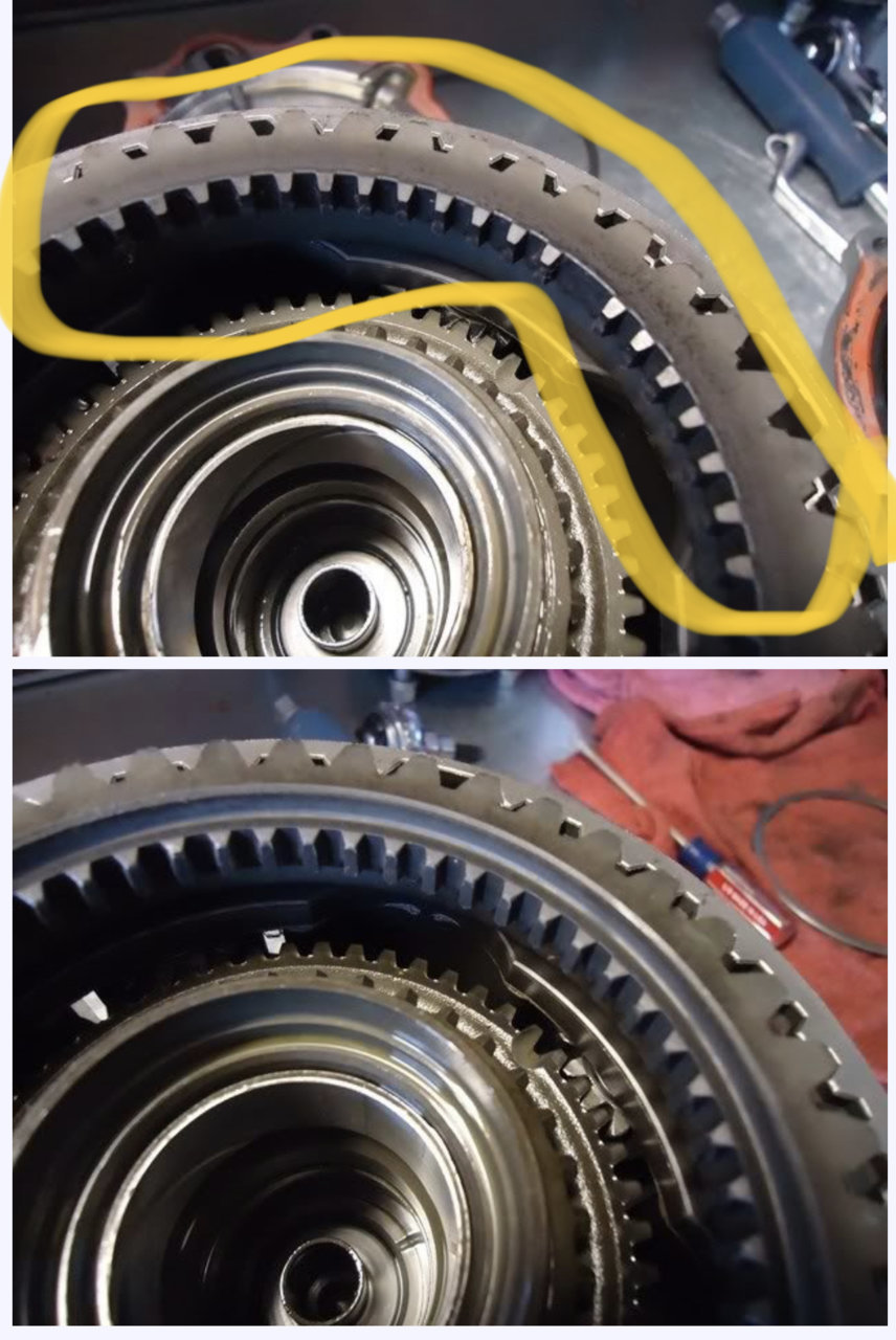

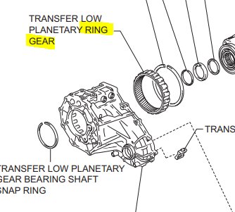

    Ok so with this in the writing it said you need to swap the ring gear, because I’m a bit dense it means not using the original 6sp ring gear it means using the auto one correct?, and thanks for the write up on the add swap it will be very helpful.

    the input shaft will need to be swapped from the auto case. They are a smaller 23 spline shaft and the 6 speed is a larger 22 spline input. No ring gear has to be swapped.

    Ok so I don’t have to use the automatic ring gear on the backside of the planetary gear and input shaft? I can use my 6speed ring and it work fine even tho they are slightly different?

    my apologies, yes what Randy is calling the ring gear you will need to swap between cases

    What wyatt* is calling that. I just copy pasta’d his whole thread.

    forgot that you snagged it from his site lol, sorry. Yes I heard ring gear in my mind and was thinking R&P from the differential.

    When he said ring gear I also thought diff during my initial read.

    "No ring gear has to be swapped." I was going to say... WTF, because i sure changed out mine! But then i read further and see that you corrected your comment.. Pheww... (that was simi-fun part of the swap)
    Somewhere on TW I recall reading the quote about the Threads aren't fun w/o pics... so enjoy some randoms from my (best yet) swap...
