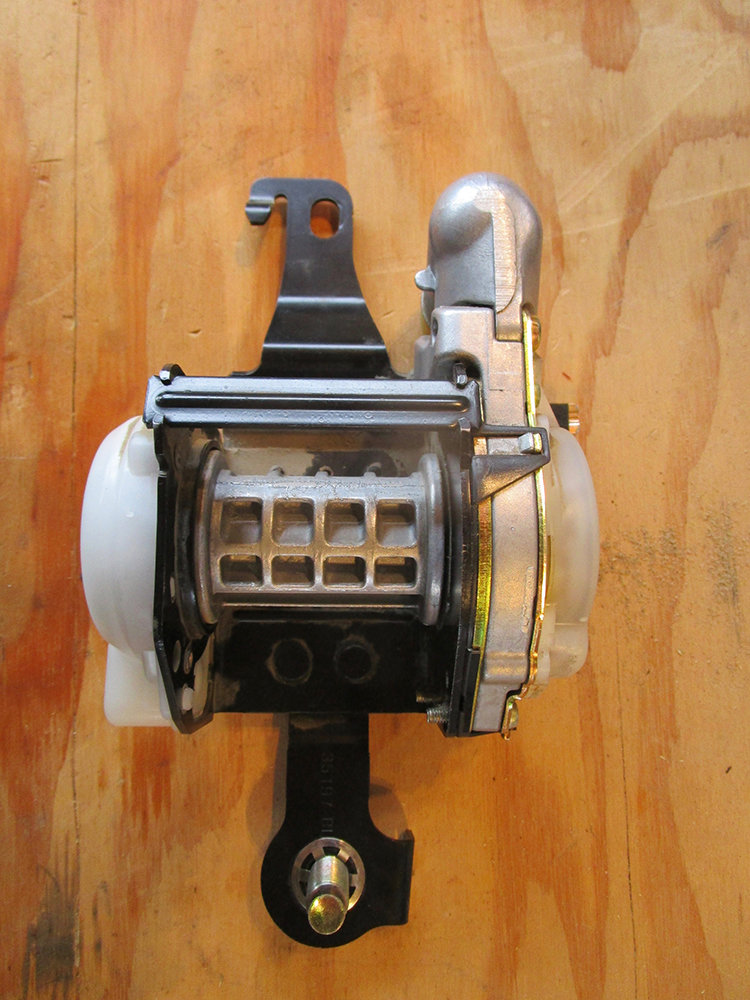

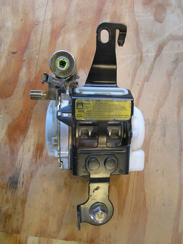

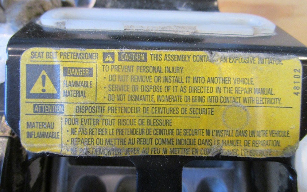

  11. Aug 21, 2018 at 4:25 PM
    #31
    Gyrkin
    Gyrkin Well-Known Member
    Aug 16, 2017
    #227041
    2,376
    Steve
    Wyoming
    2000 Tacoma TRD v6 5-speed
    Nope, the explosive part is on the part with the male end. You can get to the spool without tearing into it, so replacing the webbing would be safe. Here are some photos of the one I messed up. This is the part that mounts inside the wall to the left of the driver. It would normally have webbing on the spool.

    Dirtbag4Life
    Dirtbag4Life [OP] Well-Known Member
    Jul 9, 2018
    #258798
    65
    Bozezman, MT
    2000 Taco 3.4L SR5 V6
    Custom camping platform w/sliding drawers Added camper shell Added hitch for towing and bike racks Installed roof racks on shell Added shade awning off of roof racks Upgraded to 2003 center console Upgraded to Anzo black headlights Upgraded to 1440 Lumen LED reverse lights Previous truck was a 2005 Tacoma TRD
    Wow, thanks for attaching pics! I don't believe that the one I bought from a 2003 tacoma has that explosive component. Guess I'll find out soon enough if the one installed in my truck has one. If it does, looks like I should either just replace the belt or order a whole brand new system.

    #38
    RysiuM
    RysiuM Well-Known Member
    Oct 18, 2015
    #167004
    2,710
    Rysiu
    Was Golden State, now Poland EU
    1995 4x4 LX Ext Cab, I4 2.7, MT, 335K miles
    DD Deck+backup camera, LED DRL, All LED except H4 Hella
    The pretensioner is a part of the airbag system (the wire from the yellow contact goes to the airbag computer), so treat it the same way as you would your airbag: do not work around it when battery i connected. Disconnect the battery and wait few minutes before touching any "yellow plug" wires. And of course don't text the "yellow plug" contact with multimeter.
    And when there is something wrong with pretensioner (missing, not connected or faulty) you will have the airbag warning light (not seat belt light). Seat belt warning light is triggered by the switch in the female part of the seat belt.
