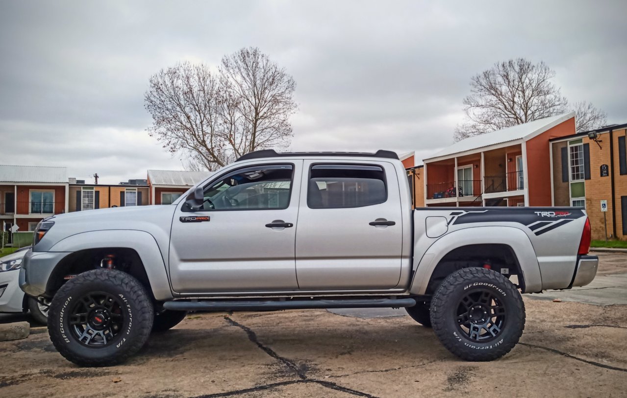

    I got SAW on my 2nd gen.
    Cranked up to 3in lift.
    No issues at all going on 3 years now.
