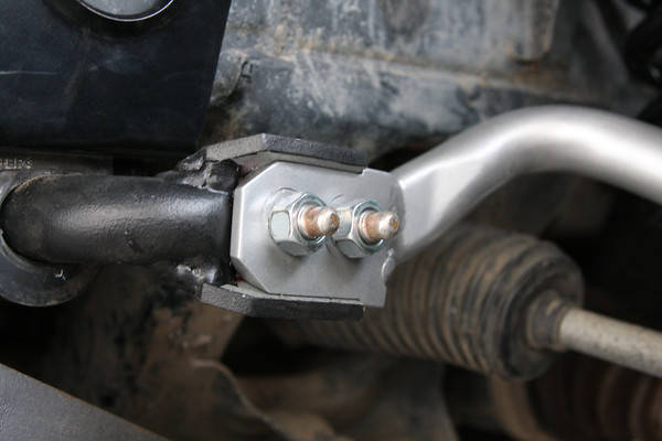

    Since Chris didn't post his source, here you go
    The guy who designed this CANNOT be contacted, has completely given up building them, and I think he even has a patent so you can't build it either without some legal hoops... but that may have been just a rumor. It's just totally baffled me that someone like ARB or similar company hasn't bothered with doing something like this. It's baffled me more that a big company didn't buy the design, either, like with the story of the Bandi mount

    I already bought a second sway bar to try to do this to
    well, once I get my welder up and running and I get decent at it.

    Are you saying cut a slit in the sway bar so the end could be slid in and bolted? That's a good idea but it would put all the load on the bolts and may not be as tight as this setup. If you notice the plates are angled so the more the bolts are torqued the tighter it is. Also I think the bolts would need to be welded to the back because it would be hard to squeeze a wrench back there. Or maybe I'm not picking up what you are saying.

    I don't think you want to weld bolts on because you are going to get pissed when you strip them.

    Nothing an angle grinder and rewelding can't fix. I don't think it would be possible or practical to hold a wrench behind the sway bar and then wrench the outside bolt.
