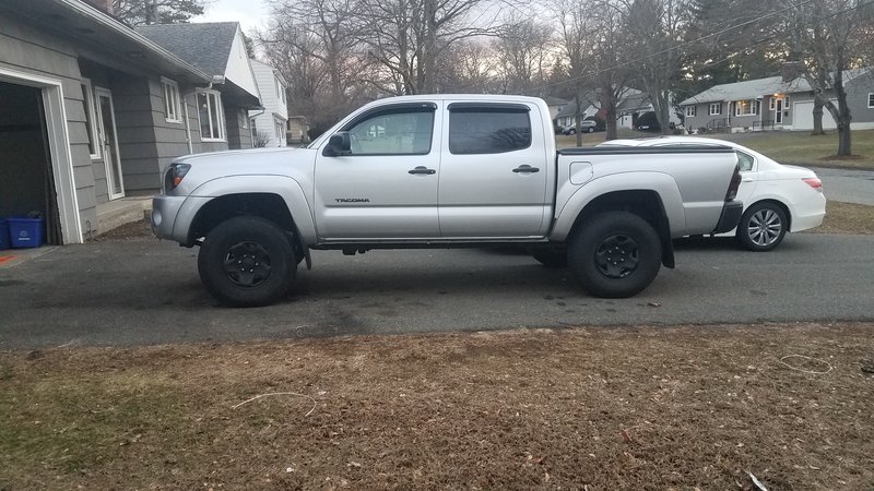

    Might be a dead thread anyway here goes....I just swapped out my ome front struts for new ome front struts reusing same 885 coils. Sway bar is on with relocate kit. I have some extra lift up front bc I haven't swapped out the rear intro chargers yet. I'm getting the clunk over big bumps once in a while. Sounds like it is the sway bar contacting coil. Anyone had the clunk with the relocate kit installed??? Should I just ditch sway bar? I've looked at the lower and upper ball joints seem in good shape I need to actually jack up the lca and test the play still but I'm 99% certain this is metal on metal clunk from sway bar contacting coil.20170226_173404.jpg

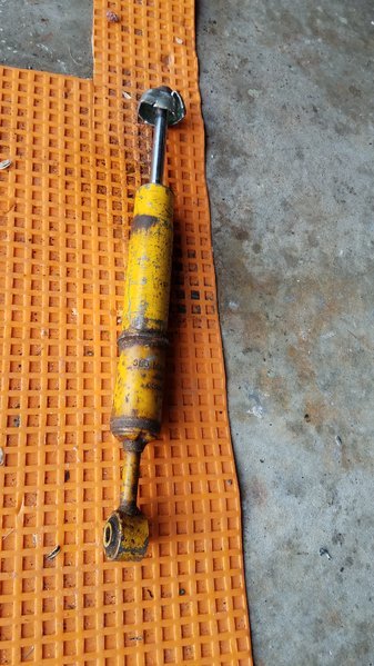

    FYI I don't recall any clunk with old nitrochargers on but they were shot with only half the travel they were suppose to. Could of had something to do with it. Drivers side shock I mangled to get the trim packer off. Was rusted to all hell.20170228_161418.jpg
