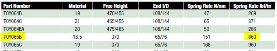

    2" Ironman 4x4 (B) Front Spacer Level LR UCAs Level 8: Tracker Wheels 255/75 Cooper ATPs Welded Rock Sliders Weathertech floormats Wet Okole seat covers JVC Head Unit Diff Breather Mod Zip Tie Mod Needle Bearing Mod HID Retrofit (Acura TL-R)
    I had the swaybar off mine for awhile because of the hype on here and because I thought they were rubbing against something. After a couple days of city driving I put them back on because they had too much body roll for my tastes. I'm sure I would've gotten used to it but I don't see why I would want to, I don't off-road and more body roll doesn't appeal to me on those tight off-ramp spirals and suburbia curves. I didn't even feel comfortable letting my wife drive while it was off.
    And yes I had beefier springs, Ironman4x4 Performance springs specifically (2in lift, 863 lbf/in spring rate).

    Uhhhh, why in the world are your springs rated so high? Do you have a tank for a front bumper?

    I only wanted 2" of lift and these were the middle of the road spring rate offered by these guys (669/863/960). I should've done a little more research before I bought them but I was kind of in a rush at the time and I wanted them rated a little higher for a plate bumper later. Haven't gotten there yet though.

    That's insane for our trucks. The normal OME coils are 590, and their 886s (can support a plate bumper) are 660 lb coils. Some running performance coil-overs go 700lbs if they've got a whole lot of stuff. Does your truck ride like a dump truck?

    It's pretty fucking stiff lol. Corners like a beast though. According to the manufacturer my springs were "only" rated for an extra 0-50kg (110lbs). The 960lbf/in Constant Load springs were for anything over. But that kind of goes to prove my point: if my stiff ass front end had body roll then I can't imagine how some of the other guys can claim they don't.
