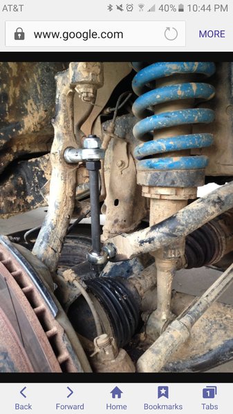

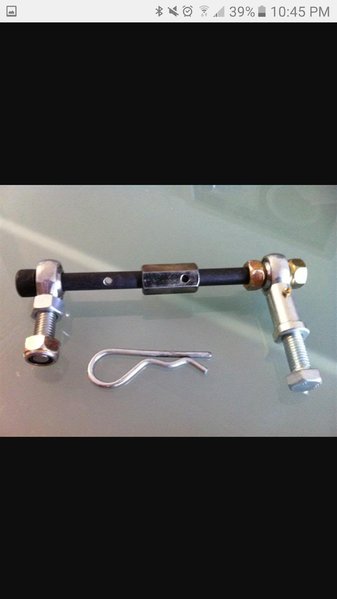

    How 'bout the cotter pin holding it in place?
    Threads would cause accelerated wear methinks.

    This would work. Not sure how hard it is to turn the nut with the wheel still on. :)
    Those are just teflon-lined rod ends (aka "heim joints"), similar to those on Icon billet UCAs. McMaster-Carr has them. Or you can get FK- or Aurora branded ones. Note you will probably need to drill out the hole on the spindle slightly from 12mm to 1/2" to accept the 1/2" rod end shank.

    Assuming the threads are relatively clean, the nut should just freely spin. I think the hardest part would be crawling under the truck to get to it! LOL
    Rod ends is what I was thinking - thank you.
    If I am not mistaken, the spindle holes are also tapered. Either way, drilling them should not be too difficult.

    Found a vendor who makes then for 4runners and fj cruisers on another website. Looks very similar to the sliding links. Maybe we can reach out and have them make some for tacoma world?
    o_O:rofl: Also found some pics around onlineScreenshot_20170223-224545.jpg Screenshot_20170223-224426.jpg
