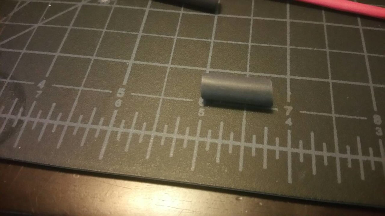

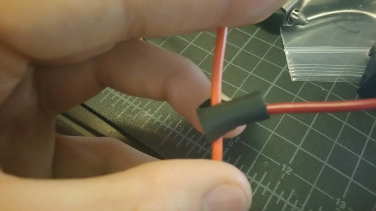

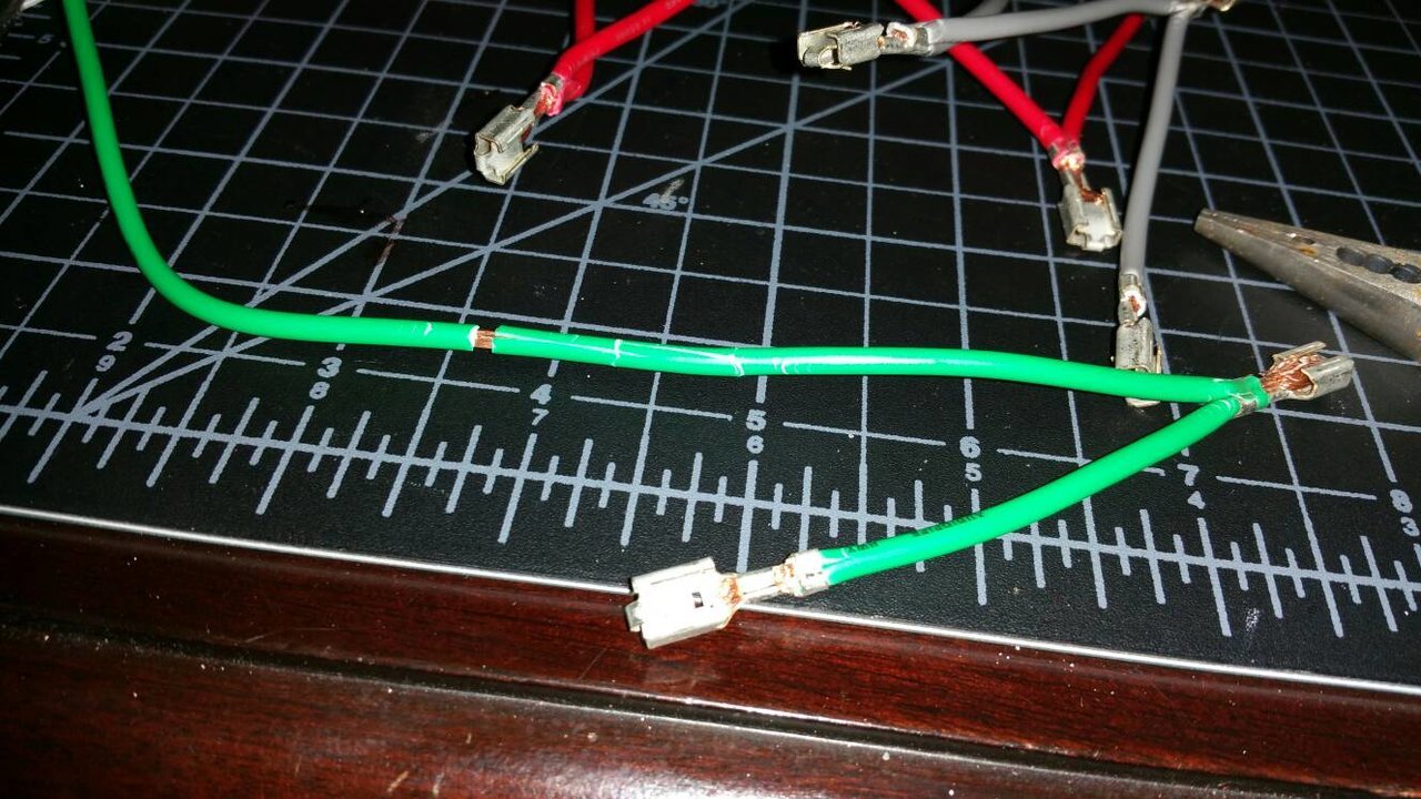

    How do you tape/heatshrink this?
  14. Jan 30, 2015 at 8:18 AM
    #714
    skygear
    skygear                    
    Nov 6, 2011
    #66558
    8,414
    I use the Marine grade waterproof heat shrink tubing. Cut a piece about an .75" long. Then cut a line up one side about three quarters way up. or cut both sides. When you slide it onto the wire BEFORE you splice in. You are able to pull it onto the spliced wire creating a 'T'. At that point, you just use a heat gun and shrink it on the joint. With the marine grade heat shrink tubing there is an adhesive in there that flows when it is heated. As it melts, just Pinch the joint quickly with your fingers so you don't get burned. It will adhere to the wires and itself creating a waterproof joint.
    Or just use electrical tape. Wrap it in a football or flag formation alternating sides of each wire.
    Even another option, use the liquid tape to seal the joint.
    Soldering is not critical, especially for the low voltage circuit that the DIMMER requires.
