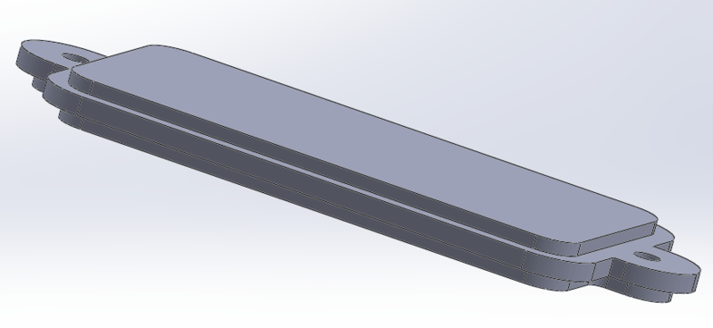

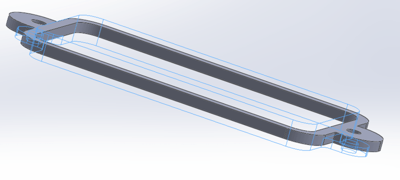

    alright, started with the switch panel as a model.. going to try some bezels now. I am going to try one that I would use for my setup.. and I can try and make tweaks to that one for you guys. since I already have the mount holes drilled in my shifter bezel.. I will most likely utilize those again.
  8. Apr 15, 2016 at 2:28 PM
    #188
    XPOTRPR
    XPOTRPR CNC Programmer/Machinist
    May 29, 2011
    #57449
    31,174
    Josh
    Chandler, AZ
    > BUILD LINKS >
  9. Apr 15, 2016 at 2:44 PM
    #189
    reidbailey
    reidbailey Well-Known Member
    Jun 28, 2014
    #132873
    48
    Reid
    Redondo Beach
    2011 4Runner
    That was fast!!!
  10. Apr 15, 2016 at 4:31 PM
    #190
    XPOTRPR
    May 29, 2011
    #57449
    31,174
    Josh
    Chandler, AZ
    > BUILD LINKS >
    yeah it was pretty easy. lol

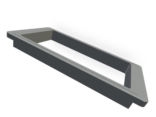

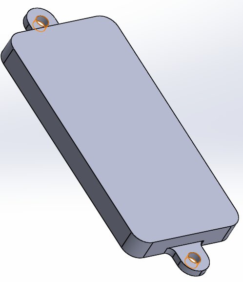

    here's what I came up with:
    the flange around the perimeter is the bezel. it rests on top of the switch pro tabs, and was extruded up, just short of the face of the switch panel to account for the thickness of the shifter bezel/console. This SHOULD bring it completely flush. I took measurements with calipers as accurately as I could. I will cut some test samples to check fitment around the switch panel itself.. and if everything checks out, I will print a prototype. Problem is.. I gotta commit to this, since I will have to cut out the shift bezel/console.
    here is just the bezel:
    It will be bolted with countersunk machine head screws (I will countersink the holes I drilled in the shifter console to make the heads as flush as possible). those bolts will go through the shifter console, through the bezel, and through the switchpro tabs, and then cinched together. So.. with my setup.. the only thing that will be seen is the face of the switchpro.. and the heads of the screws holding everything in place.. but.. everything will be flush. just imagine this pic with the switchpro flush, and the 2 screws where they are at.. but flush in the console as well.. without the tabs being seen.
    hopefully that was a good explanation.. I will tackle more of it on Monday. :)

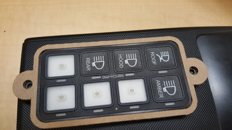

  11. Apr 15, 2016 at 5:05 PM
    #191
    XPOTRPR
    May 29, 2011
    #57449
    31,174
    Josh
    Chandler, AZ
    > BUILD LINKS >

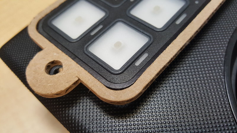

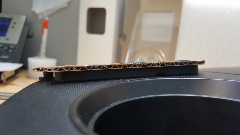

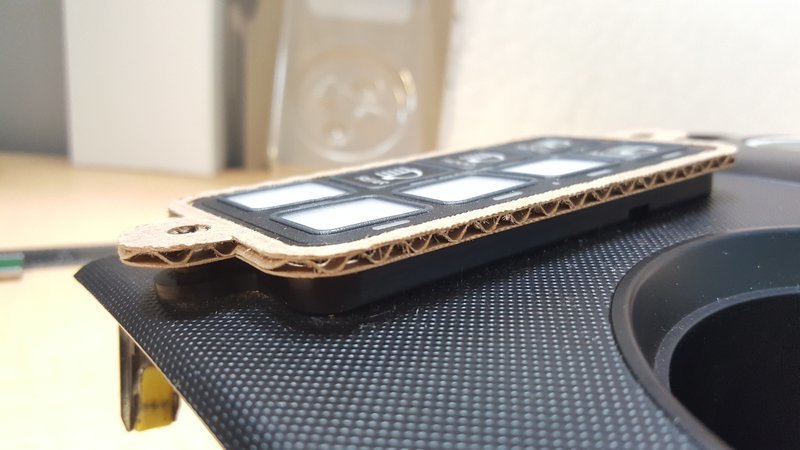

    Damn.. So close on the first rendition. Lol
    Just need to adjust the fillets to fit the radius of the switch pro corners.
    You can see that the bezel will sit lower, the heads of the bolts are keeping it from sitting where it should. Even then, the carboard I used is the same thickness as what the console is. So you get an idea.. The cardboard will sit lower, leaving that same thickness above the bezel, which the shifter console will take up, making it sit flush..
    Acerwin, Brian007Taco and reidbailey like this.
