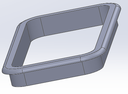

    Hey Reid, been playin with this..

    YES! I'm liking it!!

    alright.. just working on ways to have it capture the switch panel. playing with a two piece..

    Could you make it snap in the kit similar to the way an OEM switch snaps in the dash?

    haha.. just finished up and saw this. yep.. basically a snap in..
    Changed the radius of the corners to match the SwitchPro, so now its a perfect fit around it.
    pictured with the SwitchPro Model in place:
    just the bezel:
    the underside of the bezel. it will snap into place with the 4 tabs.. the flange on top will keep it from being pushed through the top of the shifter console. in theory anyways.. lol
    I will print a prototype tomorrow and see how it goes. I can make small adjustments now. just getting a base part. It will be printed in Solid form from "ivory" ABS plastic. the Dims of the flange and lock tab shoul dbe sufficient enough in thickness and strength. if everything goes smoothly.. I can order Black ABS for the final run.

    Wow! Seriously impressive! I think you should share your design with SwithPros when you're done. Maybe they'll use your idea and throw an attaboy your way. I'm sure lots of people would appreciate this option. I've officially put my install on hold to see how this comes out. Looks like the perfect option. Thanks for all your work on it!!

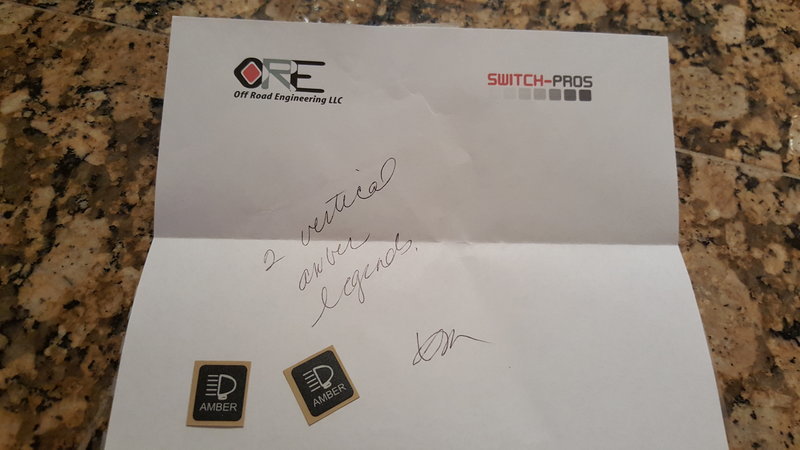

    on another note.. SwitchPros Customer Service is awesome. needed two more amber labels, and already bought one pack. they sent out two more same day I asked about them, free of charge.
