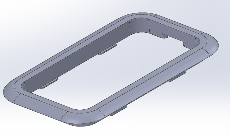

    Pretty damn perfect. Very tight fit.. Which is what I wanted. I had to take a file to a couple small spots.. Very lightly.. as it was being popped in.. And bam.
    Guess it's time to start cutting my console for it.
    Making some small adjustments. Adding drafts so the switch panel will be easier to snap into place. Also growing the top flange in width.. At least for my setup, since I need to cover my holes I drilled.

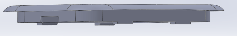

    printing another with the changes I made..
    wider top flange (covers my holes and also adds more surface area), added drafts to certain tight areas, and added a radius to the bottom surface of the top flange to fit the contour of the console (hopefully, I will need to do test fits to dial this in perfect)

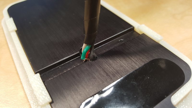

    hahaha.. thats what I'm trying for!
    on another note.. the green wire coming from the backside of the switch panel itself broke right at the area they filled with whatever epoxy they used. :(
    sent an email to them.. fingers crossed its an easy fix (solder) or a replacement.

    How did that happen?

    idk.. had to of just been from messing with it during all this..

    yeah.. kinda bummed :pout: hoping I can just solder it.. or they can just send me a new switch panel. sucks tho.. cuz its already all programmed and have all my labels on it. lol

    What a bummer about the wire... I didn't consider that happening. Guess we need to be careful.
    On the other hand, the first print looks perfect and better than I envisioned! I can't to cut a hole and mount this!!!

    yeah.. just need to be more delicate I guess.
    Im actually really surprised with how perfect it was on the first go. lol small changes to improve it even more.
