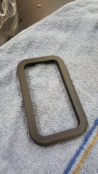

    alright guys. new bezel is printing. the one that I printed overnight was a decent fit. the radius I used for the curvature of the console was too great. pushed the middle portion up. adjusted and trying again. Also removed the lock tabs on the bottom, I think it will work fine without just using the friction fit.

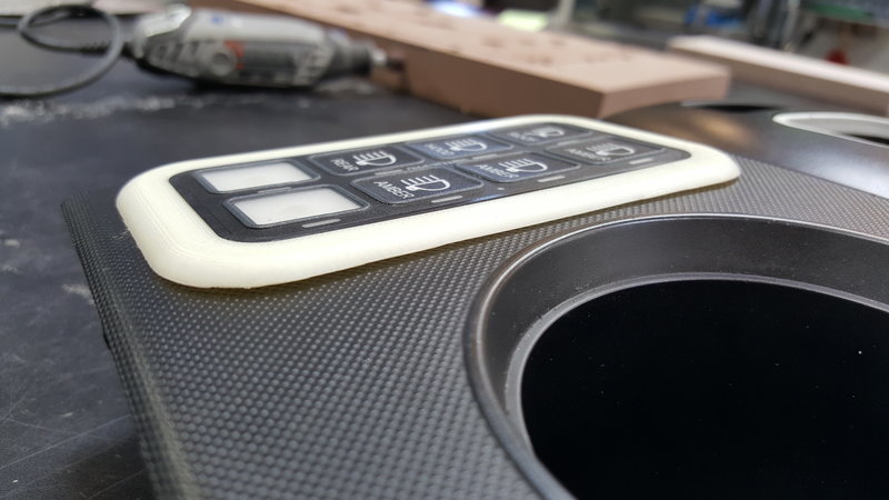

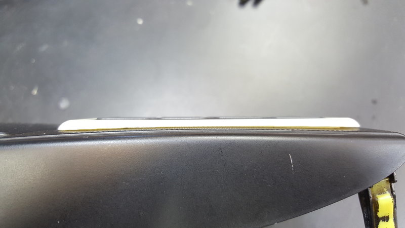

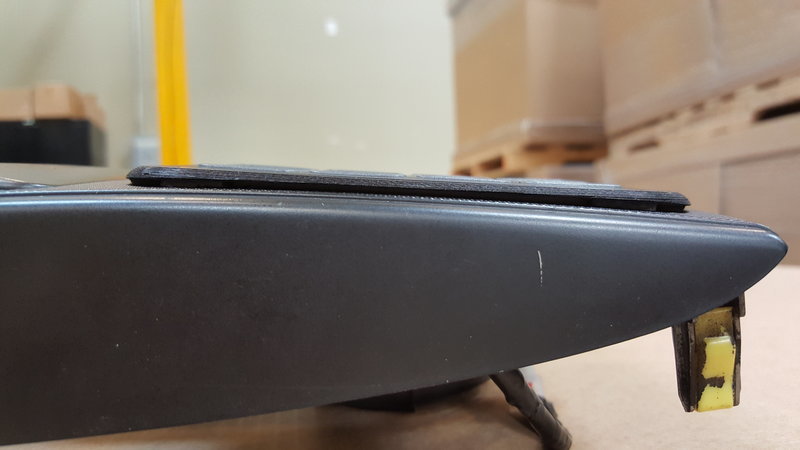

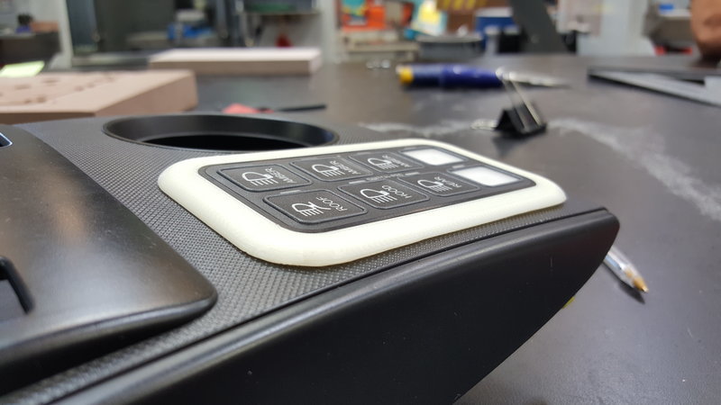

    Newest revision:
    As you can see.. It allllmost fits the curvature. Problem is im fighting other areas now.
    So.. I think I may change one more thing.. Add some room under the top flange (make it thinner) to accommodate some 3M tape underneath to pull it down to match the console's curvature. If that makes sense to everyone.. Lol
    Gonna try painting it black and getting it all done so you guys can get a real idea and judge the final look of it.
    also might try a version that doesnt have the curve in it (more generic mounting bezel) and use the 3M tape method on that too..

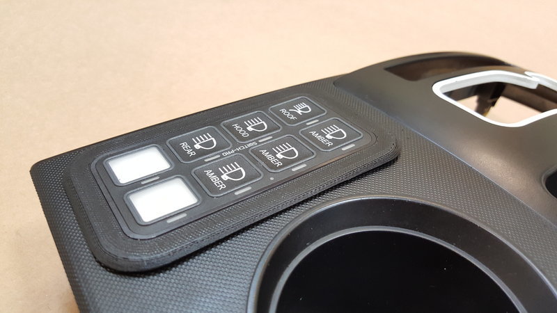

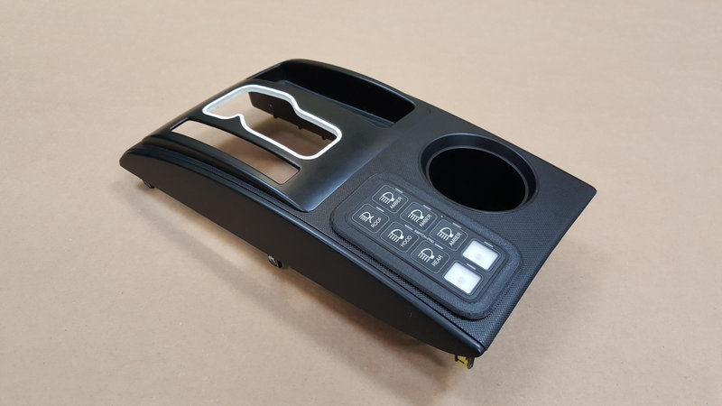

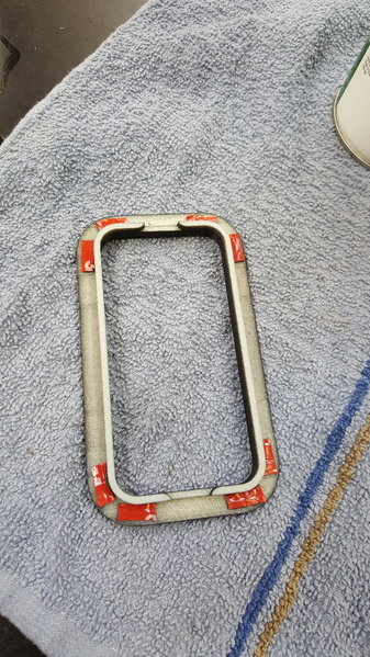

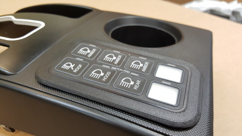

    Making one more bezel overnight to try something different. But here it is...
    I sanded down the part a bit to smooth out the print pattern and hit it with some black trim paint, the same paint I used for the console itself. I then added the small pieces of 3M automotive tape to the corners in an attempt to "pull" them down. It works, but the thickness of the tape kinda doesn't. Lol
    Im going to sand, paint, and use RTV on thenl next one. Im also going to print another after this one is all finished up, with no curve under the top flange. This will make it flat and will be for the people who choose to mount elsewhere.
    let me know what you guys think.. I can make small changes if needed. I think tomorrow's version will be better honestly. it wills it more flush.

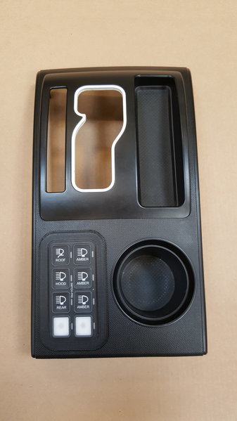

  18. Apr 20, 2016 at 6:02 PM

    That looks good buddy

    thanks man. I think tomorrow will be the last rendition. which is good.. because I need to send my Switchpanel in still to get fixed. sooner I get it out, the sooner I can hook up everything finally.
