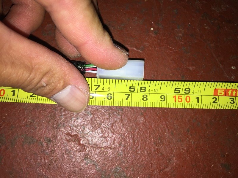

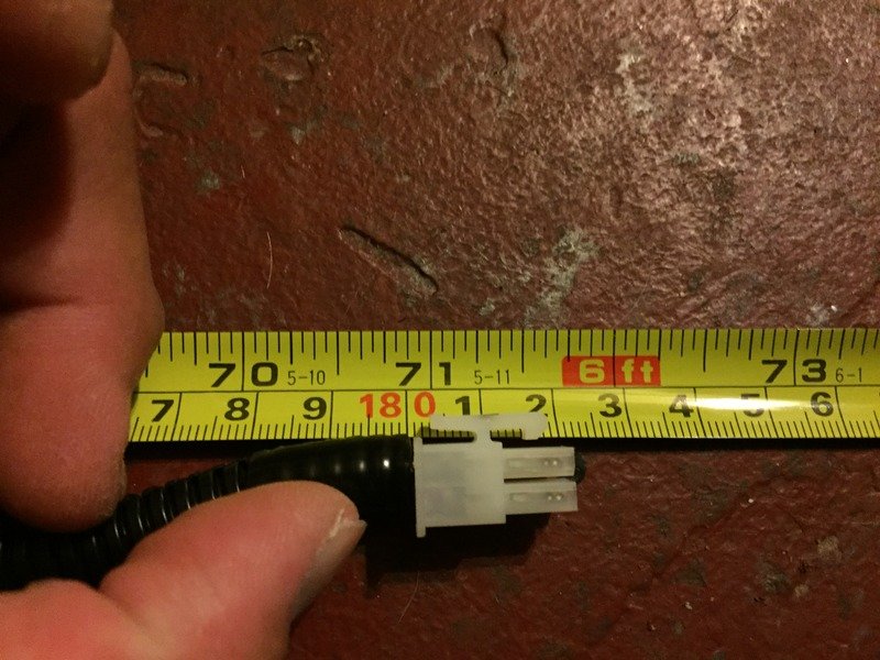

    @TacoSTIG sorry for the late reply.
    Lead from the switch panel.
    593D75BB-3EFD-4F26-B496-6B6FB88F56F3_zps_7bc4820fac18b41499ff45b11368c29bb43bc835.jpg
    Lead from the solid state panel.
    25E31FE6-7B0B-42CD-A83A-1A3B99CDD076_zps_70f52eb7ec85cf19f4dcab447527b0d6195429aa.jpg

    I think he meant the length of wire in between those connectors. the short end on the switch side.. and the longer length of wire on the controller side.

    Appreciate the shots, that answers what I was curious about. I was confused why mine was different but it makes sense they'd change that up, the latest version has a 6" lead off the switch panel and just about 10' off the solid state connector. Makes it easier to remove the switch panel without fishing out a bunch of wire if you'd ever need to do that.

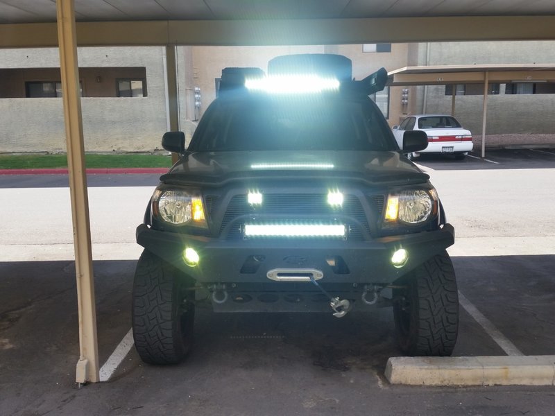

    Let there be more light................. Now I just hope my ditch light brackets from Cali Raised Lighting come in tomorrow. I'm ready to install to my Switch Pro. After this install, I still have 3 slots left.
    Switch 1, Piaa plate bumper lights, soon to be swapped out for s set of these led pods.
    Switch 2, 20 inch light bar
    Switch 3, 30 inch light bar
    Switch 4, Rock lights
    Switch 5, Ditch lights
    Switch 6, Whip, Future Install
    Switch 7, VACANT, Future Install
    Switch 8, ARB compressor. Future Install
    Switch Pro is just so damn simple to install accessories. I love it....

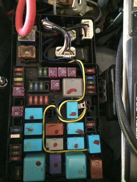

    Do you have any pics of where you tapped into the wires (blue and yellow)? Going to be hooking mine up soon, thanks.

    Here's where I connected mine for now:
    I tapped into the trailer relay for my "Fog Light Any Time" mod, and used the same connection for both the yellow and blue wire for the Switch-Pro. I thought the power would come on with the key in "Accessory" position, but it doesn't come on until "On" AND at least marker light turned on.
    It's not ideal for the blue wire (Acc), but a good accidental find for the yellow wire it seems. It works for me for now. I almost always drive with at least marker lights on, so I at least have dimmed backlight on in the SP, but no bright light / dimming.
    So if anyone have a good place to connect the yellow wire to an Acc switched source I'd appreciate it.
    I routed the blue and yellow light up from the bottom of the relay box where the big wiring bundles come up. If you do that, make sure to notch the divider wall - otherwise the divider wall will squeeze/notch the wires.

    I taped into my superchargers intercooler pump fuse. :cool: it already had an add a circuit.. So why not.

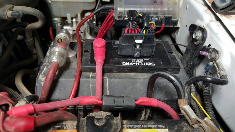

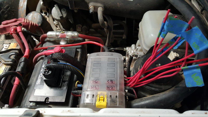

    Where'd you guys end up mounting the solid state panel?
    Just looking to get some ideas out there. Wanting it to look clean/stock form.
    aaen likes this.
  20. May 14, 2016 at 10:15 PM
    #520
    XPOTRPR
    XPOTRPR CNC Programmer/Machinist
    May 29, 2011
    #57449
    31,171
    Josh
    Chandler, AZ
    > BUILD LINKS >
    On top of my fuse box
