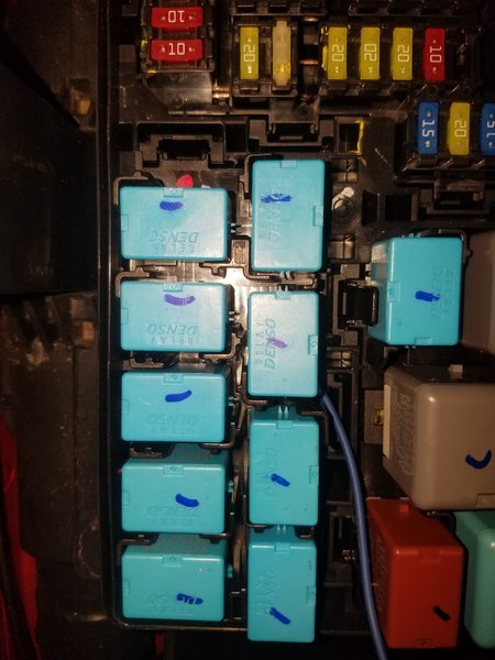

    Attempting to install right now but having a hell of time with the blue and yellow wires. Every wire I try to tap seems to have constant power as the switch panel back lights never turn off. Also don't have dimming ability so yellow wire must be in the wrong place too. Any guidance or help would be huge!

    I'm not familiar with 2016 taco. Your blue wire has to go to an ignition source. Inside your fuse box under the hood. The yellow wire I use my acc source inside my cab fuse box. Your yellow wire if you want it to dim with your lights has to be connected to your running lights accessory.
    On the older tacos second gen, the ignition source is the lite green wire inside the fuse box under the hood. The ignition source you use the ANY TIME FOGS ON MOD.
    I spliced into my FOGS ON ANYTIME MOD Wiring. Red wire spliced into the lite green wire. This is an ignition source.

    Thanks allot for the help fellas! Took a few more hours than I expected to get that done...:bananadead: I ended up routing the blue ignition source wire to the ignation 2-main relay. Everything thing else in there is hot all the time and the switch panel is always on. It's working great right now. Here's a pic of how I ran the wire. You won't hurt my feelings. I definitely open to suggestions or alternative methods.

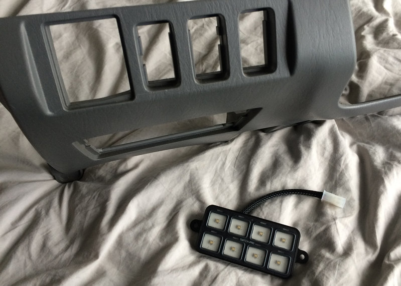

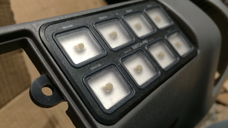

    Made some progress this evening
