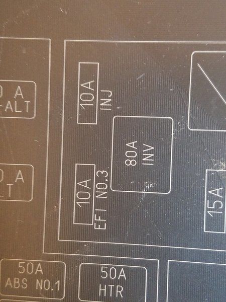

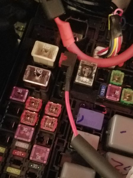

    https://www.tacomaworld.com/threads/lord-humongous-gigahorse-build.436524/

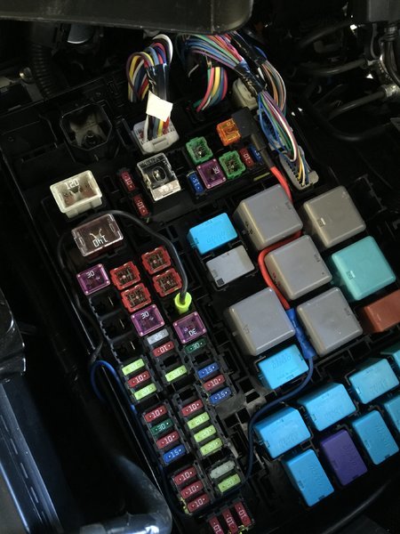

    Are you still using the A/C tap for your ignition sense? I messed with mine again today because I didn't like the blue wire being tapped directly into my ignition relay with no fuse. Seemed too hoopty for me lol:cookiemonster:
    I tried using a fused add a circuit to the A/C like you did but the switch was only on when the air conditioning was on lol. I suppose it would work since the switchpro can be programmed to work in ignition off mode but there was still no back lighting of the buttons when the air conditioner is off. I tried a few more taps then struck gold on the injector (INJ) 10 amp fuse. The switch pro turns on once the truck enters accessory mode and stays on through ignition and while the truck is running. It also turns off once the vehicle is shut down(including back lighting of button pad). :dancingbacon:
  10. Jun 6, 2016 at 3:19 PM
    #610
    hamiltonuh60
    hamiltonuh60 Well-Known Member
    Oct 21, 2015
    #167348
    347
    Texas
    2016 DCSB TRD OR 4WD
    Frontrunner, CVT RTT, Foxwing, Switch Pros, OGE, Fox, ADS, TC UCA, Dakar, Superbumps, U bolt flip, blah blah blah
    Yes those were the two best sources I found as well. The only thing I didn't like is that the injectors run when in accessory. I guess it might be better than the AC tho. The only reason I used the AC is that I always have it on, even during the winter when the heat is on I have AC on as well to reduce moisture. I might go back to the INJ fuse and try that this winter. Thanks for the pics!
    I didn't connect the yellow wire for backlighting since my control panel will never leave the glove box.

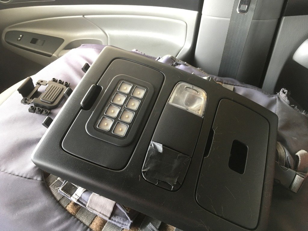

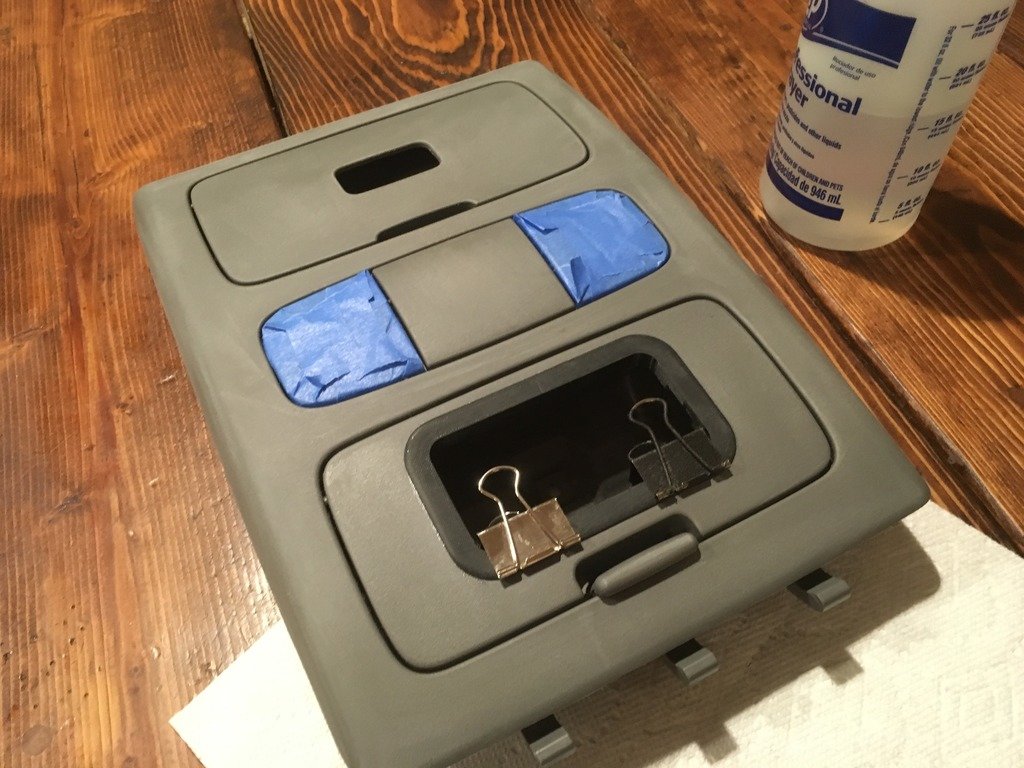

    so I got a >2011 overhead console from another TWer. The 2012+ overhead consoles have the push-to-open sunglass holders, and I didn't want it popping open when I pressed one of the buttons. I know some other TWers have installed switches in the overhead console before and not reported issues, but when I tested it to see exactly how much force it needed to trigger an open, it seemed pretty touchy to me. Better to just drop the $60, get a new console and do it right. Besides, my original console had a hole in it from my misguided microphone installation, so I needed a fix anyway.
    Get yourself one of XPOTRPR's bezels. Sand the HELL out of it - it'll take you a whole episode of Bob's Burgers to get it sanded down properly. I always overestimate how many blemishes paint will hide. Not much. Sand it way more than you think it needs. I was alternating between 60 and 100 grit, didn't bother with 220. Also gave a light rub to the rest of the console to try and promote paint adhesion.
    Dremel out a hole for the bezel (the template worked great!) and gorilla glue it in place:
    File%20Jun%2016%2011%2021%2016%20AM_zps6_21ef5f6903e7cc670a6db563812d9648dd0b8fdc.jpg
    Should probably be noted that the overhead sunglass holders are not *completely* flat - they're close, but there still is a bit of a curve from front to rear (not so much from side to side). You end up with either the front or the rear about 1/64" in the air. It's a very small gap, but if these bezels were ever going to be made specifically for the sunglass holders, a slight curve would be a welcome addition. As they are flat, superglue and a couple of binder clips overnight will bend to match the contour, and since it's going overhead, it's not really in a position for anybody to see anyway :)

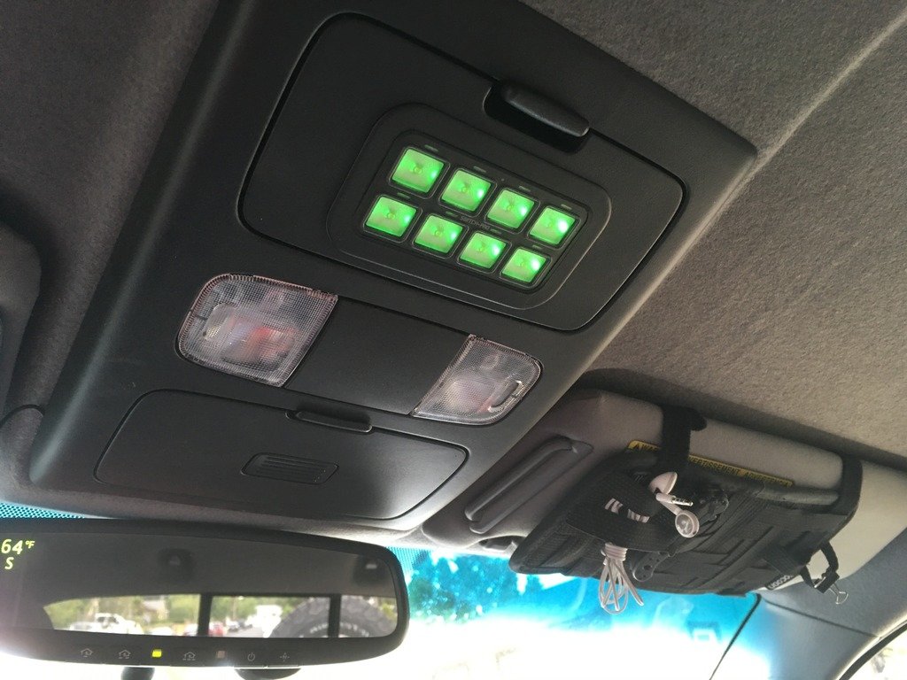

    I decided to hit the whole overhead with a couple coats of Rustoleum flat black. Snap in switch panel - those tolerances are TIGHT. It will go in, though, once you slide the corners in the proper order. That isht ain't goin' nowhere.
    File%20Jun%2016%2011%2016%2017%20AM_zpsy_2d2e483ae49c22e02f2379ca59c4ed824047c82e.jpg
    Run your cable up the driver's A-pillar & through the headliner. Drill a 5/8" hole in the hidden side of the sunglass holder to fit the connector through - 1/2" is just a hair too small. You could probably force it through, but it's hidden anyway, so a bigger hole doesn't matter. Reinstall the overhead & power up!
    File%20Jun%2016%2011%2015%2045%20AM_zpsi_030b6c4445945693a41f9ab89f7ce3b4497f1d35.jpg
    Now out to buy more accessories to use the rest of my switches.
