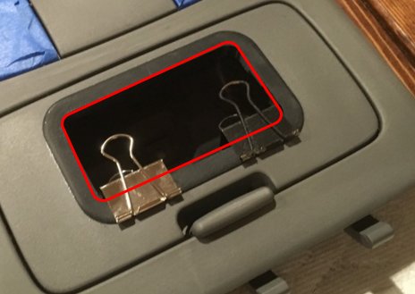

    Hey, those that sanded, what grit did you all use and by hand or not. Thinking of working on that some of this long weekend.
  15. Jun 28, 2016 at 10:08 AM
    #635
    XPOTRPR
    XPOTRPR CNC Programmer/Machinist
    May 29, 2011
    #57449
    31,174
    Josh
    Chandler, AZ
    > BUILD LINKS >
    IIRC.. I used a 600 by hand.. Primered, sand, primered, sand, paint. the material is relatively soft.. so any light grit will work.
    CO MTN Steve likes this.
  16. Jun 28, 2016 at 10:09 AM
    #636
    the dashing ham
    the dashing ham Taco n00b
    Oct 23, 2013
    #115085
    313
    Scotty
    Los Angeles
    '12 DCLB rattle can
    yes, I have done the mods
    I alternated between 60 and 100, using sanding sponges from Home Derpo. Sand it way more than you think you have to. Also round off the inside edge of the bezel, too. Tolerances are super tight; rounding off the inside edge will help you wiggle the switchpro in there once you have the bezel mounted.
    XPOTRPR likes this.
  17. Jun 28, 2016 at 10:10 AM
    #637
    CO MTN Steve
    CO MTN Steve Well-Known Member
    Jun 11, 2014
    #131742
    7,669
    Steve
    RaMbLiN' CoLoRaDo
    2015 Taco DCSB Blue
    Lifted, Armored, needs more lights.
    Not sure I am following which inside edge you are referring too?
  18. Jun 28, 2016 at 10:15 AM
    #638
    XPOTRPR
    May 29, 2011
    #57449
    31,174
    Josh
    Chandler, AZ
    > BUILD LINKS >
    I made those tolerances tight for capture reasons.. it should specifically shave off some material as it goes in.. that way you know its tight.
    the inside edge that the switch pro pops into.
    CO MTN Steve[QUOTED] likes this.
  19. Jun 28, 2016 at 10:18 AM
    #639
    the dashing ham
    Oct 23, 2013
    #115085
    313
    Scotty
    Los Angeles
    '12 DCLB rattle can
    this inside edge. Once I had the bezel glued in to my console, it was even tighter than when I was test-fitting it loose. Which is awesome! It's a wonderfully precise piece. I just didn't want to force it toooooo hard in there, I've done that before on other projects and broken things. So I rounded off that inside edge a little to help it wiggle in.
