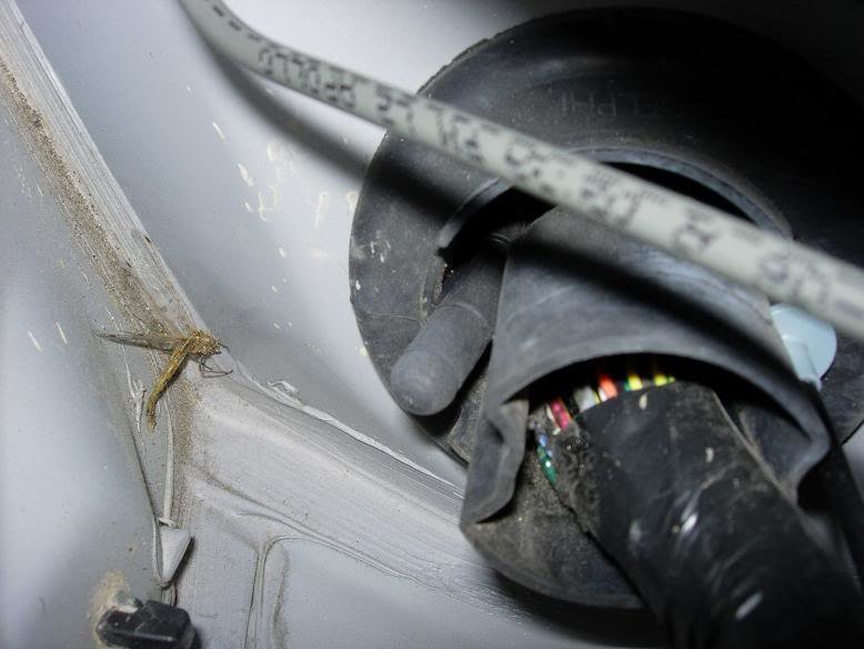

    That firewall boot, did you have to put a hole in it or is there room to force the wire through with the existing wires...mine looks really tight and i have been battling with poking a hole or not

    I wouldn't try and force anything through right alongside the existing factory wires - most people push them through a gap kind of on the left side of the boot (not my image):
    You can cut that nipple on the left side and have enough room to get your stuff through. It's slightly more complicated for the switchpro unit, as there's already a connector on the end, which makes it more difficult than pushing bare wire through that grommet.
    I came up with this weird technique for the switchpro plug:
    Wrap the entire connector up in some manner of tape - masking or packing tape so it's easily removable. Cover the whole plug on the end so you're not trying to push a jaggy square plug with lots of corners through the firewall boot. Pro tip: straighten out a coathanger and tape it onto the plug, too, so that it's at the end of a long, firm stick.
    Break out the longest needlenose pliers you can find and push them through the boot, while closed, from the interior. Doesn't have to be fully penetrating. Push the end of the plug up into the boot - it won't go far, you just want it sitting there. Open the pliers slowly and you'll make a gap in the boot. Doesn't need to be much. Grab the end of your taped up connector with the needlenoses and pull them through to the inside.
    Let us know how it goes!

    Thats what I did too. Long screwdriver, electrical tape the shit out of the Switchpro plug to the tip of the screwdriver.. And shoved it through. Giggity.
