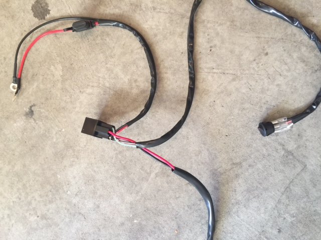

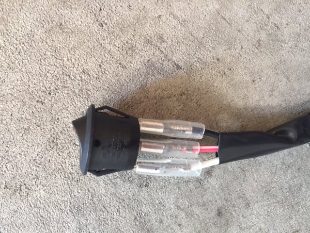

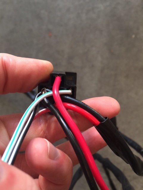

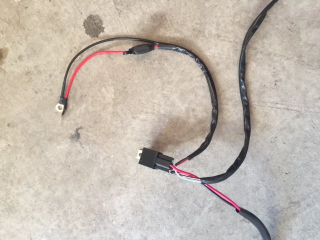

    So here is where I am confused. As you can see from the picture, the relay has 3 sets of wires coming out of it. One set that lead to the light bar connection, one set leading to battery connection with an in-line fuse, and the the third set leading to the switch. The switch has 3 wires included in it, and the the set leading to the battery has 2 wires. What would I run to the Switch Pro, and what would I cut/eliminate?

    So those three wires plugged into the switch are 12v in, ground in, and 12v signal out. That is, power and ground are delivered to the switch, and when the switch is set to "on," it delivers 12v power out along the signal wire.
    Since your switchpro is replacing the Cali Raised switch, what you want to do is connect one of the red wires coming out of the switchpro to the signal wire coming out of the Cali Raised switch. The power and ground wires going in to the switch you can tape off and disregard. You just have to figure which one of those wires is the 12v signal coming out of the switch.
    My guess is that white wire coming out of the switch will probably be the signal wire, but to be sure, you'd have to refer either to Cali Raised instructions, or perhaps call or email them to ask. The switch and relay might have markings on them. If you have a multimeter or can borrow one, you can just plug the whole harness in, hook it up to your battery, and touch the multimeter to those contacts and see which one delivers 12v out when the switch is set to "on."

    I understand what you are saying, but my only problem with that is that the bar requires a 30amp fuse to run. SP is maxed out at 18amps per circuit. The inline fuse on the wiring harness in on the two wires that are supposed to go to the battery.
    My initial though was to cut and tape the switch wires, and run the red wire from the SP to the positive wire with the inline fuse, and then ground the ground wire. Sorry for the confusion, just not sure how to proceed.
