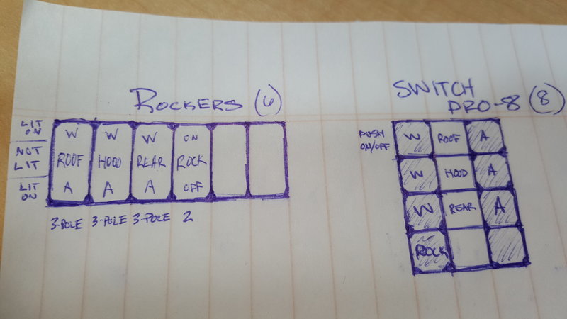

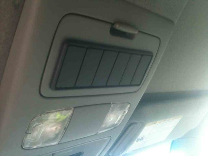

    I'm still torn between a 6 switch panel with rockers, or a switchpro.. It doesnt help that I'm trying to do something different with my lighting..
    need some input guys..
    If I go with the standard 6 switch rocker setup:
    Half of my lighting will require 3 pole switches (on/off/on). The problem is, getting those 3 position switches wired up to work as you would want them to (with the center description lit up all the time and then the switched to accessory lit up) you need twice as many relays and even then its a partial solution. This will leave me with 3 open slots after the 3 pole lighting is done. I can use regular 2 pole switches for the remainders and they will work as they should. one will be taken up by rock lights, so then there's two open spots left.
    If I go with a SwitchPro-8:
    I will have 2 more switches, but can use them all as intended. all lights will work, etc, but have to use one switch each for the 3 pole lights, which means I will have 1 open slot after my rock lights. its smaller, has more switches allowing me to use it how it should, easy to use, mounts anywhere.
    price is going to be about the same.. Switchpro just a little more.
    rough idea..
    so either like this.. (with switches, the first 3 being 3 pole)
    or this..
    mounted in the sunglasses holder or in the center console.

    ordered mine over the weekend. cant wait to start the new lighting!
    once I receive mine.. I will see about designing and 3D printing a bezel to flush mount it.
